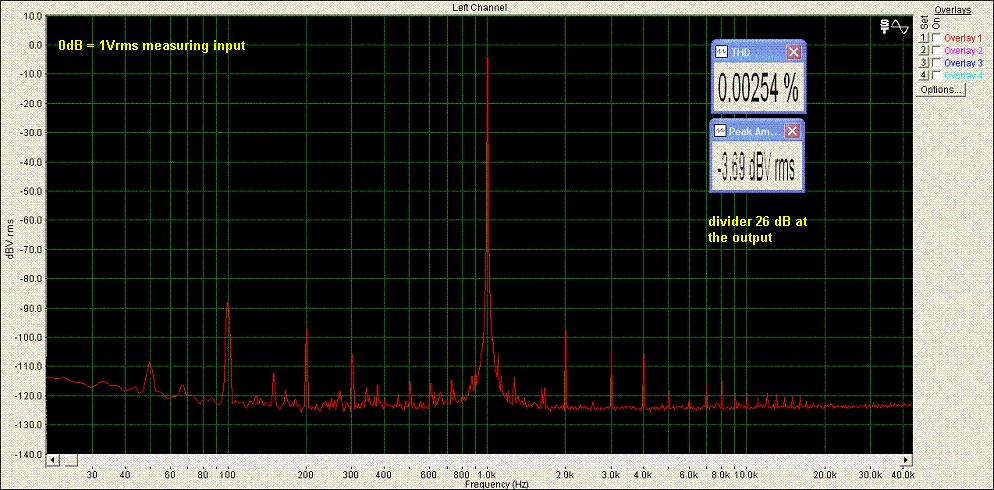

Hi Bob,
I had the amp in my workshop for no more than 2 hours, so the number of records collected would be limited.
The amp gave 180W into 4 ohms. The output voltage swing with 4 ohms load quite same as without load.
I monitored the whole range of output amplitudes, starting at some 1V. At about 18Vp, the step response shape, that
was RC-like for voltages less or equal 18Vp, started to be slew-rate limited and started to exhibit the behaviour described earlier.
Yes, the observations were similar for no load.
SR measured was 28V/us. The amp was almost unstable to 3.3uF, but handled 390nF with damped oscillations.
I do not know THD 20, I am enclosing THD 1, which was almost same for all power levels and almost copied distortion of my workshop audio generator.
There was an input filter 1k + 100pF (100ns tau), which was insufficient for this amp.
SIMULATION RESULT
The colleague had the amp simulated in MC in his notebook. I played with simulation some 10 minutes and found quite same step responses as measured by oscilloscope. I played a bit with compensations (in sim only) and removed overshoots and increased SR to 58V/us (in sim). The simulated SR with original compensation was same as measured, 28V/us.
Even with modified compensations, the step response was not a smooth function. Overhoot was suppressed and SR increased to 58V/us.
The topology of the amp was unusual, combination of CFB and VFB. Three stages, differential VAS with 1 half cascoded, VAS buffer and 2EF output stage.
Pavel
