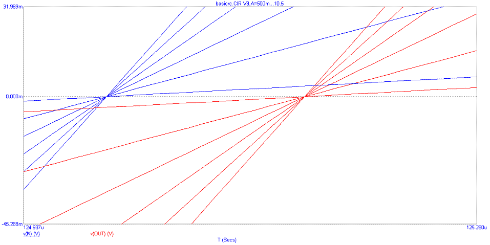

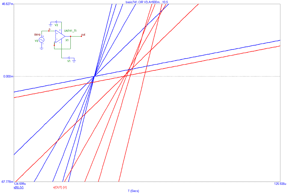

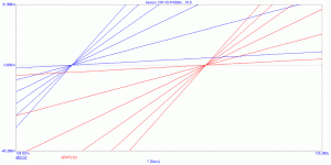

Phase shift (angle) as a function of input voltage amplitude:

PMA, note that we must be careful about how we use the word "non-linear" in regard to phase shift.
If the phase shift is nonlinear as a function of frequency, this a form of time delay distortion that does not cause new harmonics or IM products to be formed. It can result from a conventional linear passive circuit.
Note also that a small amount of phase shift from an LPF pole or two is a fairly good approximation to a fixed time delay at frequencies well below the pole frequency.
Finally, when phase shift is a function of signal amplitude, this is classic non-linear distortion that will result in the production of IM products. This is what has been called "Phase Intermodulation distortion" (PIM). It will produce IM sidebands in the CCIF IM tests, but the phase relationship between the upper and lower IM sidebands will be different than for a similar amount of Amplitude Intermodulation Distortion" (AIM).
