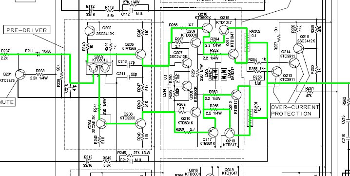

I saw this, and it's new to me. There's no CCS to power differential pair and VAS. Q204 and Q206 are current mirror with gain. The standing current is defined by 33k resistor.
R240 and R244 also terminated before the power rail.
What is the advantage of this arrangement?
Looks like 1 less transistor advantage. Maybe somebody
trying to be novel - notice how odd the schematic is drawn.
lumanauw said:I saw this, and it's new to me. There's no CCS to power differential pair and VAS. Q204 and Q206 are current mirror with gain. The standing current is defined by 33k resistor.
It looks like the common-mode voltage of the input differential pair is being deliberately allowed to slightly modulate the VAS current source. Why, I don't know. Looks like he was drunk when he drew the output stage 🙂.
Bob
Looks like it. To get more harmonic distortion?It looks like the common-mode voltage of the input differential pair is being deliberately allowed to slightly modulate the VAS current source.
