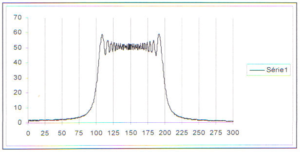

To B. Cordell
Here is the spectrum of the impulse I mentionned to you a few posts above.
This impulse is a linear swept sine from 100hz to 200 hz in 1 second.
You can see that this signal has a selective spectrum. If a system is excited with this impulse and if the amplitude is increased, we can analyze the spectrum of the output outside the band and get there components generated by non linearities in a transient way.
The ratio of out of band energy to in band or total input energy is a figure that is perhaps better correlated to aural impression than THD.
What do you think?
JPV
What do you think?
JPV
