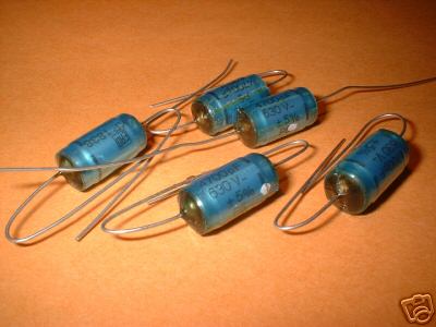

Why I have used ceramics?
Really not always.
I have a package of polypropylene AXIAL small:
ERO KP1838, 2.5%, 630V -
They range from 100pF, 220pF to 4700pF.
I bought it on SALE, from a surplus .... some do not know what they sell out!!!
See attachment picture.
But, although two 100pF in series make one 50 pF,
I still use ceramics NP0 for lower values.
Like for example 22pF for compensate NE5534, for gains below x5.
If using ceramics, I think NP0 is the best I can get.

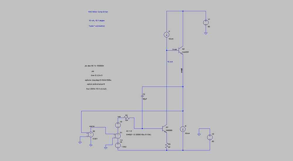

Miller compensation connection
This post addresses a question that Glen raised over in the Error Correction thread. Since the issue is Miller feedback compensation, it is more appropriate to address it here in this thread.
The discussion concerned the question of picking off the Miller compensation feedback capacitor connection from the high-impedance VAS collector as opposed to from the following emitter follower pre-driver. The former is the way it is usually done. In some cases, there are benefits to picking it off after the buffering so that the Miller capacitance or network does not load the high impedance VAS node. One example is where we use T compensation, where the first capacitor usually wants to be larger than the second capacitor and the shunt resistor can impose a significant load on the VAS collector circuit. The “outer” pick-off point can also be advantageous in TMC arrangements as well.
I had asserted that picking off the compensation after the pre-driver emitter follower was just as good as picking it off directly from the high-impedance VAS collector, both from a frequency response point of view and from a distortion point of view. Although the behavior of the two stages is not identical, it is largely the same because the voltage at the pick-off end of the Miller capacitor is essentially the same in both cases, since the pre-driver EF has a gain of essentially unity.
Glen asserted that it is bad to pick off after the pre-driver EF because that takes away the shunt feedback effect of the Miller capacitor on the high-impedance VAS collector node. That desirable action reduces the output impedance of the VAS collector node, making it less vulnerable to the nonlinear capacitance effects of the collector-base capacitance of the pre-driver transistor. He asserts that distortion will increase when the capacitor is connected on the “outside” to the emitter of the pre-driver EF because the VAS collector node is left in a high-impedance state. It is easy to see how this would seem to be intuitively correct, but it is not. This is why it is sometimes very important to do sanity checks on our intuition.
Glen also seemed to imply that the outer connection of the Miller capacitor foregoes the effects of pole-splitting that we enjoy with the conventional “inner” miller compensation connection. In fact, simulation shows that the frequency response of the combined VAS and pre-driver stage is essentially the same for both connections.
Forgive me, Glen, if I have mis-stated your position.
The simulation was done with two transistors, a 2N5550 acting as the VAS and biased at 10 mA with a 22 ohm emitter resistor, and an MJE243 acting as the pre-driver emitter follower, also biased at 10 mA. A 30 pF Miller compensation capacitor was used in both connections. The base of the VAS stage was driven from a 10k signal source. The arrangement was biased from +/- 50V rails and operated at 49 V p-p at 20 kHz. THD-20 distortion percentages were as follows for the inner and outer connections (note that this is essentially distortion of the arrangement absent any global negative feedback):
Distortion Inner Outer
THD-20:_ 0.411_____ 0.411
2_______ 0.412_____ 0.411
3_______ 0.03______ 0.03
4_______ 0.00255___ 0.0027
5_______ 0.00055___ 0.00055
6_______ 0.000069__ 0.000078
7_______ 0.000020__ 0.000020
The behavior of the two different connections is remarkably similar.
Bob
Re: Miller compensation connection
You've done a very good job of mis-stating my position in just about every possible aspect.
I did not say that picking off the miller compensation capacitor from the first emitter follower (or driver in a double EF OPS) was a "bad idea", nor did I imply that there were no benefits to be had (eg > slew rate) with the connection.
I said that in the moving the miller comp connection from the VAS collector doesn't always result in lower THD. In a lot of cases it is lower. In some cases there is hardly any difference and in some cases it can be signifcantly higher.
I demonstrated this fact by providing a simulation for everybody to see of a design in which the connection yielded significantly higher THD-20.
I've had similar results from applying TMC to such designs and so had Edmond. Maybe you could ask him for more design examples.
In these examples you can ignore what we have found and assert that "from a distortion point of view" the performance is just as good if you wan't, but it demonstratably is not.
Glen also seemed to imply that the outer connection of the Miller capacitor foregoes the effects of pole-splitting that we enjoy with the conventional “inner” miller compensation connection. In fact, simulation shows that the frequency response of the combined VAS and pre-driver stage is essentially the same for both connections.[/B]
Nope. I asserted that the combined open loop frequency response characteristics of the stages enclosed within the miller loop are much less venerable to the non-linear input capacitance of the first EF with the miller cap connected to the VAS collector. That is a demonstratable fact. The miller capacitance is then effectively the dominant capacitive load on the VAS collector.
I offered this as a further elaboration of the circuit operation further to Edmonds postulation that the significantly higher THD sometimes yielded by the EF miller compensation connection may be have something to do with the cancellation effects of distortion products.
Exactly how much of a role the open loop frequency response variation caused by (VASgm * the non-linear EF load capacitance) plays in the higher THD yielded in some specific design cases by the "outer" miller cap connection, I don't know, and it seems that neither do you.
Glen

Hi Glen,
I'm sorry if I mis-stated your position. I am therefore a bit puzzled by the fact that you referred to my stated position as "nonsense". That was rude. Nobody likes to have their words characterized as nonsense, especially if the disagreement is subtle or semantical. Your statements and mine in the other thread speak for themselves. I think that your statements showed that you were being misled by your intuition, but I could be wrong. That sometimes happens to me as well. Its nothing to be defensive about.
It sounds like we are in agreement with the following two points:
There is usually no performance or behavioral penalty for using the "outside" connection for the Miller capacitor. Pole-splitting behavior is essentially the same. Open-loop distortion of the pair, with the inside connection or the outside connection is essentially the same.
In many circuits there is no distortion advantage to doing so.
I never implied that I was employing that connection to achieve lower distortion by enclosing the pre-driver EF in the Miller loop, as you know. However, I did say that in some cases it was desirable to not load the VAS collector with the compensation network.
Are you are referring to the "simulation" you showed in your last post on the subject where you accompanied the drawing with a question rather than results? That did not seem to prove anything insofar as the question at hand.
Bob

Re: Re: Re: Miller compensation connection
There is a degree of irony with that complaint coming from you.
Bob Cordell said:
I never implied that I was employing that connection to achieve lower distortion by enclosing the pre-driver EF in the Miller loop, as you know. .[/B]
I never said that you did. Why do you keep defending yourself against a non existant accusation?
Bob Cordell said:
Are you are referring to the "simulation" you showed in your last post on the subject where you accompanied the drawing with a question rather than results? That did not seem to prove anything insofar as the question at hand.[/B]
As clearly stated with the post number and even a direct hyper-link provided (to avoid confusion 🙄 ), in my last post I was referring to the simulation in which the THD-20 is shown to increase ~10% with the "outer" cap connection.
As for your dismissal of the drawing with the accompanying (ignored) question in the other thread, am I supposed to take that as seriously as your claim that you don't actually know which "simulation" I was referring to in my post above?
Am I wasting my time in this discussion for any good reason?
Glen

10% difference? yes, I'd say our time is being wasted
given the real occurrence of cancellations of individual terms in an overall amp's nonlinearity by very specific and difficult to predict/design for relations between device nonlinearity/bias/gain/feedback distribution(across stages from local degen, Miller to TMC to global) 10% difference in THD isn't significant as a test of how/where to best apply negative feedback
in my opinion negative feedback principles are best illustrated by applying it for order(s) of magnitude distortion reductions

Gently trying to correct you on anything is a complete waste of time. The fact remains that the string of posts clearly shows that your intuition was leading you astray and that a proper simulation showed the correct interpretation. I never tried to rub your nose in it, but you just cannot leave well enough alone. You are a very smart guy and contribute a lot of good stuff, but your contrarian nit-picking is truly tiresome.
Bob
