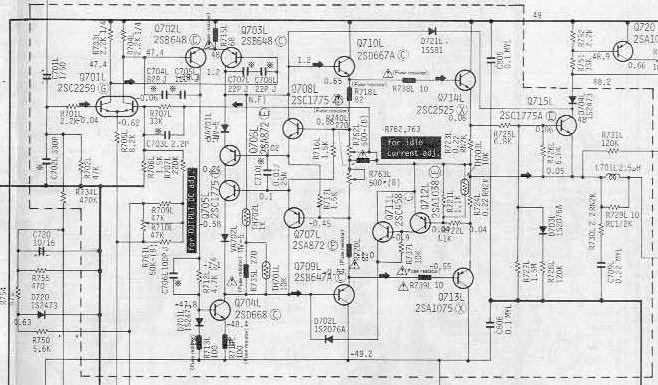

what is this?
The bias scheme is strange, Q705,706,707,708, and have connection with output node.

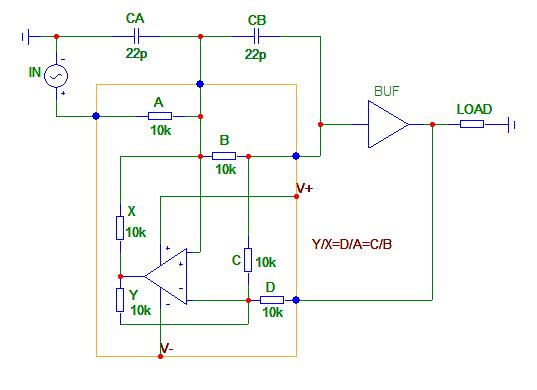

Hawksford Error Correction with OpAmp
Regarding the proposal to develop an Error Correction IC:
I don't think that this is necessary. Just find a good high speed opamp and use it like in the attached schematic. I have built it with an AD8610 and it works fine without any adjustment, using 1% resistors. CA and CB are needed for stability. You can chose other resistor values; as long as Y/X=D/A=C/B, both voltage error (including DC offset) and nonlinear input current of the buffer stage are corrected, as described by Hawksford. The opamp supply is taken from the buffer's supply lines after bootstrapping to the output and limiting to +-12V.
You must drive this circuit with a low impedance , e.g. a VAS with its own NFB loop.
And my take on the fierce debate whether EC is NFB: Whoever has developed his own EC circuit (there are many ways to do it, always using positive feedback in some way) and turned the magic nulling knob (in reality or in a simulation), knows what it is.
Gerhard

Re: Hawksford Error Correction with OpAmp
I don't think that this is necessary. Just find a good high speed opamp and use it like in the attached schematic. .....
Gerhard:
I beg to disagree. Not that it cannot be done, I simulated and built an EC amplifier based on an OpAmp front end 2 years back with excellent results. The catch is results as per simulations at least are not better in an EC configuration than in a GNF configuration where the loop is closed including the power stage. This is basically no surprise and I bu¡lt the amplifier specifically whith the purpose of testing EC.
The only point to check is whether stability can be tamed the same way as with EC - which I did in hardware - in the case of normal GNF. This I have not verified in practice.
But a discrete or special purpose front end processor may conceivably perform even better, provided its design focuses on inherent linearity and large bandwidth. This remains to be developed and tested.
Rodolfo

Rodolfo,
with what exactly do you disagree?
Maybe you misinterpreted my message. I was not talking about an opamp front end, but about using an opamp for implementing Hawksford stile error correction. My front end is a standard VAS with JFET differential input and its own NFB loop. By using a very linear NMOS output stage with high local NFB and the addition of EC the distortion is very low (even THD20).
But you may be right: I am not convinced that EC is the easiest way for getting ultra-low distortion (if this is needed at all).
Gerhard

Gerhard,
Even if you use and OpAmp for the EC loop only, the result is essentially the same as that having the OpAmp with no feedback (i.e. providing its raw OL gain) somewhere along the negative feedback loop. That being the case, there is basically no advantage except for - and this I don't know and have not tested - stabilization issues.
The real difference lies in the alternate approach with an error correction engine specifically designed for the task. So there is where I disagreeded with you, when you said no special discrete or integrated circuit was required.
Let me stress again that I did build prototype and preproduction modules using and OpAmp as EC engine and that it works very well, only it does not fully exploit the possibilities afforded by the topology.
Rodolfo
