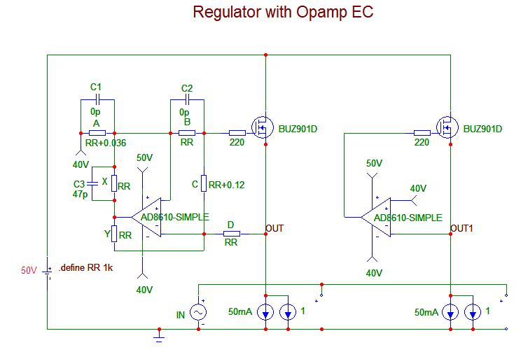

gwolf said:
..... there is no outer negative feedback loop and the EC amplifier is B, not S .....
What is your stability analysis for this case? ....
Gerhard
Gerhard
In fact there is an outer negative feedback loop from amplifier output through EC amplifier B inverting input to main amplifier input. The positive feedback loop is formed by the B noninverting amplifier input to main amplifier input, and the cancellation condition is as you stated gm=1/R.
Now, it is simpler from the standpoint of stability and performance evaluation, to convert to the equivalent single negative feedback loop configuration, provided you replace B with a convenient first order network model (otherwise you will stumble with a division by 0).
Including the cancellation condition, B and the inner positive feedback loop are replaced with an ideal integrator with the same gain-bandwidth product the original EC amplifier had.
With this in sight, it follows:
1. Stability should in principle not be worst than simply leaving B as an auxiliary inverting loop amplifier (no inner PFB) operating itself open loop (no local NFB). This I have not checked.
2. There is then no particular correction advantage form the EC configuration to the previously indicated single loop NFB.
I reckon that your particular configuration with a transconductance amplifier driving current to the VAS output R probably requires modificatons to convert to the regular single NFB loop, and that in this case it may be advantageous to leave it as is.

ingrast said:
Gerhard
Thanks, Rodolfo, now things start becoming interesting. I must think about it.
In the meantime I remember a simulation exercise I did some time ago about applying EC to a regulator. Reducing the output impedance of the regulator to near 0 (thats what EC does) should result in a very high load regulation factor. But when I compared this with an active NFB scheme, the results were not so different (see attachments). Reminds me about what you wrote...
Second attachment will follow.
Gerhard

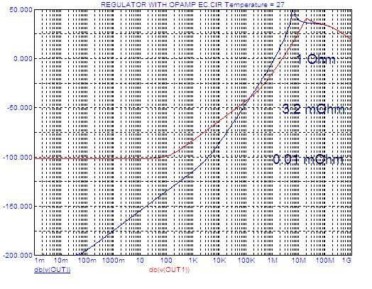

gwolf said:Here is the second part...
Note that this is only AC (small signal) analysis. Large signal behaviour will be affected by non-linearities of opamp and FET, but probably less so in the NFB version.
Gerhard
