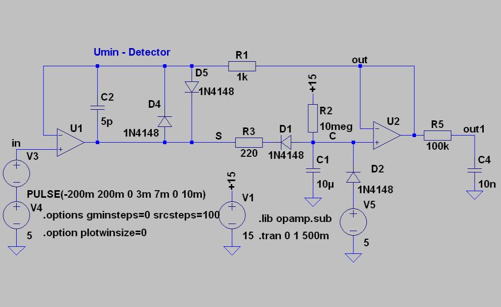

Re: Controlled clipping of EC amplifiers
Hhmm....no answer..anyway it would be better not to use a deep frequency filter, may be better this?
Heinz!
andy_c said:
Hi Bob,
While we're on the subject of clipping, I have a quick question.
With an EC amp, it seems advantageous to have a regulated, boosted supply for the input stage, VAS and drivers while running only the output stage from the unregulated supply. It would be good to always have the highest clipping voltage possible without overdriving the output stage (possible when the earlier stages run off a boosted voltage). This seems to imply that the reference voltage for the Baker clamp used by the VAS should track variations in the unregulated supply.
I have heard that your "Klever Klipper" input clipper for gainclones has a clipping level that tracks the unregulated supply, yet suppresses the modulation of the clipping level by the power supply ripple. This seems to imply a low-pass filter between the unregulated supply rails and reference voltage for the clipper.
So my question is, "What is the time constant (if any) of the filter that tracks the PSU variations to establish the clipping level of the Klever Klipper?".
Heinz!
