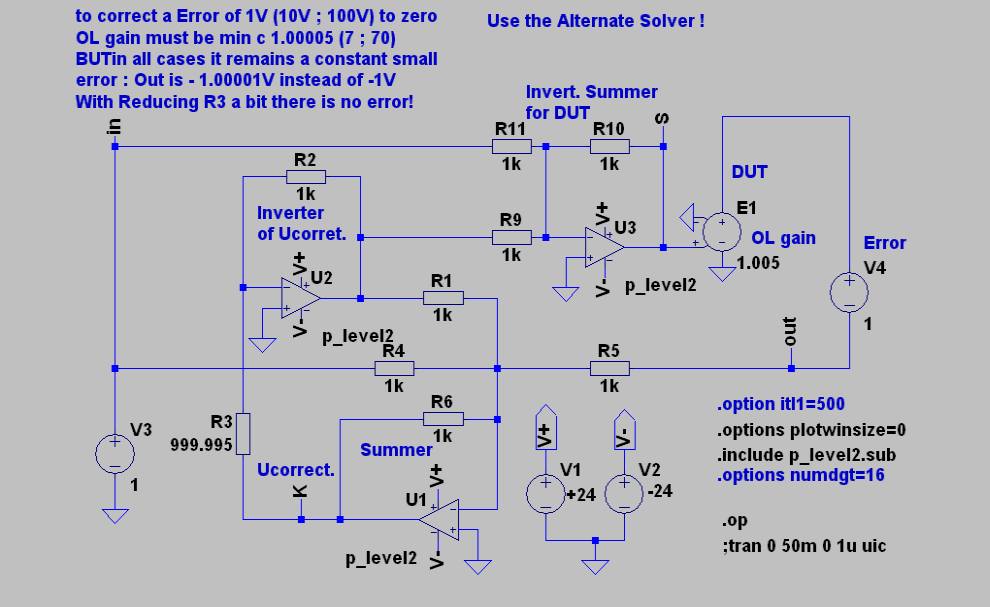

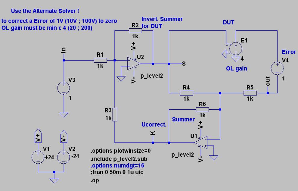

Hello,
before some days I try to do some EC experiments.
For start I tested 2 different schematics to got a "feeling" for feedback EC ( I call simple so for myself, so can I better distinguish it from feedforward EC).
I use only inverting amps for the summers, because they have for this purpose the smallest error...as models ..and in reality!
I like to know how much gain for a given error is needed in the stage which should be corrected. For this I try sch. EC1 versus EC2.
Regards
Regards
Heinz!
Now EC2, here is interesting, that I had to reduce R3 a bit to get in all cases also 0 error.
May be the reason will be explained from a person which know better mathematics than I!
I "like" this schematic more than EC1, because I can better "see" the positive FB through R1...without it works only with NFB.

For more practical tests I create a simple poweramp. I take it from the examples and added a bootstrap C and use complementary EF´s. With a inv. gain of 10 THD 20 was 0.039%.
After that I put it in a simple opamp symbol and try to reduce thd with both EC schematics.
Also I use the amp openloop with EC and find there is no real difference!
The improvement was quite remarkable: THD 20 drops down to 0.00042% without affecting to stability.
At last I tried a bridge connection, each amp with it´s own EC...
THD20 goes further down to 0.00019% !
I don´t have expected this good results, especially when I look at the BOM!
For further experiments I put all circuits in the attachment.
Regards
Heinz!
