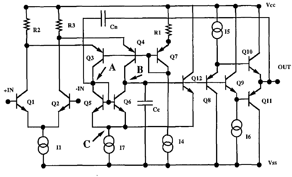

The AD797 uses EC in the output stage, capacitively coupled. They do not mention error correction at all, and claim to a "discovery" (and patent of course).

ingrast said:The AD797 uses EC in the output stage....
Where? How?

mikeks said:
Where? How?
Look in the AD797 datasheet the explanation of output stage correction (Cn=Cc) and simplified fig. 32.
Rodolfo
