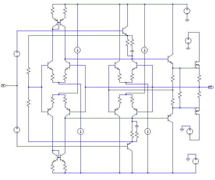

Since decreasing the EC loop's sensitivity to misalignment in the summers requires K4>>1, as established here, it has occurred to me that the desired increase in K4's gain may well be implemented by simple diff. amps, as roughly shown below.
Thoughts and suggestions anyone?
Continuing from here.

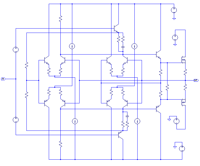

Actually, comparing this concept with the models here and here, it would appear i have assigned incorrect polarity to the "desensitizing'' cell.
Corrected arrangement below:
Well, why stop now? 😉
Since the value of |K4| becomes irrelevant at balance, then we might as well load the "desensitizing'' cells with current mirrors to ensure |K4|>>1.
Thoughts anyone?
Thoughts anyone?
