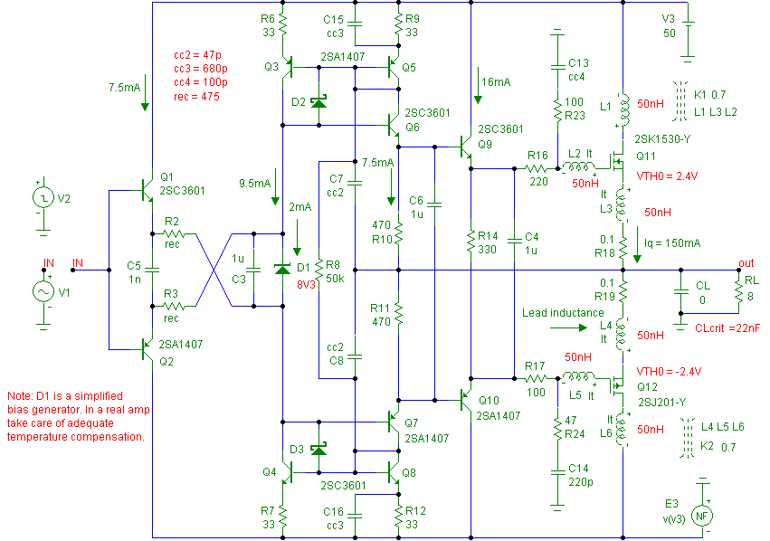

Hi Forr,
Perhaps I was a bit cryptic, but I'm only trying to say that if you move the input of the output stage from X to Y, you get essentially the same topology as I have dropped here last year. For convenience, I'll put it here again. The only difference is that two functions, emitter follower and current conveyor, are combined in only one transistor pair: Q6/Q7. This works fine as long as the base currents of the next stage are small WRT the feedback currents through R10/R11.
BTW, don't build this circuit as there are better or simpler ways to lower distortion. This thing was only meant as an example how to circumvent the need for a the large bias voltage (22V) and boosted power supply for the front-end as in HEC.
Edmond.

Re: EC
Edmond Stuart said:
Hi Forr,
Now, connect the non-inverting input of the output stage to node Y, instead of X. See what I mean?
Edmond.
Yes that will certainly work, but it takes that input buffer/ current conveyor outside the ec loop. The nice thing about Forr's idea was that it also corected errors of that input stage.
