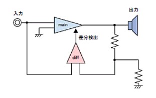

Re: ODNF in plain old English...
Hmmm, I was in a hurry and just gave that link without actually trying to read the content carefully. Often automatic translations still provide enough information to get at least have a clue what it is all about, even from Japanese or Chinese pages. This particular line of text is a real challenge, especially the money part. So, I tried another machine (for this line only). Just for fun, with my apologies for being off-topic.
Google Translate:
Negation strain in the best state vice-amp current drain is minimized signal components should be measured in this circuit, so print money, VR1 strain adjustment of the minimum rate set point.
Babel Fish / Systran:
In optimum strain hitting turning off state it is the expectation where the signal component of drain electric current of the secondary amplifier becomes smallest, but in this circuit it will measure, but because it is not, the adjustment of VR1 set to the smallest point of distortion factor.
I think Babel Fish and Systran (both give the same translation) do a better job than Google Translate in this context. At least the money is gone.
I believe this site does indeed describe the ODNF from Luxman. I have great respect for Mr Shinichi Kamijo, a very innovative amplifier designer.
Steven
Edmond Stuart said:
Thanks Steven.
BTW, is this what you mean by "plain old English":
Negation strain in the best state vice-amp current drain is minimized signal components should be measured in this circuit, so print money... ?
Must be very "old" English 🙂
Anyhow, do you really think this link has something to do with the Luxman version of ODNF. As far as I can see, it uses a local NFB loop from the output and a traditional global NFB loop (see the last schematic).
Edmond.

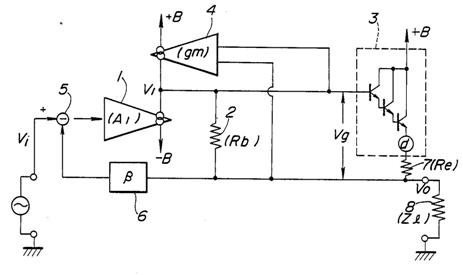

Re: Re: ODNF in plain old English...
Hi Steven,
First, thanks for the links for a better translation.
But still I have a problem: according to the Luxman brochure, no global NFB is applied (see also the picture below), while your link describes two amplifiers, both with global NFB.
Also patent #4785257 (courtesy of David) was of little help, as this one is unstable or in an attempt to make it stable, The EC mechanism gets ineffective.
So, for a better understanding of ODNF and to make a fair judgment about the merits of the Luxman B1000f, we need a complete schematic.
Does anyone have one? Please enlighten us.
Edmond.

Re: Re: Re: ODNF in plain old English...
For this to be error correction Rb needs to be in series with the base emitter voltage error rather than across it as implemented in the patent. As it is the gm stage is just bootstrapping Rb which effectively makes the impedance since by A1 much higher and hence the gain is higher and feedback factor is greater thus reducing distortion. But still no error correction and also the possibility of instability.
