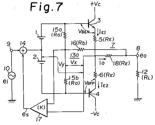

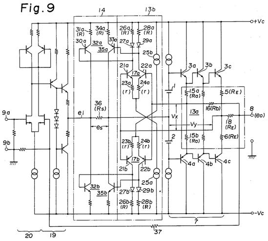

Hello
I'm not sure if this has been covered but Patent # 4476442 describes an error correction output stage that uses complimentary differential pairs. I believe this configuration was commercially used in the Yamaha M70 power amplifier.
snoopy said:
Hello
Yep, inasmuch as 'K' in the figure is supposed to be '1' (and it is), this appears to be yet another Hawksford ec implementation. What is interesting is the timing: the patent was granted in 1984, Hawksford wrote his paper in 1981.
The earliest article about this configuration I found was from 1973 though.
L'histoire se répète...

To elaborate here is the guts of it from the patent. Although it does error correction it obviously was granted the patent because it achieves it in a different way to the Hawksford circuit.
