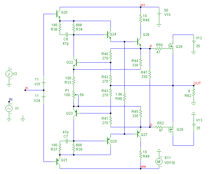

Hi Bob,
So the multiplication of the Vbe-TC depends heavily on the Vgs bias voltage as well. I think not all of us really like that. Therefore, I took the freedom (if you don't mind) to modify your circuit slightly (see below, R44/45). As a result, the TC multiplication factor is more constant: between 2.1 and 2.5, instead of proportional to the bias voltage.
At a bias voltage V(P,Q)=7.88V, this factor is 2.43, while your original circuit 'measured' 3.66 (of course at the same V-bias).
Admittedly, a factor of 2.43 is probably still too high to mount both sensing trannies on the heat sink, but the modification clearly shows that there are ways to individually tailor the bias voltage and the temperature coefficient.

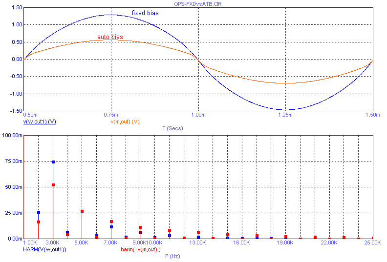

Hi Simplex,
While I agree with you that a simple Vbe multiplier does a fairly good job (see also my posts 3289 and 3297), I don't see an automatic bias circuit as a dead end (if that is what you are saying). Although it might not economic viable, I still think it's feasible and see it as a challenge to design a circuit that does not impair the THD figures in any way. Furthermore, this is DIY, so I don't care if it will cost a bit more than a simple Vbe multiplier.
The problem with most auto bias circuits is that they modulate the bias voltage in such a way that the distortion will increase. Why this is becomes clear if we look at the voltage difference between input and output of the output stage. In my example comprising vertical MOSFETs. (BTW, the input voltage is defined as the mean value of the two gate voltages).
As can be seen from the figure below, the distortion with auto bias is clearly higher compared to fixed bias. At low frequencies no problem at all, as we have plenty of NFB loop gain to reduce the distortion to an acceptable level. At higher frequencies however, the NFB loop gain decreases and the additional distortion from the auto bias circuit will show up.
We can avoid this from happening by fixing the bias voltage for higher frequencies by means of a shunting capacitor across the bias circuit. BUT... there is one caveat: much change that the bias circuit will charge the capacitor to a higher level under dynamic conditions. This is because the average bias voltage (of most of such circuits) is higher than under idle conditions.
So, if we can manage that the capacitor will not be overcharged under dynamic conditions, then I see a bright future for auto bias circuits.
Edmond.

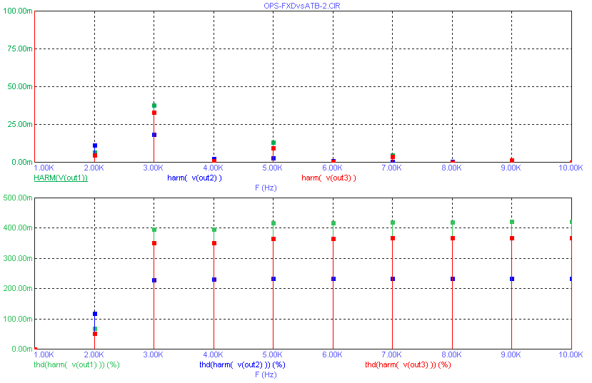

Oops!
Sorry guys. My previous post contains an erroneous graph.:ashamed:
Here is the correct one, together with the results of a second auto bias circuit.
Blue: fixed bias voltage, Iq=140mA.
Red: LT1166 like auto bias, based on a constant product of the P- and N-source currents.
Green: auto bias, based on a nonlinear common control loop à la Marcel van de Gevel. This circuit prevents that if one the output devices is hard turned on, the other is completely turned off. Instead, it idles at a trickle current of ~10mA.
As one can see, the LT1166 like circuit produces less distortion at even harmonics, but at odd harmonics, which will dominate the THD figure, slightly more than the fixed bias circuit. Notice that I have not used a model of the LT1166 itself, rather a "function source" containing a mathematical expression that keeps the product of source currents constant.
The 2nd bias generator performs somewhere in between, but at the 3rd harmonic, clearly better. Notwithstanding that this circuit consumes 10-12 additional trannies, this one will probably be my favorite.
Edmond.

Hi Edmond,
Nice work! It is encouraging that the LT1166-like produces only slightly more THD than the fixed bias circuit, even at 3rd.
I wonder if the relative performance of these bias circuits, distortion-wise, changes depending on the nature of the matching between the models of the P and N channel devices.
Perhaps I missed it, but at what power level and into what impedance were these simulations run? Have you looked at these performances over a variety of power levels, especially at the power level where static crossover distortion is worst (which may be different for the different bias circuits)?
Thanks again.
Bob

Hi Bob,
I think that the relative performance depends heavily on the Id/Vgs characteristics and matching as well.
As for the power level etc. you didn't miss anything, I forgot to mention it, sorry. It's 100W into 8 Ohm.
At 10W the figures change a bit: The THD of the LT-like circuit is twice the THD of the fixed bias output stage, while the THD of the Marcel-like bias is even three time higher.
Notice that these figures refer to the difference between input and output of the OPS and may not correlate with the final results of a complete amplifier. So, my next step will be simulating the distortion of just the output signal.
Also notice that the LT-like circuit is idealized. An accurate model of the LT1166 will probably give less favorable results.
Edmond.

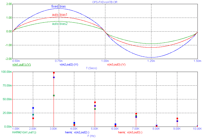

auto bias
Hi Bob,
Now I have simulated the distortion in a different way: supplying an undistorted sine to the gates of the OPS, that is, keeping the mean value of the P-gate and the N-gate undistorted by means NFB, and then looking at distortion of the output signal (harmonics and THD as well).
At 1kHz and 10W into 8 Ohm, the fixed bias gives the best results (blue), then comes the LT-like bias (red), while the Marcel-like bias produces the most distortion. At 100W however, we get a different picture, see next post.
auto bias
And here are the results at 100W. Now the Marcel-like bias is clearly the winner, followed by the fixed bias and then the LT-like bias.
Despite that the Marcel-like bias performs the worst at lower output levels (see previous figures), I still prefer this one, as the bias voltage is easily held constant at higher frequencies by means of a shunt capacitor . In doing so, the distortion is reduced to same level as for the fixed bias (see also post 3351).
Furthermore, the Marcel-like circuit is more flexible and compatible with lower Vgs-th MOSFETs, as low as 0.5V.
Edmond.

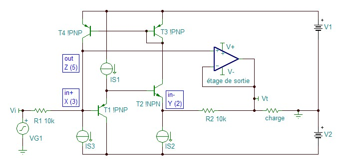

... coming back the topic of this thread: I have been participating in a dicussion in a French forum (as far as my feeble French allowed) about my ec amp as published in Elektor magazine. A member - Forr, who is also a member here - came up with a basic circuit that, in my view, nicely illustrated the concept. Offered here for whoever is interested.

Thanks for sharing, Jan & Forr.
Helps a lot to understand the circuit with its error amplifier scheme and current style positive feedback.
BTW, even this simpified circuit performs quite well, I did a quick sim: Driving 10V into a 4R load, with the output buffer having 2R//schottky in series (heavy distortion mechanism, I'd say), it's only 0.5% (without the distortion network 0.0012%, as a reference). And without ec, some 15%.
- Klaus

Hi Jan,
Hmm-- Essentially the same as:
http://www.diyaudio.com/forums/showthread.php?postid=1315310#post1315310
Do you see the difference?
Edmond.

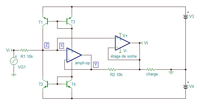

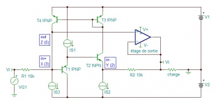

Hi KSTR and Jan,
An even more simple circuit I later thought of. Anybody knowing what a current mirror is, how an op-amp works (the voltage at the inverting input is almost equal to the voltage at the non-inverting input) and that an output stage has a voltage gain not very linear and a bit lower than unity, is able to understand the error correction concept just applying the basic Ohm's law. Negative feedback is not so easy.
(translation : étage de sortie = output power stage; charge = load; ampli-op = op-amp)
