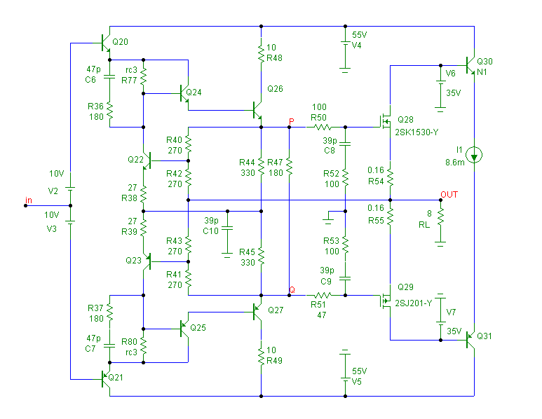

HEC bias generator
syn08 said:
Care to share the circuit and method are you using?
I have used the circuit of Bob's HEC amp (see below). All BJTs are 2SA1407/2SC3601 (your models, btw).
First, I've varied the temperature of all BJTs from 0 to 50 degrees C. This gave a TC between P and Q of -5.55mV/K, less than I expected.
So I also "measured" the Vbe-TC of Q30 and Q31. Together, this was -3.33mV/K (so -1.67mV/K per device), which is also less than the expected -2mV/K. Wrong models?
Next, I varied the temperature of only Q22 and Q23 (keeping the other BJTs at 27 dgr C) and got a TC between P and Q of -6.47mV/K. Apparently, the temperature of the rest of the circuit has also an effect on the bias voltage.
BTW1, the 22V Zener D8 in the original schematic has also a TC, adding one more uncertainty to this bias scheme.
BTW2, you are using lateral MOSFETs in the PGP amp. These devices have a near zero TC at the nominal quiescent current and a negative Id-TC at higher currents. Nevertheless Q22 and Q23 are mounted on the heat sink, resulting in overcompensation. Care to explain?

Re: HEC bias generator
1. Not necessary wrong models, but the lack of good modelling of the thermal effects in the Spice BJT model template (and the MOSFET model template is even worse!). I know close to nothing to MicroCap, but in other simulators that I have used, there are separate device models for high/low temperatures.
2. I'm pretty sure the rest of the circuit has an impact on the bias as well.
3. You are right. The trannies can, of course, be mounted vertically on the PCB however, for whatever reason, placing them on the HS doesn't impact a iota the laterals bias (at 150mA). Honestly, I haven't cared much to analyze/simulate as of why, but I'm sure there is a good explanation. So I chosed to place them on the HS as an "universal" solution if eventually it is to change the output devices.
You can go ahead and simulate whatever you feel like, but I need (as a former Spice "worker") to warn you and others again: as much as simulations should always be taken with a grain of salt, when it comes to thermal analysis and noise analysis Spice really sucks big times, and there isn't much you can do to fix this, unless you would have fun (for example) including explicit shot noise generators in your schematic. One version of Spice could be better than others, but the results are usually BS anyway.
BTW, I have updated the 2SA1407/2SC3601 models. Make sure you are using these.

Hi Edmond,
I think I see the problem. You are using the Toshiba MOSFETs, which have a much smaller VGSon of only about 2V. I use the HEXFETs, with a VGSon of about 4V. In my circuit, there is a resistor from the base of Q22 to the base of Q23 to cause the bias to spread by the necessary amount. You don't have this resistor because the Toshiba devices don't need as much bias spread. This extra resistor increases the effective amount of Vbe multiplication of the combination of Q22 and Q23.
I have more Vbe multiplication to bias my HEXFETs, so I end up with more temperature slope.
The above, in combination with the lower than expected per-transistor Vbe TC, probably explains the differences.
While I determined empirically that placing only one of the two error amplifier transistors on the heatsink gave good thermal tracking, it could be the case that both of them may need to be on the heatsink if the Toshiba devices are used and they still have 5.5 mV/C TC Vgs, while still having a VGSon that is only about half as much as that of the HEXFETs.
Bob

Hi Bob,
Thanks for solving this TC mystery. Indeed, placing a resistor between the basis of Q22 and Q23 does increase the TC of the bias generator to the expected/intended value.
