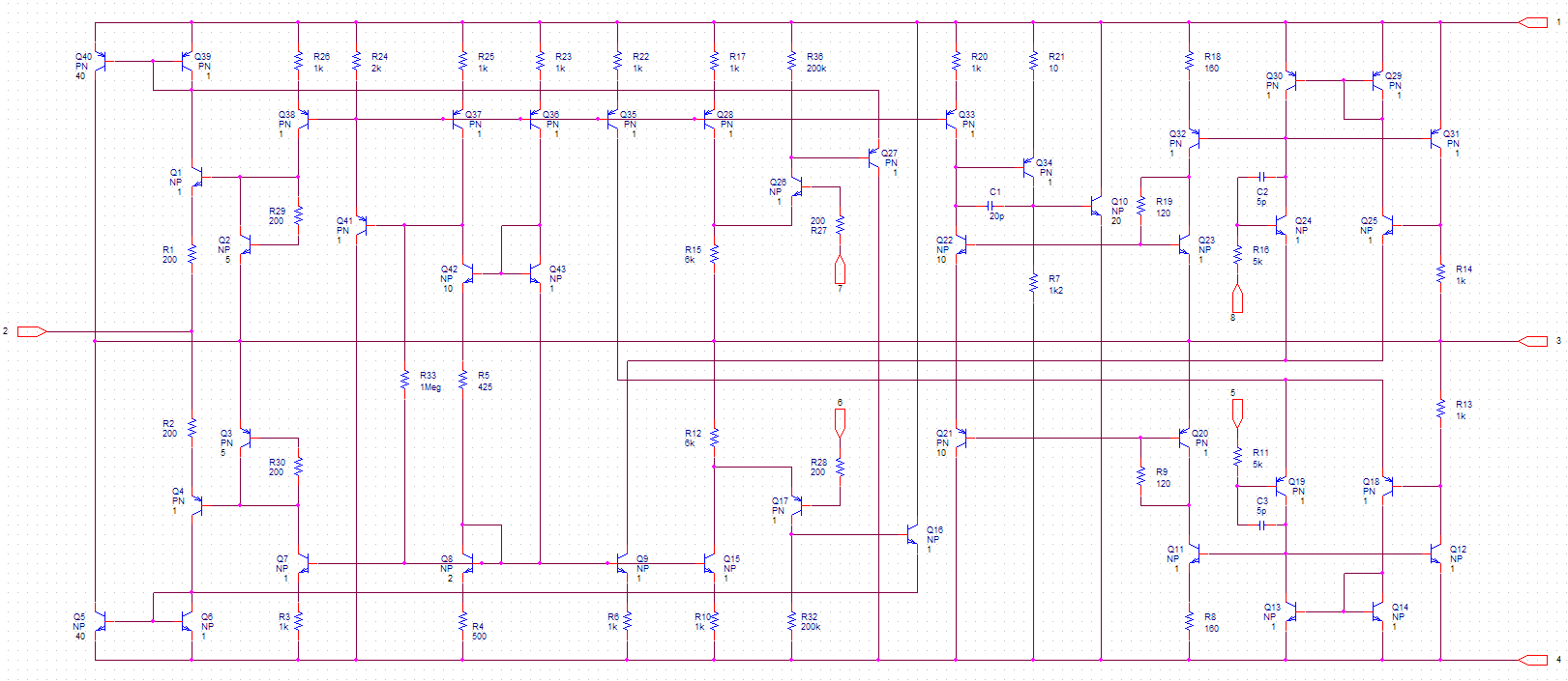

Edmond Stuart said:
BTW, opposed to what some touchy people here apparently think, I have nothing against the LT1166 <snip>
You promised some detailed results on your simulations using the LT1166. Because you are so open to analyzing new circuits and concepts, ultimately have nothing against this IC, and complained about the device model, I have decided to help you in your endeavour of proving your point(s) and publish the detailed schematic of this IC internals (minus some non-essential, diode based, protection circuitry).
http://www.synaesthesia.ca/files/LT1166.PNG
From this point, anybody can pick up and experiment (by simulation or by breadboarding) various configuration using this IC (and God knows, it can be used in quite some). The P and N devices models are not critical, you can use the ones in the model I have published above:
.model NP NPN(BF=125 Cje=.5p Cjc=.5p Rb=500)
.model PN PNP(BF=125 Cje=.5p Cjc=.5p Rb=500)
The number across each tranny is the device area. It is important to specify this parameter for each tranny, otherwise nothing will work properly.
If your busy schedule will accomodate this small piece of work, I am sure everybody will appreciate.
You are welcomed 😀
You are welcomed 😀
Thanks for your effort and contribution here.
Bob

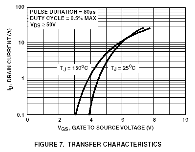

Re: Re: Re: Re: LT1166 vs Vbe multiplier
syn08 said:
Being strictly voltage controlled devices, MOSFETs do not usually have any Vgs tempco directly specified as a datasheet parameter.
Not a single valued parameter, but indirectly as the transfer characteristic at different temperatures, which allows us to get the Vgs tempco at a given drain current. Problem often is that these curves stop at way to high currents, but in most datasheets even for switching devices, the graph is shown at least.
The good old IRFP240 shown has, at 100mA, about 0.9V delta Vgs from 25degC to 150degC, which gives the claimed figure for this device class of about 7mV/degC.
- Klaus

Re: Re: Re: Re: Re: LT1166 vs Vbe multiplier
That's what I am saying. It doesn't make much sense to talk about Vgs tempco, as long as Vgs cannot really move around with temperature. Id can and does.
Moreover, the Id tempco depends on Id itself (and the zero tempco is in the amps range for verticals, much lower for laterals, etc...) so one more reason not to specify this in a data sheet other than a Id-Vgs curve. I agree that these curves are usually around high currents.
Finally, at low currents, the "Vgs tempco" is essentialy determined by the MOSFET threshod voltage variation with temperature. Id~(Vgs-Vt)^2 therefore the "Vgs tempco" is equal to the Vt tempco (and is of course negative). Unfortunately, the Vt tempco depends on lots of variables, most of them significantly related to the manufacturing technology and device layout (HEXFETs from IR are different than STRIPFETs from ST). Therefore, the Vt tempco is barely consistent across similar devices coming from various manufacturers. This is another good reason why a design should not rely on a precise Vgs tempco at low currents.
In another life, I've measured tempcos as low as 2.5mV/C and as high as 6.2mV/C. For example the OnSemi's NTLJS3113P has a Vth tempco specified (and measured) at typ 2.68mV/C but this is a rather low power device. One to another, a 5 to 6mV/C tempco is kinda worst case. 4-5mV/C would be, say, typical for modern, medium power devices.
Edit: IRF240/IRF9240 do not qualify as "modern devices", and in general none of the IRF classics do. Fairchild, OnSemi and in particular ST are really modern devices. Look at the ST STB19NF20, the Vth coefficient is typically under 5mV/C and that's a 19A 200V device. OTOH, the STP17NK40Z (400V and 17A) has a Vth tempco of about 7mV/C.
