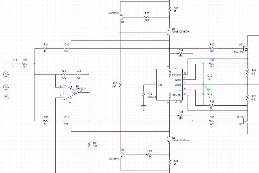

I realize I may sound like a broken record, but I have to ask: why were the results dissapointing? What were the problems you encountered? Could you share the configuration you used?
Here's mine: http://www.diyaudio.com/forums/attachment.php?s=&postid=1107005&stamp=1168801187

I have played with it in that configuration, but with a different front
end and using Mosfet followers. It biases as advertised, but as
compared with a constant voltage bias generator it offered little
improvement at low frequencies, and much more distortion at high
frequencies. Being that this is in the spec sheet, I didn't find it
surprising. I imagined that by exploring the permutations of
possible connections and values I could get past that.
I was incorrect.

Opposed to Nelson and me, you have used this IC with both BJTs and MOSFETs, so I like to learn if in both cases the results were equally favorable.
The point is that the behavior of the LT1166 is quite distinct: with ideal BJTs, Re->0 and Vbias=fixed, the product of the collector currents is already nearly constant. This means that the LT1166 as little work to do, i.e. the the modulation of Vbias is small.
MOSFETs on the other hand, don't have this property, so the Vbias modulation will be much larger.
Perhaps this explains why you have good results with BJTs, while others, using MOSFETs, are less optimistic.

I think that maybe we have to agree on the expectations for the part. I'm not sure that anyone here is claiming that it is the best solution for ultra high end, but that depends a bit on what we define as ultra high end. I'm guessing that you define it as THD-20 at full power of 0.0001% or lower, but I'm not sure.
Using it with MOSFETs, and without error correction, I'm guessing it would be tough to hit 0.001% with it, although I have not considered whether TMC might help it get there (or to what extent TMC is compatible with the LT1166). But it is tough to get to 0.001% with conventional bias spreaders with the same MOSFET output stage not using EC or TMC.
So maybe we are disagreeing on the semantics and performance expectations.

OK, let me give it a shot. That work was two years ago and got interrupted and shelved, but here is what I recall I did. If I can dig out the schematics later I may be able to provide more detail.
Syn08 is on the right track with his circuit, but there are a couple of things I recall doing differently. I'm doing this from recollection, so forgive me if I get something wrong.
First keep in mind that I use the LT1166 only as a dynamic bias spreader, as SYN08 appears to have done. I used my LT1166 in conjunction with a discrete VAS+front end, and it drops in right where the usual bias spreader goes. I used it to feed vertical MOSFETs through a bipolar driver.
One thing to realize is that, acting only as a dynamic bias spreader, it should have virtually no effect on the transmission of the program signal to the output stage. The bias spread will usually increase beyond its quiescent value for output stage current swing into the load of EITHER polarity. This is a direct result of the translinear action that, as a byproduct, keeps the "other" transistor from ever going completely off.
Note that the voltage ACROSS the LT1166 will thus be distorted. Ideally, this should not matter, as the change in bias spread should effectively be in the common mode if we define the signal drive to the output stage as being in the differential mode.
But now think of how we do our global feedback compensation.
One important trick is how we apply the global feedback compensation. This is one area in which my approach differs a bit from that of syn08. He takes his Miller compensation 47 pF capacitor from one side of the LT1166. This is not optimum. That approach only works optimally for a non-signal-dependent bias spread. With the LT1166 we have a signal-dependent bias spread. This might explain experiences wherein the distortion increases at higher frequencies.
In my circuit, again if I recall correctly, I form a signal that is the sum of the signals on both sides of the LT1166. One way to do this is to take a center tap off between the emitters of the EF drive transistors. I believe I took the Miller compensation from this center tap. This reduces the effect of the distorted spreading voltage and effectively feeds a clean set of drive signals to the output transistor gates.
One can also form this compensation feedback sum voltage in other ways, such as by use of a resistive divider right across the LT1166 (which will yield a zero in the Miller integrator), or with a capacitance voltage divider across the LT1166.
I also believe that I had a compensation capacitor across the spreader function of the LT1166. I do seem to remember having to understand carefully the loop dynamics of the LT1166.
My bottom line recollection was that the circuit with the LT1166 in it performed just as well distortion-wise as as conventional fixed bias spreader, even up to high frequencies.
Bob
Nelson Pass said:
I've done that Bob, and yes, I've gone way outside the box with
it. The results were a disappointment. If you know the magic
approach, I suggest that you consider sharing it and doing LT
a big favor.
Hi Nelson,
Bob
Re: Re: Re: Re: Re: LT1166
Now that you mentioned it, I recall some other experiments I did and indeed, there are better ways to compensate the loop. Unfortunately there's not much option for the LM4702 but I was able to find a schematic fragment that illustrates what I was playing with last year - attached.
The LT1166 model that I posted is correct and works fine with PSpice. I suppose other simulators may have problems in parsing device relative area parameters. Here's the original model I got from LT:

Re: LT1166
Huh? Modulation of Vbias has definitely an effect on the transmission, because it alters the gm of the output stage.
Here some figures from my "armchair":
Circuit: NFB output stage
Devices: 2SJ201/2SK1530
Iq = 150mA
Po=50W in 8 Ohm
With fixed Vbias THD20=34ppm
With fixed Id product THD20=103ppm
Cheers, Edmond.
