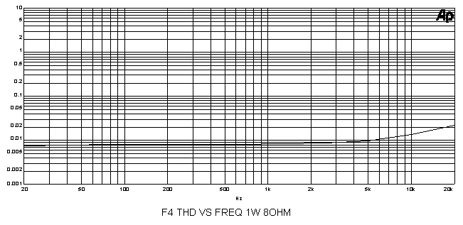

syn08 said:
Do you remeber some numbers? How much HF distortions you got with the LT1166?
The data sheet has some distortion information, but only for the transconductance stage, that myself (and, as far as I understand, yourself) did not use.
I tried it both ways. I set up a MOSFET follower stage and drove
pin 2 as shown in the app notes Fig 1, and I got a curve comparable
to the one they showed, which at 1 watt is maybe .1% at low
frequencies climbing rapidly above 10k or so.
I also drove it as you did through pins 1 and 4 with pin 2 floating,
and for open loop I got similar results.
Perhaps I was doing something wrong, but I can't imagine what it
might have been. As I said before, I played around with it for a
couple of days, trying to do better.
If you know me at all, you understand that I'm not particularly hung
up about distortion numbers, but below you can see the open loop
figure for the output stage in question.
Clearly I was doing better with just a fixed bias. Since the chip
seems to work for you, I'll give it another shot sometime.
