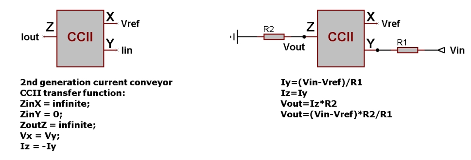

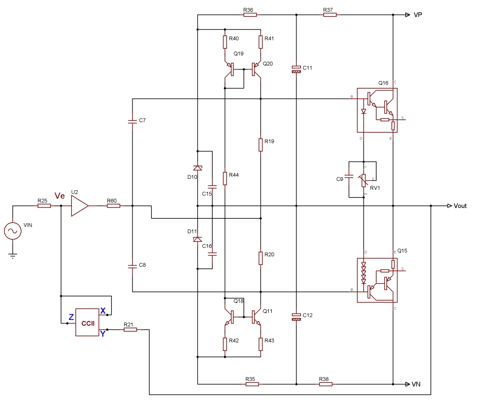

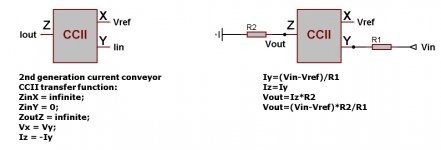

KSTR said:[snip]Maybe the use of a non-opamp circuit symbol would have done the trick even better ... the next time you publish this trick 🙂
- Klaus
Yes... Like this, perhaps:
Jan Didden
bias
Thanks Klaus and take your time.
That's precisely the problem. I doubt whether it's feasibly to design a sufficiently fast, accurate and reliable minimum detector. Therefore, I've chosen for a circuit that "spread out" this minimum to a much larger range of about 1A of output current. IOW, when both N- and P-channel MOSFETs are still conducting a measurable/detectable amount of current, yet reproducing a signal that is closely related to the bias current at quiescent condition. (see the middle curve of fig. 3)
Regrettably, I don't think that my circuit performs equally well if applied to a D2S amp.
Hmm..........
Cheers, Edmond.
KSTR said:Another great circuit idea of you, Edmond. Have to digest it slowly, I guess.
In fact this circuit looks quite close to what I have in mind, one difference being that I wanted to use the true minimum instead of average of the output current (which is more or less identical only while in class-A), compare that to a reference, feeding a servo in turn. I feel that sensing the minimum might be essential to keep things in order, under large class B operation. It's intended for a D2S stage where, when used without e.c./feedback, keeping the correct bias will be essential (and this optimum might still be itself dependent on actual die temp, something I would need to investigate). There still is the problem then whether the minimum detector is fast enough to catch the sometimes very quick transition through the minimum, same problem that you see, I read.
That's why I think of having regular "slow" temp sensing and only adjust its op point with the quicker servo over a limited range.
- Klaus
Hmm..........
Cheers, Edmond.
