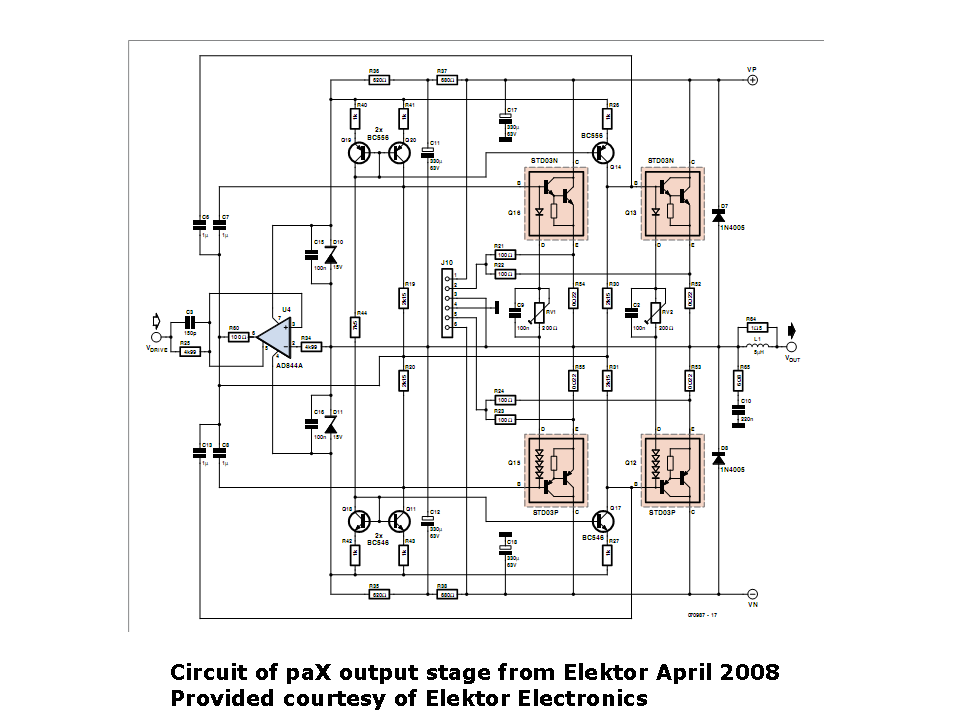

Elektor Electronics have agreed that I can post the schematics of my ec power amp on-line. The first article appeared in the April issue and described the output power stage. Circuit below.
Part 2 (Vas) and part 3 (comprehensive protection system) will appear in the May issue. I will post schematics when they are available.
Feedback, global or not 😉 is welcome!

Jan,
Can you give us some brief performance specifications. Power,
distortion at max power / 20kHz / 4ohm / 8 ohm etc.
What was the design intent?

Hi Terry,
Design intent was twofold: see what you can get with only ec (the Vas has it's own ec loop) without a gnfb loop; and get rid of thermal (memory?) distortion. I don't know if I got to the last goal as I haven't done any measurements on that yet. Long-term thermal stability is OK but I was interested in avoiding shift of bias point after high-power bursts. So I still need to verify how that is.
Power is 100/8, 200/4. I have a few graphs in part 2, lets say THD is about 0.005% at lower freqs, rising to 0.05% at 20kHz, until just before clipping.
I think the way it works is not really obvious from the schematic; probably worthwhile to download the English version of the article from the Elektor UK website:

Yes thermal related effects are a problem and those Sanken devices
should solve it. I thought of using them myself, the only bug is you
don't get to control current through first BJT of the darlington pair.
OK so it's not quite a PGP but certainly very good performance for a
sans global FB design.
I understand it and think it is very clever. Particularly the way you
have utilised the open loop connection of 844 to be a) an I-V b)
EC 'comparator' and c) driver for OP devices all in one hit.

Hi Jan, nice piece of work.
How would you compare this implementation of HEC with the discrete transistor version that Hawksford and I used?
It will be very interesting to see how well the Sanken parts correct for the thermal stability following a power burst. I have curves showing that effect for a conventional BJT output stage (and MOSFET) in my original MOSFET error correction paper. I have always felt that that effect was a significant concern, especially with BJTs, as they can easily be left under-biased after a power burst. BTW, my work on that thermal problem predates that of the French guy you cited 🙂, although I would not be surprized if there is other work on this subject that predates mine.
What level of bias current flows through the Darlinton transistors in those Sanken parts? What is the rated ft of the Sanken parts?
Did you consider using OnSemi ThermalTrak devices as opposed to the Sankens?

Hi Bob,
I'm not sure the two topologies can be directly compared because I also use H.ec in the Vas and no global nfb. The Vas ol gain is 20. With the ec loops the total amplifier performance is roughly comparable with a good 'traditional' amp. Of course, in your and other amps that use *both* output stage ec *and* global nfb (with a high ol gain) you can get better figures.
Anyway, my output stage with ec is not the limiting factor in the whole amp; the Vas and output stage have roughly the same linearity and the amp as whole also, the limiting factor is my particular ec implementation with the AD844 as CCII. It would be interesting to see what level can be reached with a better, possibly discrete, CCII implementation.

I did consider the OnSemi's but they are, in my view, just a 'me too' implementation of the Sanken idea; the OnSemi's don't have the carefully matched tempco between the diodes and the transistors. You have the diode on the die but you still need to tailor the bias circuit to make the tempco's track. Sanken did a great job there, and the effort can be seen in the fact that they used a single diode in the N-device and a string of 5 schottky's in the P device. The result is pretty good tracking, IF you use 2.5mA through the diodes and 40mA quiescent current. I did cheat though, because 40mA is just at the border wrt xover distortion. I run mine at 55mA, still good enough (long term) temp tracking and very little xover.
Sanken is very sparse with the specs; Ft isn't specified. The Hfe vs Ic is nicely linear (on a log scale: 1000 typ at .1A, 10,000 at 10A. Kind of inverse beta droop.
Funny thing with those Sankens: the original versions labelled SAP16N, P had also the Re (0.22 ohms) on the die for even less pcb real estate. But they found out that those Re's had a smaller SOA than the darlingtons themselves; the Re's blew before the transistors, and that of course made you replace the whole thing.
The versions labelled STD03N, P don't have the Re, and that pin is still sticking out but cut off. If they only had brought out the driver emitter out to that pin!
Anybody here who has some clout with Sanken??

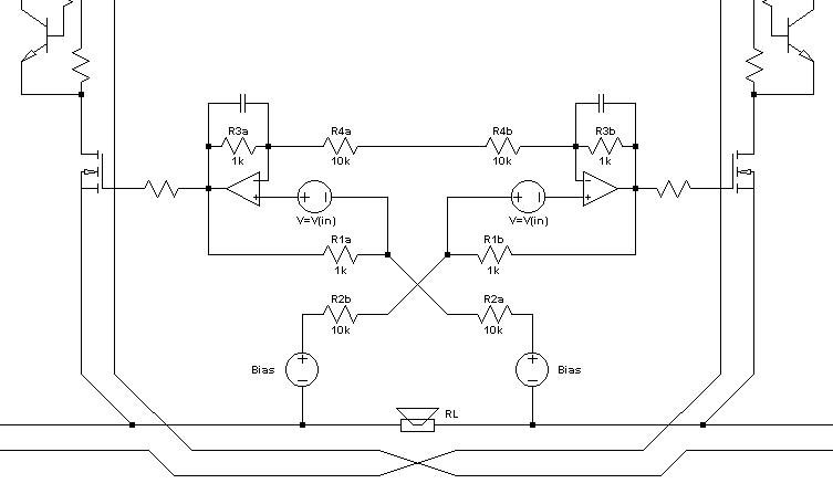

Hi Jan,
very clever design you did, this boostrapping / current "stealing" hookup. But why did you(?) choose to draw the schematic in this obscure way (opamp reversed, all those paralled R//C loitering around) 😀
IMHO this is a perfect example that e.c. == loop feedback, at times. To me it looks like a nicely designed but otherwise "ordinary" full feedback power buffer. In the end it's only a point-of-view issue how you name it, d'accord?
Nevertheless, let's argue a little. E.c. I would understand as a mechanism which might be null-trimmed, the pos/neg feedback balancing that was discussed here to big extend. Somehow something *on top* of an existing forward path (one might regard this forward path the one we would have if the opamp were running as a local buffer with its loop closed locally instead of globally around the output. And the null-trimming is "automatic").
To better illustrate what I mean look at the attached circuit, the stripped core of a e.c. circlotron I'm fiddling with (cascoded, D2S-biased and xformer coupled, btw). Without R4 in place we would have a simple source follower config (with gain 1+R2/R1). It would have a finite Zout of 1/(2*gm) and any change in the gm would introduce distortion, in this case, when leaving the constant gm D2S portion, it would be expanding odd order slope distortion.
When R4 is set such that R1/R2=R3/R4 we get full cancelling of distortion and zero output impedance (to the amount loop gain allows us to reach that ideal), further signal gain is doubled in value. If R4 is larger, cancelling isn't perfect and Zout is slightly positive. If R4 is lower than optimum, cancelling again isn't perfect (and opposite in effect, error residue swaps in polarity) and the output impedance gets negative. This would be the the pos fb > neg fb case. In your circuit, this case cannot happen. Which surely does no harm to its peformance, and I definitly don't want to reopen the e.c. vs nfb sematics battle that we have seen in this thread.

KSTR said:[snip]To better illustrate what I mean look at the attached circuit, the stripped core of a e.c. circlotron I'm fiddling with (cascoded, D2S-biased and xformer coupled, btw). Without R4 in place we would have a simple source follower config (with gain 1+R2/R1). It would have a finite Zout of 1/(2*gm) and any change in the gm would introduce distortion, in this case, when leaving the constant gm D2S portion, it would be expanding odd order slope distortion.
When R4 is set such that R1/R2=R3/R4 we get full cancelling of distortion and zero output impedance (to the amount loop gain allows us to reach that ideal), further signal gain is doubled in value. If R4 is larger, cancelling isn't perfect and Zout is slightly positive. If R4 is lower than optimum, cancelling again isn't perfect (and opposite in effect, error residue swaps in polarity) and the output impedance gets negative. This would be the the pos fb > neg fb case. In your circuit, this case cannot happen. Which surely does no harm to its peformance, and I definitly don't want to reopen the e.c. vs nfb sematics battle that we have seen in this thread.- Klaus
Hmm, you're going a bit too fast for me now, I need to digest it.

Yes, it does look funny, doesn't it? I have at least three different ways of drawing this that I tried out, without being happy with it. Anytime you draw it the 'conventional way - pointing to the right - your mind automatically says: "aha, opamp", which of course it isn't. The input to the circuit is at pin 5, NOT pin 3 (or 2). So I decided to draw it a bit lopsided to avoid the automatic "aha, opamp" and force people to think a bit.
