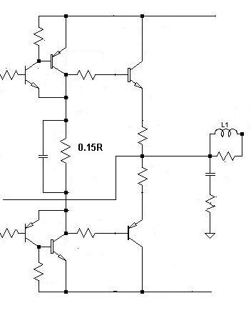

Hi Edmond,
Mihai is correct - thank you Mihai! Pardon my not posting an image, I did not have one handy and time was, and remains, short!
I had envisaged a double emitter follower with the first device, the driver, replaced by a CFP. The second device, the output transistor, is operating in simple common collector.
I prefer this arrangement because by the simple expedient of a resistor between the two emitters of the input devices we can keep the driver CFPs on all the time, avoiding the poor switch-off behaviour you referred to. There is still no compensation of the Vbe losses on the output devices, but these are dwarfed by the more linear compression conferred by the emitter resistors; with 0.15R emitter resistors, only 33% of the signal compression at peak is originated in the output devices (assuming 5200/1943).
It is becoming clear to me that in no other stage of an audio amplifier more compromised than in the output stage......
Thank you both!
Hugh

Hello
Is it something like that ?
Thank
Bye
Gaetan

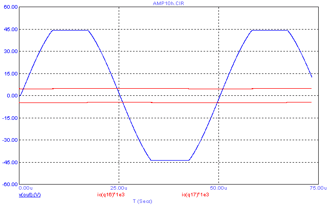

Hi Bob,
I agree with most of your points. In the past you asked me the same question (about the benefits of a symmetrical front end), so you know already that our theoretical views don't differ at all.
It's because of some practical implications that I prefer a fully symmetrical topology, for example: one cannot always simply double the current, without exceeding the max. (or preferred) power dissipation of the input transistors.
As for the maximum output current of the VAS, mine easily exceeds two times the standing current without entering class B. The 'other' VAS is never turned off completely.
As for the common mode control loop, of course one have to pay attention to the stability of the CMCL (ie loop gain and phase margin). To get it right, however, is far from complex. in fact, the easiest task wrt all other pitfalls. If you look at my non-HEC amp for example,
http://www.diyaudio.com/forums/attachment.php?s=&postid=1367089&stamp=1196786670
a stable loop is 'automatically' achieved by means of the DTMC caps C4 and C5. Aren't you splitting hairs?
As for clipping, with or without CMCL, it doesn't matter as in both cases additional circuitry is necessary to ensure a decent behavior at overdrive conditions. I have also added such circuitry (not published yet) to the non-HEC amp and it performs quite well, I should say. See picture below. Also notice that the VAS currents are unaffected. Have you seen this ever before? I guess not.
Cheers, Edmond.

Hi Edmond,
In cases where a cascode is used, doubling of the current would not matter a lot in regard to power dissipation in the input stage. For example, I often bias my input FET pair with a tail current of 2-4 mA. Doubling this to 4-8 mA with a cascode at about +15V will only result in a max total dissipation in the FET pair of about 120 mW.
I must be missing something about your circuit's maximum VAS output current, or perhaps we are defining Class-A operation of the VAS differently. If you have a VAS standing current of 10 mA, and you can swing it to well beyond 20 mA, and the other VAS transistor does not shut off, I'm not sure I would call that Class-A. For one thing, it seems that such operation would imply an increase in the instantaneous common-mode current.
My definition of Class A may be different than yours. One side not turning off is necessary, but not sufficient for Class A, in my opinion. My view of Class-A is that both transistors are contributing about the same amount of transconductance to the output over the full swing. I don't see how that can be the case if one transistor well exceeds twice the standing current in signal swing.
Am I missing something here, or do we just disagree on the definition of Class-A?
Thanks,
Bob

Hi Bob,
Indeed, you are missing something. For example. the patience and the willing to read my post more carefully.
I'm not redefining the meaning of class-A, I haven't even used that term.
I only said that "The 'other' VAS is never turned off completely.", and I really don't care how well it fits into some type of class.
Cheers, Edmond.
