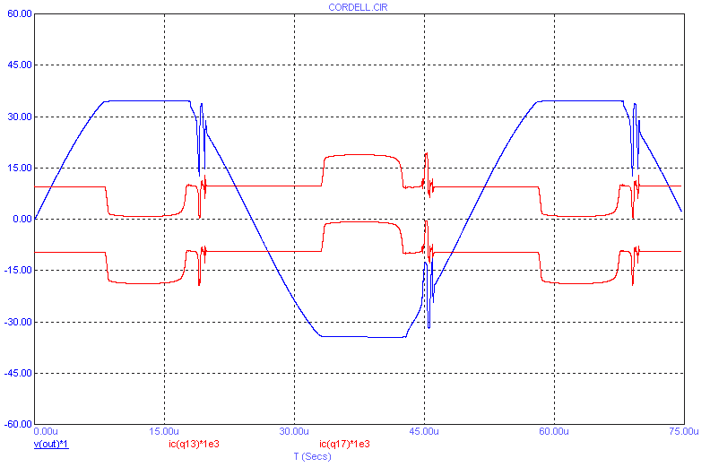

Wow, that's pretty ugly! Is that how the CMCL VAS behaves in clipping if special clipping measures are not taken?
A more conventional input/VAS circuit, even without clipping measures like Baker clamps, does not behave that badly.

It is a simulation of an amp which I found in some old Siliconix handbook. 🙁
Cheers, Edmond.

Re: Re: Re: Clipping
Edmond Stuart said:
Hi Bob,
No, it is certainly not a CMCL VAS without a clamp.
Cheers, Edmond.
Glad to hear it is not a CMCL. I honestly got the impression that you were illustrating the behavior of a CMCL when clipping measures are not taken. It would have been helpful if you told us up front what it was you were illustrating. I'm not a very good mind reader.
Bob

No need to be a good mind reader. Just have a careful look at the graph and reread my previous hint. Then you will soon discover who's amplifier behaves so well. 🙄
Cheers, Edmond.

Hi Bob,
Apparently my "silly game playing" is too difficult for you.
I told you that the amp was form an old Siliconix handbook, more precisely, Mospower Applications Handbook, chapter 6, pp. 111-124. What else did you expect?
As the clipping behavior is rather embarrassing, I also masked (more or less) the caption of the graph, but, regrettably, you didn't grab it.
Therefore you oblige me to make clear in less covert terms that it is your amp that behaves so badly when a couple of variables deviate a little bit from their nominal values, that is, all in the same wrong direction. To name a few:
1. The supply voltage of the front end.
2. The supply voltage of the output stage.
3. The threshold voltage of the MOSFETs (2...4V)
4. The Zener voltage of D8 (22V)
5. The Zener voltages of D9 and D10 (4.7V)
A simple Baker clamp around the VAS is far from optimal, in particular when the front end and the output stage are fed by different PSUs.
A better approach is to make use of a clamping circuit that 'looks' where and why it really goes wrong: saturation of the (pre) drivers. If a driver is almost running out of steam (Vce<0.4V), my clamping circuit sends a signal back to the feedback node of the input stage, preventing saturation not only of the output stage but of all other stages as well.
Also this clamp works independently of supply voltages and is insensitive to zeners, threshold voltages, etc.
Cheers, Edmond.

Hi Edmond,
Sorry to be so slow on the uptake. I'll look into it and reply. Right now my day job has me out in San Francisco at the International Solid State Circuits Conference. I've had trouble getting onto the internet until now, and the conference is keeping me extremely busy.
Anyway, I'll look into it and get back to you. I do like Baker Clamps and do agree that there are better and worse ways to do them, including ones that adapt properly. There are a lot of complexities that go into an amplifier from just designing a really low distortion one to designing one that behaves well under all conditions in the real world. That paper was not intended to include all of those niceties; note that it did not even include any addressing of the issues of protection circuits, for example.
Bob

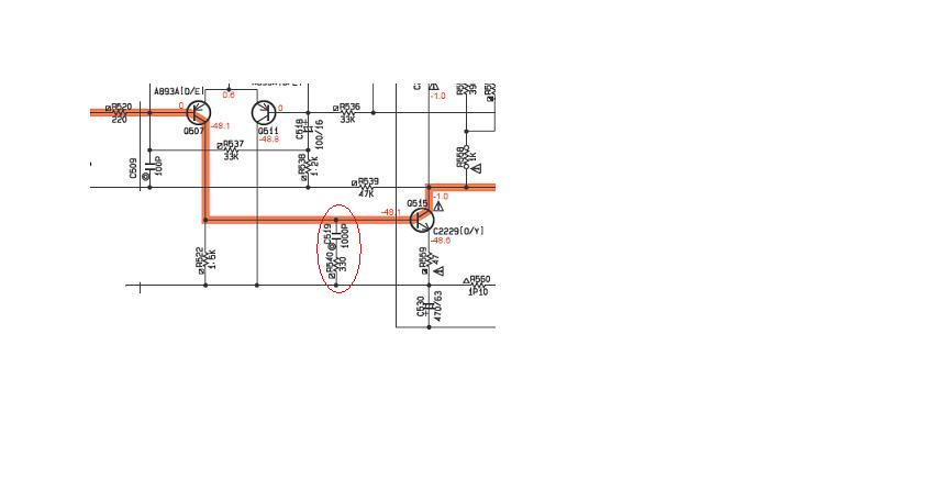

Hi Mr. Cordell.
In post 3177, you have explaned the Miller cap function in single T Vas. You would try to explaned with RC filter input VAS (No Miller cap)?
Schematic attached bellow.
Thanks.
GEirin.

GEirin said:
Hi Mr. Cordell.
Thanks.
GEirin.
In the arrangement that you have shown, the 1000 pF capacitor and the 330 ohm resistor in series with it cause a pole-zero pair to be formed in the base circuit. The pole looks to be at about 100 kHz and the zero looks to be around 600 kHz. Over this range of frequencies it drops the gain by perhaps 15 dB. Depending on what other poles there are in the collector circuit of the VAS, this will be part of establishing an open-loop gain rolloff characteristic that will pass through 0 dB loop gain at a frequency where there is adequate phase margin. The use of this circuit usually causes one to forego the advantages of pole-splitting that occur in a Miller compensation arrangement, but this is partially made up by the introduction of the zero by the 330 ohms resistor.
Hope this helps,
Bob
