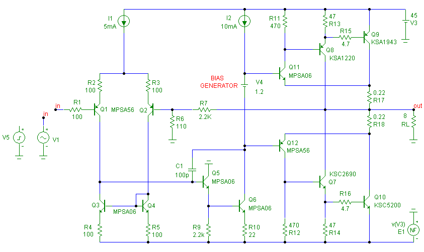

May I ask another question? Ordinarily the Vbe distortion of the double EF output stage is largely produced by the output device itself, whose Vbe runs from 600mV at no signal to around 1.8V at 5A. These voltages are easy to divine from the device curves, of course. But there is also a contribution from the drivers, which might run to 400mA collector current with a four pair output stage. This might only be from 600mV to 800mV, but it does contribute to Vbe compression nonetheless.
What about using a CFP driver stage, wherein the pre-driver controls the Vbe which stays essentially unchanged due to the very small current changes in this first device? (Some attempt should be made to keep this CFP stage on at all times.) This would reduce driver stage distortion to virtually zero...... and might deliver very high, EC style input impedance to the stage as a whole.
My concern is the stability of EC. It appears to me that it usually requires revision of the lag comp to the VAS, and this is a PITA.
Hugh
Hi Hugh,
To avoid any confusion, have a look at the picture below. Is this what you mean? If so, I don't feel qualified enough to pass a definitive judgment, as I don't have any experience with this kind of output stages.
Nevertheless I did a quick simulation of this circuit, and indeed, it's more prone to instability. The unity gain frequency of the local feedback loop around the OPS is quite high and the phase margin rather low (sorry, I don't give you the exact numbers as I don't know how reliable they are).
Anyhow, to get this amp stable one should keep the lead inductances of the output devices as low as possible and take care of sufficient HF decoupling of the supply rails.
BTW, I don't think you can avoid these problems by adjusting the lag compensation to the VAS, as it's a local problem around the OPS and the Ft of this local loop is much higher than the Ft of the global NFB loop.
Regarding the distortion, I have made a remarkable observation: The THD20 is below 10ppm in class-A or B, but in class-AB 10 to 30 times higher (depending on the quiescent current).
Apart from stability issues, this topology doesn't excel in turn off switching of the output devices, resulting in cross conduction at steep transients.
All in all, it is not my favorite OPS, despite the fact that in terms of THD it comes close to HEC.
I hope that somebody else will jump in and share his real life experience with you.
Cheers, Edmond.
I guess that more factors are involved, than only current gain.
In this particular embodiment the feedback ratio will be (h21(Q5)*h21(Q10)*R10||ZcQ3)/(h21(Q5)*h21(Q10)*R10||ZcQ3+ZC1)
So the explanation is that the higher current gain allows higher input resistance of the VAS thus higher local loop gain around VAS and lower OP impedance. Good.
Thank you, Edmond
