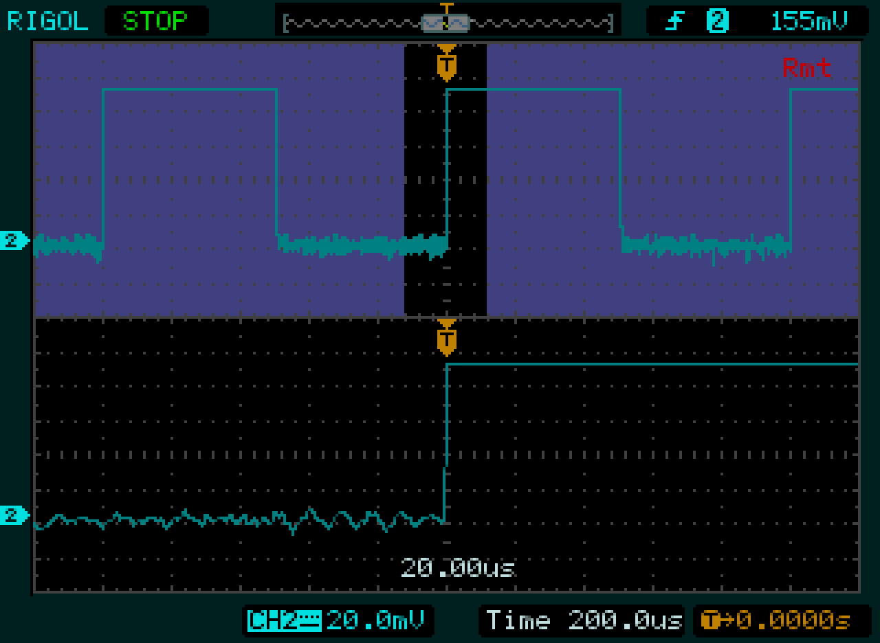

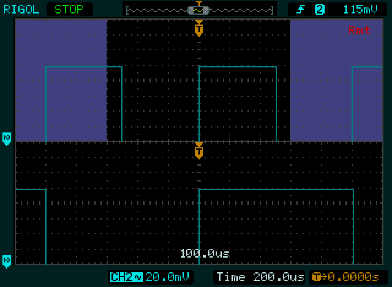

Ok, dunno if it is just me but on the two images you just posted neither opens to a larger size. They work earlier in the thread and in other threads, not here.
First impression, from the small pix is that there ought NOT be any thickness to the top of the traces.
This is a possible clue. Something is causing that to happen.

The noise is the trim pot. The calibration signal is very clean. I'm just not getting a noise free signal out of the scope. I will try a real resistor ladder and not a trimpot.
Funny about the pics not opening. They open fine here, nearly filling my laptop screen.
This is a shot of the calibration signal output via resistor ladder to knock the voltage down so the amp won't clip. It's a PNG file.
It is amazing just how noisy a trimpot can be.

OK, so I got a nice clean square wave by making the resistor ladder very small, and not using alligator clips. Then, when attaching an RCA cable soldered to the resistor ladder, there is noise on the low side of the square wave, but clean tops.
There is 6mVpp of noise on the bottom of the square wave at this point. I suppose a proper signal generator would solve this?
What's the total p-p amplitude of the square wave? 6mV of noise is only important in relation to the whole signal -- by itself it means nothing.
The total amplitude it 0.384 V. So 6/384 = 0.015 or about 1.5% noise. But this is ONLY on the bottom of the square wave.

NOPE. got the bottom clean, but not the top, 25mV out of 160mV ( was wrong about the overall level)
And it just became dirty on both sides.
Sorry, no square wave that is good enough for measurement purposes is going to be happening here anytime soon.

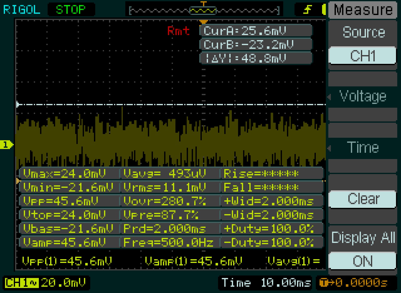

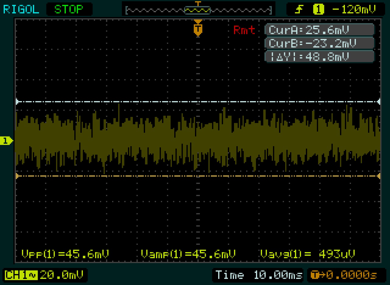

Today, I had company, but we did get one chart out. This is the noise on the Right channel.
X =10 ms, Y=20 mv. The trace is centered at zero here, the reading is AC coupled. Both inputs were shorted.
We also did this, but I did not save, an F5 with inputs shorted( Vpp hovering around 30 mV ) and an AB international class 9620, though the 9620 inputs were not shorted. The 9620 showed about 30-40 mV as well. In all cases, the speakers were disconnected.
The left channel of the F5T was about 10mVpp better. The power supply voltages will be obtained tomorrow. Beer and electronics mix badly.

BigE, ur a tough audience... suggest you re-read?
We *were* looking for clean square waves from the scope, in order to do a simple test subsequently on the amp.
So, perhaps the next test given what you have done just now is to run the FFT using the QA on each of the amps with the inputs to the amp under test shorted and see what it looks like. Will they have the same residual "pollution"?

I don't understand why you would pick up the "pollution" you show in your images from the divider. I don't get this at all. I have a simple resistive divider built into two BNC connectors with ground lugs attached by soldering, sitting out in the world, unshielded. You could put the divider in line as I have and then shield it. A box would be classy, but a wrap of aluminum foil might suffice as long as you don't short things out. Etc.
I think you still misunderstand the idea behind the square waves.
And, I still have no clue what the amplitude of the square wave is/was.
Again the idea behind the square waves is to look at the slope of the leading and trailing edges and to see if the amp produces "overshoot" or shows signs of ringing. That's it. Nothing more. All that is needed is a fast, reasonably clean square wave of about 1v p-p. More or less 1v p-p.
Let's ask a question, see what your answer will be? Simple question.
What will the voltage appearing on the output terminals of your amplifier be with the inputs to the amp shorted?
Second question: have you yet looked at the output of each channel of the amp with the inputs shorted??
