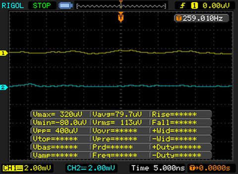

When evaluating the noise performance of the scope, I just clipped the probes together, not the grounds, since I did not use the grounds on the final few pics. Was that the correct way to do it?
According to the measurements on the scope, there is a max of 12mvPP. This seems huge.

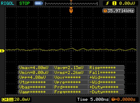

I have been reading about Rigol scopes lately as I'm considering to buy one. Attached 2 screenshots from eevblog.com for a DS1052E:
The probe and cable are picking up noise in the environment, but the scope internal noise is only around ~400uVpp.
- First one shows the noise level (~400uVpp) when channel is shorted with a 50ohm terminator directly at the input;
- Second one shows the noise level (~4.8mVpp) when probe is connected and shorted at the tip.

Wide bandwidth and noise go together, and scopes with 1M input Z are quite sensitive to environmental noise from the probes -- EMI, RFI, etc. 400uV p-p at 100MHz is OK -- comparable to 40 y. o. scopes by HP and Tek. I like the features of the Rigol, especially for the price, and I like not being tied to a computer to make measurements, which is why I don't have a USB scope add-on.
