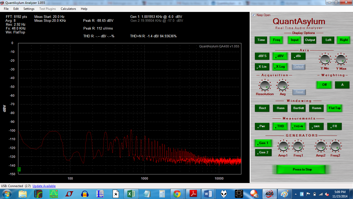

OK,so I got this MARVELOUS shot by holding an 8" metal file wrapped in stranded 18 awg hookup wire connected between two alligator clips while in loopback mode.
Same at the back where the speaker posts are... I assume that at the rear, it is radiating from the unshielded power cord. I will borrow a shielded one and see if that helps.
This seriously looks like diode switching and harmonics from MUR3020 diodes.
Would snubbing work? Should I just follow Quasimido's rules? (Mark Johnson's bell ringing snubber).

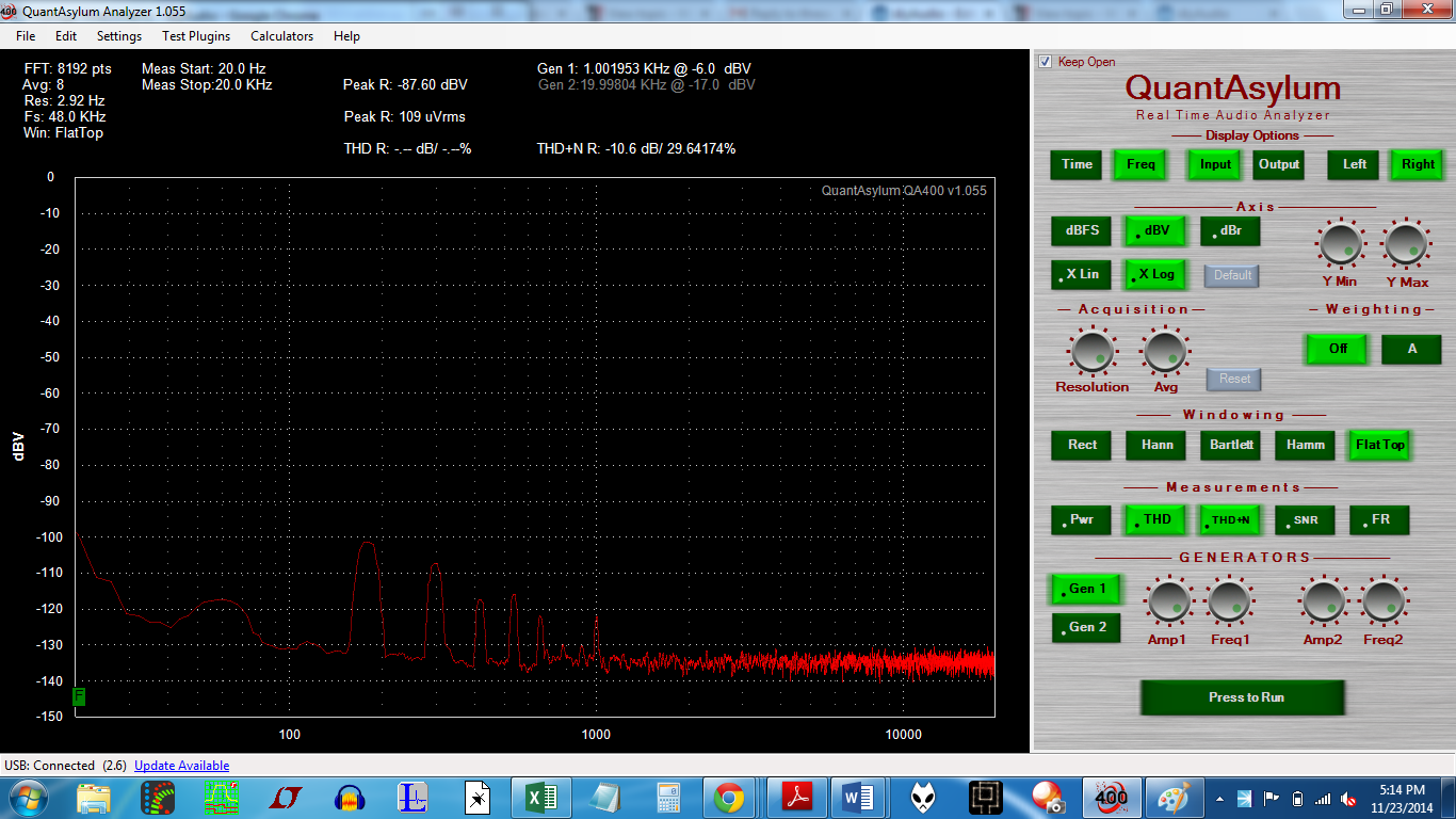

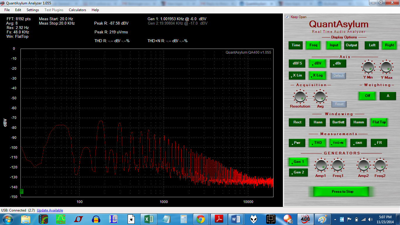

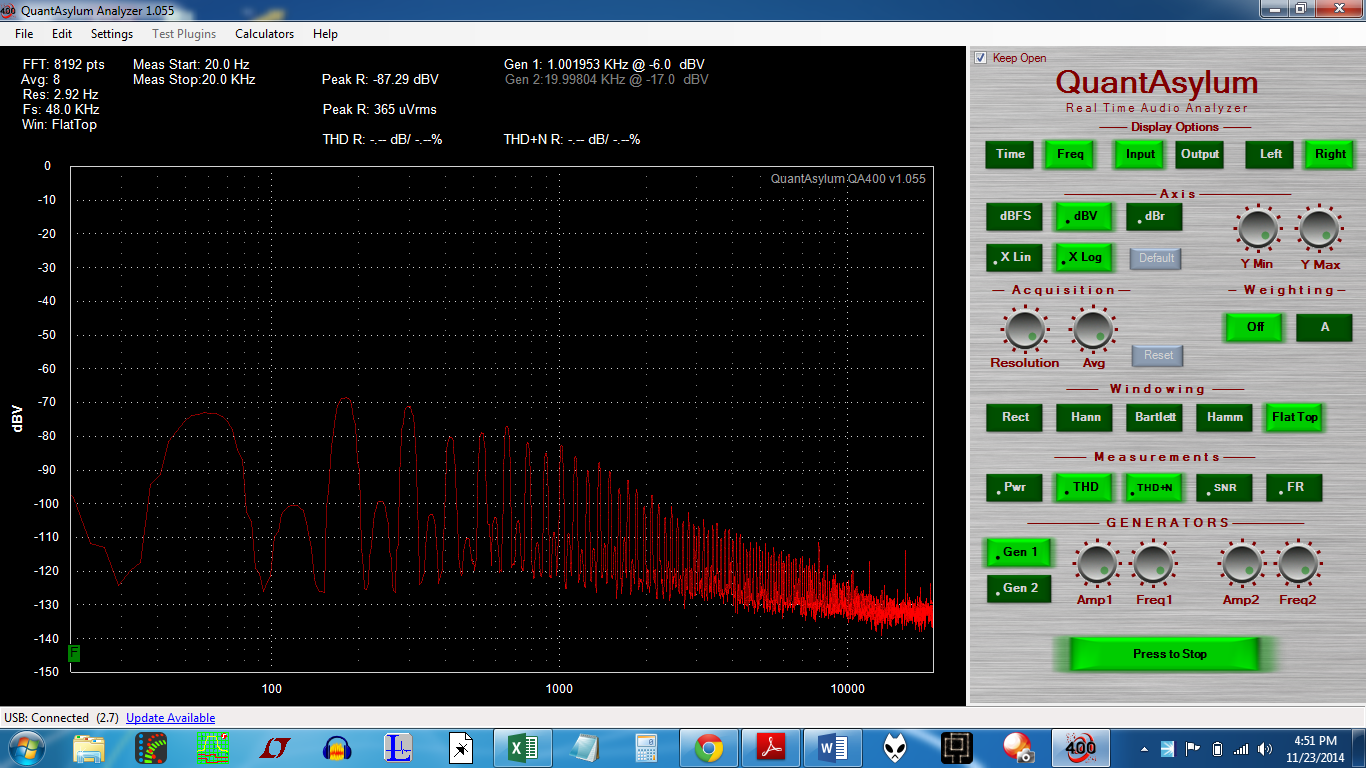

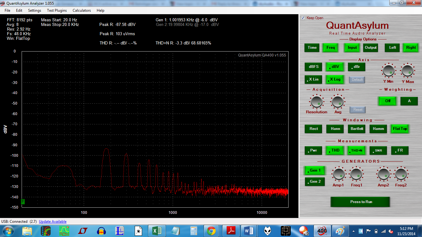

OK four shots with that method, around an 8" file.
First is at the diode bridge at the front of the amp
Second is at the power cord at the back of the amp
Third is across the room at my workbench.
Fourth is in an enamelled steel can
There is no difference when the QA400 is placed in this can.
