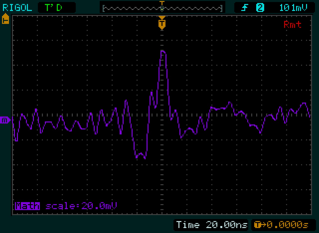

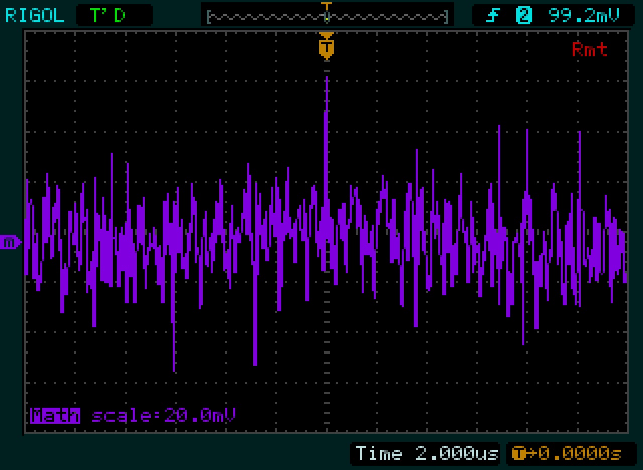

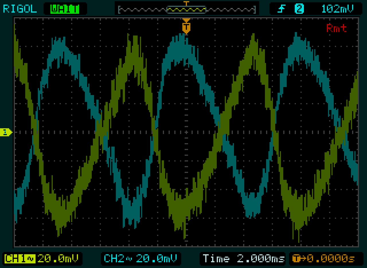

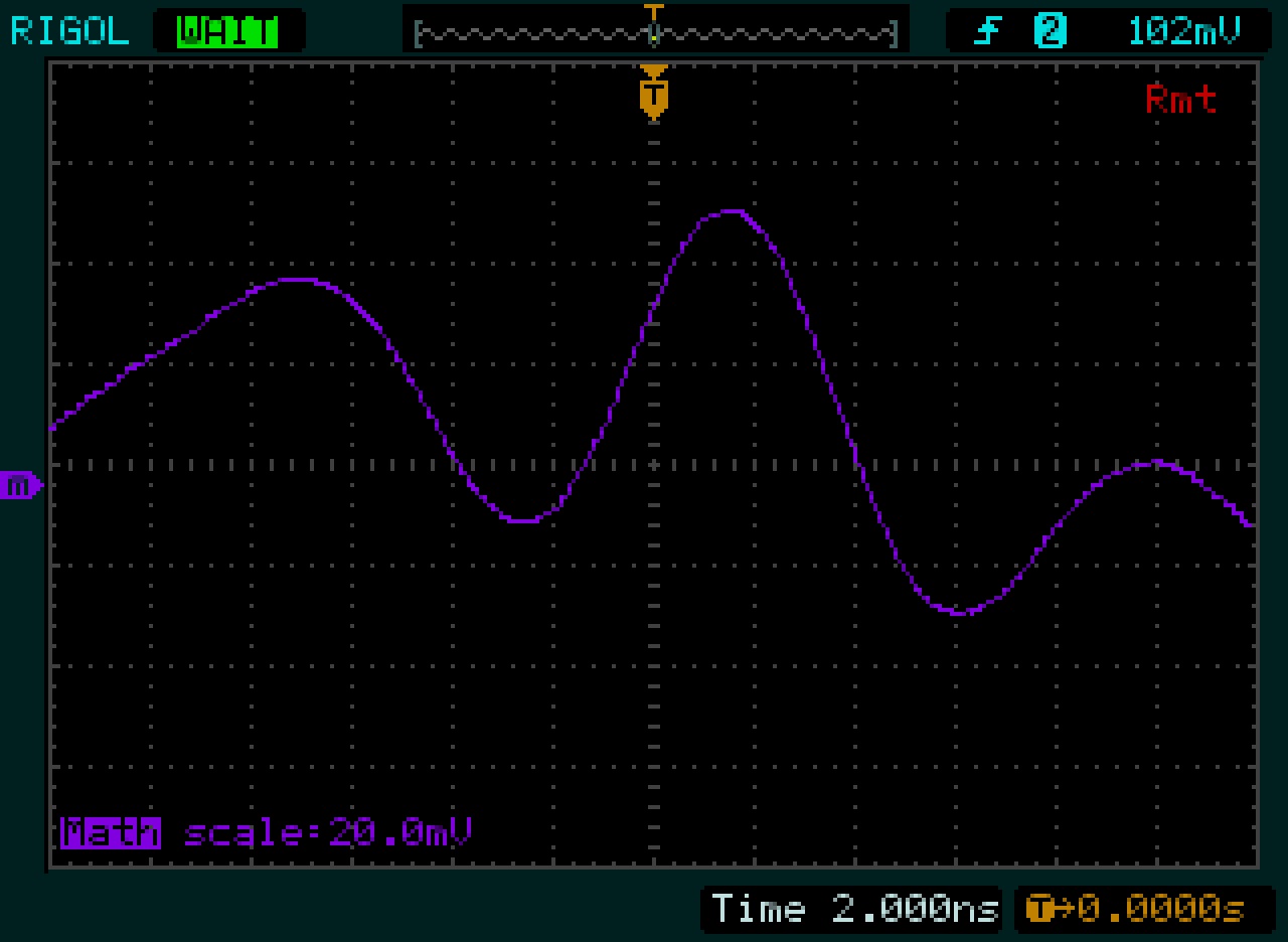

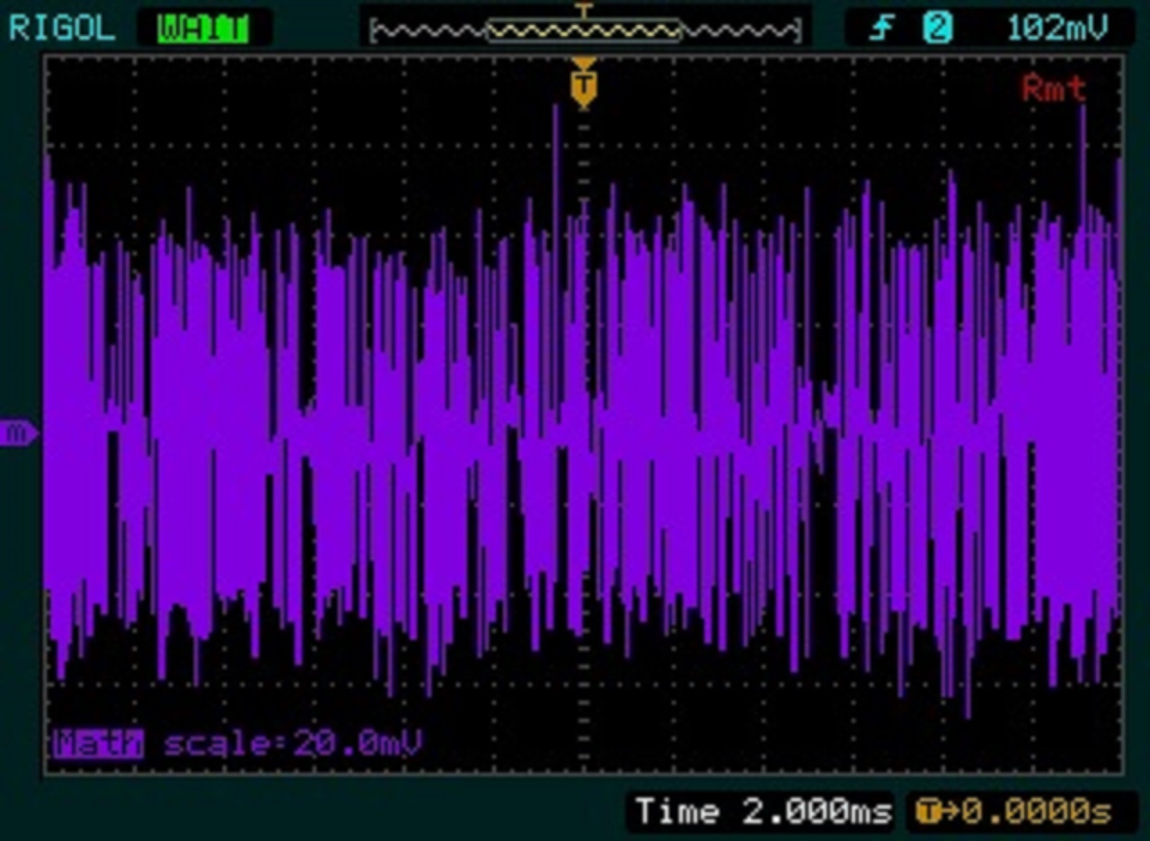

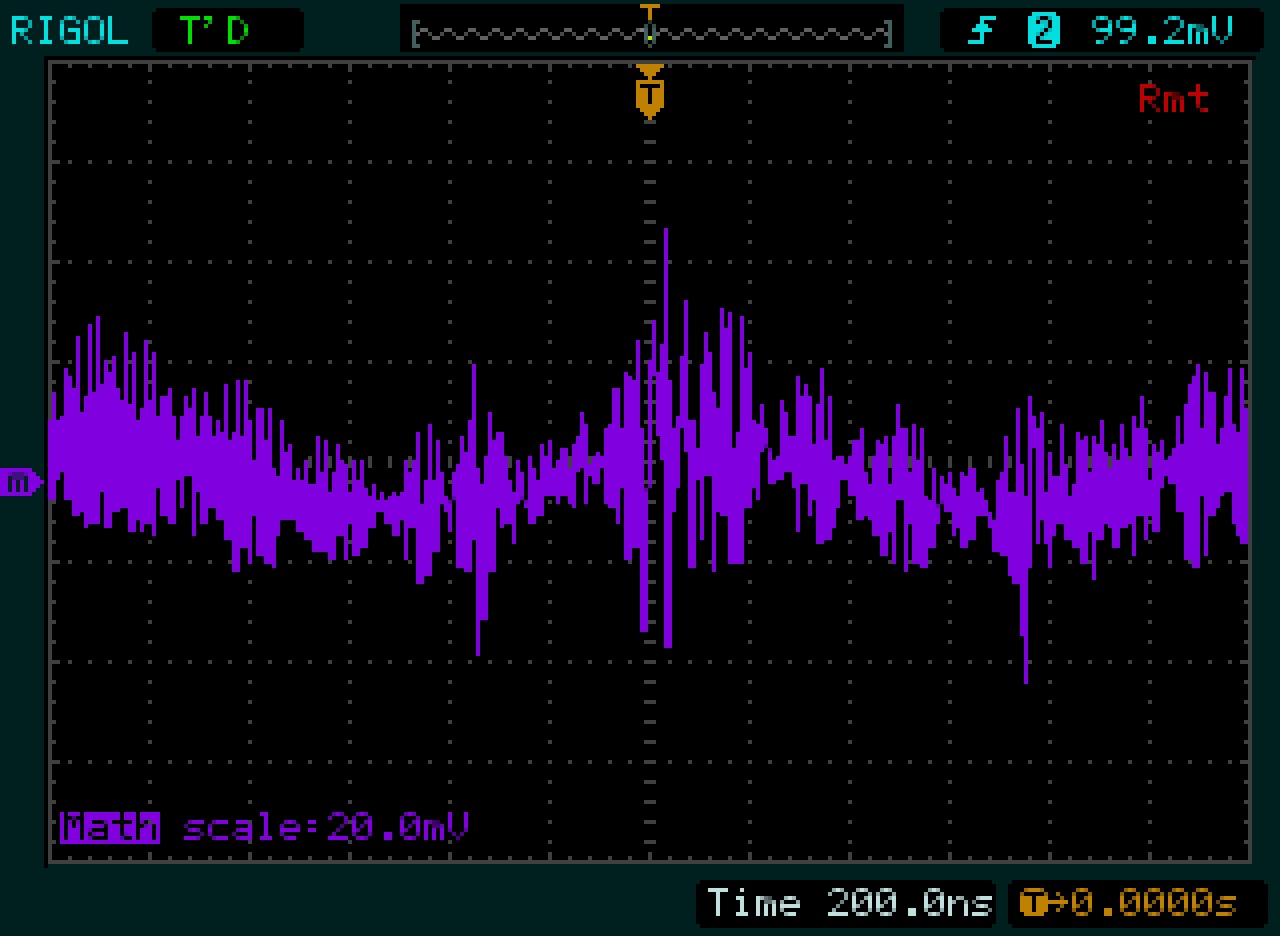

The inputs are shorted. All charts are referenced to speaker output.
All are AC coupled, so any differences in rail voltage are not reported. All vertical scales are 20 mV. time scales of 1 and 2 are 2ms.
1) positive and negative rails
2) math = Pos + Neg
The period of the largest component of rail noise is clearly just over 16 mSec. The period of a 60 Hz wave is 16.67 mSec. So the large excursions of the rail noise are ripple.
It is the noise riding on top of that ripple that is of concern.
3,4,5 etc... different time scales: 2ms, 200ns 20ns, 2ns, 2us
The point here being that it seems that the 20ns screen capture shows the snubbed ringing and decay of the transformer in response to diode operation, though that looks like a period of 60ns or Freq of 1.6 MHz, which was not the expected value. Perhaps the snubber ought to be adjusted?
The 200ns window is periodic, like the main ripple, showing a period of about 1100ns (90 KHz). That is yet another issue.
The first may be due to a lengthy decay of the ringing transformer.... that can be mitigated with an inductor. ie, CLC vs CRC. I do have 4 pieces of 4.5 mH inductors for the job.
The second at higher frequencies may be oscillation. I had added some bypass caps on the output boards, 330 uF at 50V where the "optional" caps are located on the DIY store boards. These are NOT the 1nf anti-oscillation caps. Those are also present. The thinking being these would provide current for shorter duration peaks. They ought to be removed in the even that they are causing the oscillation.
Does that analysis and plan of work seem reasonable? Does it seem best to remove the bypass caps on the output boards first? Is there some other way to rid the oscillation?

All are the same vertical scale. The firs two are taken from the same trigger event, just split into two parts for clarity.
The second image is the two channels summed -- same vertical and horizontal scale as the first image where the channels are shown without summing.
I'm surprised, is 100 t0 120 mVpp differential noise not important? Is that the tail I am chasing?

The noise is in shot two -- the purple mess. Each horizontal dotted line is 20 mV. There is sometimes 100mVpp, but usually about 60 mVpp. The sawtooth amplitude is +/- 60mv... 120mVpp.

EDIT: HOW CAN THERE BE 120mVpp noise in the A + B trace ? In the sober light of day, this makes *no* sense to me at all. For the signal to have that amplitude, you'd need to see evidence of the sawtooth going near zero *all the time*. It does not.
FINALLY! A nice shot of the PS noise. Note the noise is a sensible value. The math scale is 10mv. The ripple scale is 200mV, AC coupled.
OK. That finally is making some sense.

The probes are 10x, they are not referenced to anything -- the GND clips have been removed, so the math function can enable the scope to operate like a differential probe.
The envelope of the noise is 50mVpp, but the actual noise is much lower. I am very keen on seeing what happens when loop area is further reduced. I won't get to it though, due to the holidays.

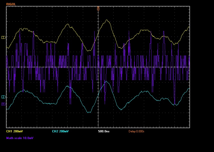

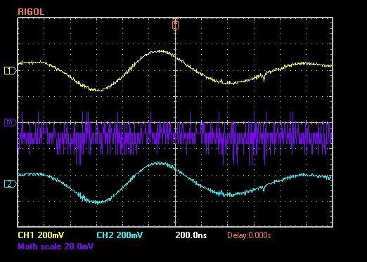

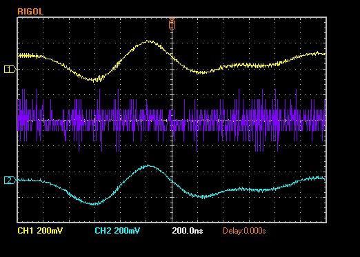

OK NOW, we are cooking:
Two shots, outputs and power supply. different times, as I do not have 4 channels. A 4 channel scope is a darn good idea, but 2 channels are better than nothing.
First shot: output voltages. math scale is 20mv, CH1 and CH2 at 200mV. Scope operating as a differential probe, inputs shorted.
Second shod: PS voltages ( +/- rails ) same scales as first shot.
Even the frequencies are in the same ballpark... in the 940KHz range -- which is near the frequency that Quasimodo suggested that the transformer rings at....
One may suspect that the snubbers at fault?
Regardless, it is clearly PS noise that is riding through to the outputs.

@BigE -- RE the link for cap bypass issues -- please read carefully what Conrad Hoffman has to say in posts 16 and 19 -- Conrad is the real deal and he does know what he's talking about.
I positively think that the actual construction of the cap majorly influences the ESL and ESR, and so it's no accident that ESL goes up dramatically as C increases. I do agree with Conrad about bypassing at the rectifiers and at the amplifiers. Often it is more convenient, if less effective, to bypass at the electrolytics just due to space. As a side note, few audio designers do the stage decoupling of power rails that instrumentation and RF designers have to do -- something to think about...
The OS-CON caps are really good, but getting enough C and enough working voltage is tough -- so we have your big pig electrolytics. They need to be bypassed. BTW, the equation presented in another post for calculating the desired bypass value ignores the other circuit impedances and is not helpful. My two cents.
RE the noise plots. None of this is audible, so what is actually at stake here? Why pursue some RF noise unless it is inter- or cross-modulating the audio is audible ways? BTW -- If you haven't checked the scope for residual input noise, just short your probes together for the differential measurement at your shown math scale and look at the residual noise -- it may be near what you're seeing, don't know -- never used one of the Rigols. BTW, what's the bandwidth of that scope?
I'll check Conrad's stuff more closely, thanks!
The bandwidth of the Rigol is 100MHz. When shorting the probes together and doing the same math, I get a math signal that is about 20mVpp, at 98 MHz.
The amp noise is at 940KHz.
So it is safe to say then, that the actual noise displayed at the amp is not 40mvpp, but only 20 mVpp? ie, 10mV peak or 7mVrms? This appears very acceptable.
An interesting test would be to install those bypass caps. Does this pose any danger to the amp?
I know AndrewT suggests to only install caps *with resistors* as snubbers. At first glance, it appears that I use the same snubber values as I did on the transformer, just at the output of the power supply.....Or, they can be recalculated, given the frequency of the noise.
Another test that I think would certainly prove that the transformer is responsible for the noise that is being detected is to change the R in the power supply for an L, and make it CCLCC instead of CCRCC. This would be the sledgehammer approach.
Anyway, nothing will be happening to the amp until the New Year.
THANKS to everyone for their help on this project. I *REALLY* do appreciate it.
