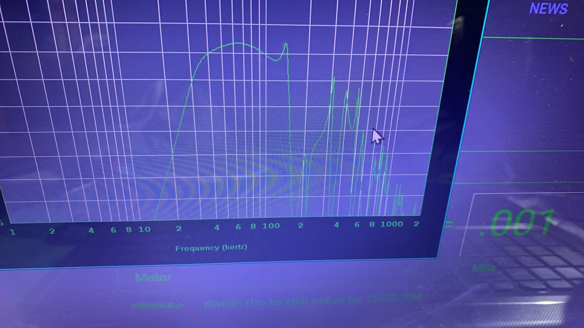

Big, big TL...

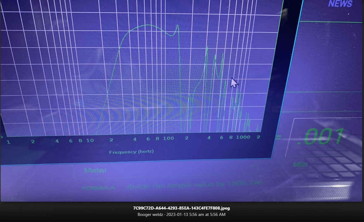

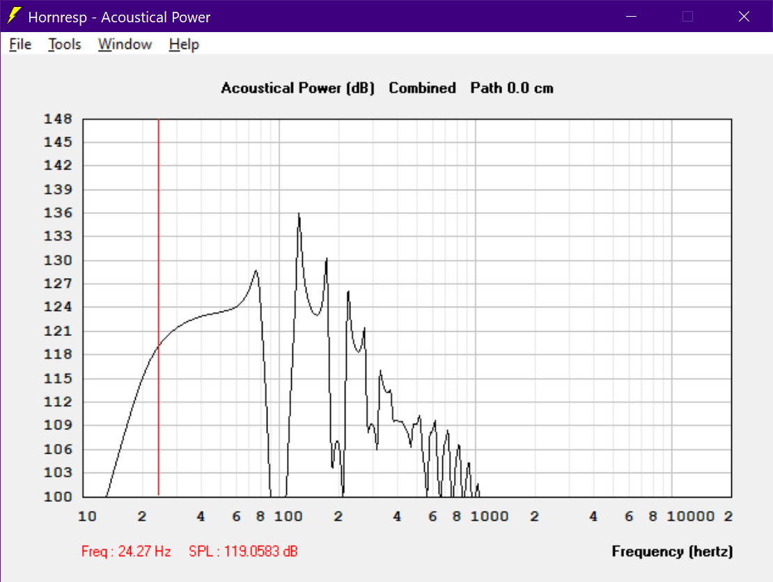

Wtf? So it's not the published graph? The one they show don't have that disturbance in the force 🤣

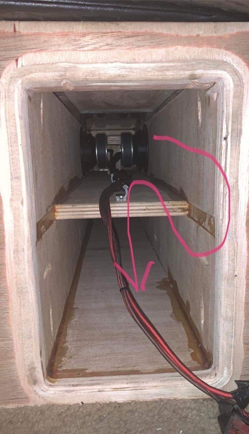

If you build these another way there’s none of that funk those exihibit. The same area that the little 3Fb overlap is made ‘optimal’ in the offset driver transmission line too. I’m always concerned with it in either because I understand how bad it made the 3 Paraflex I built ??

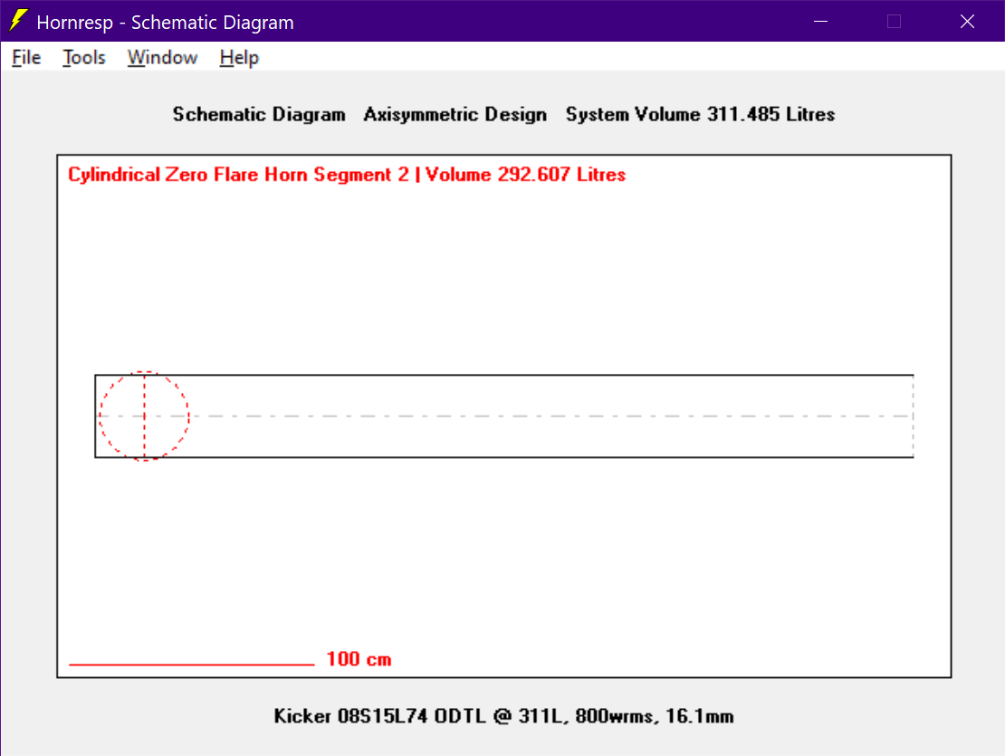

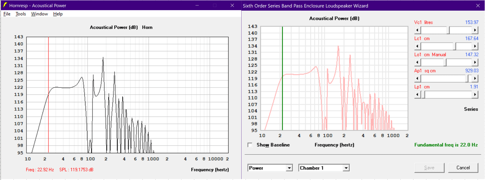

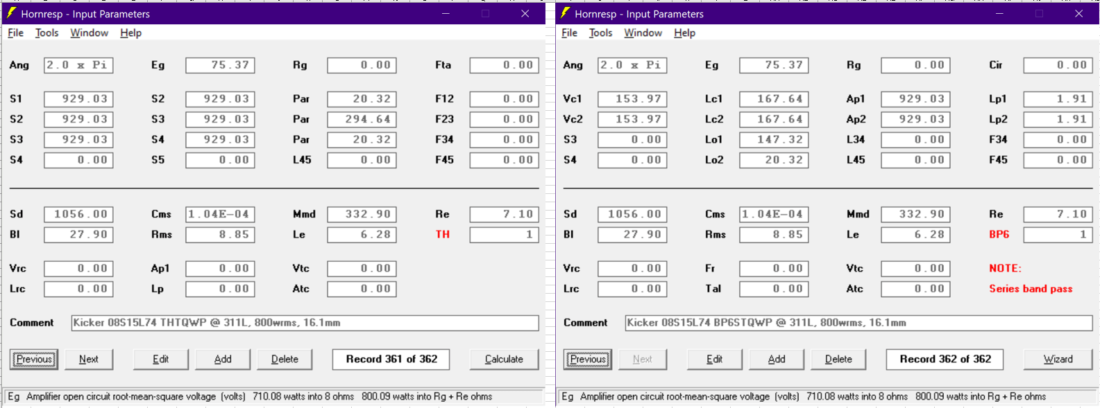

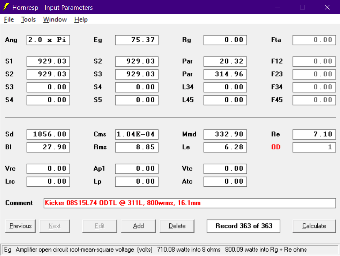

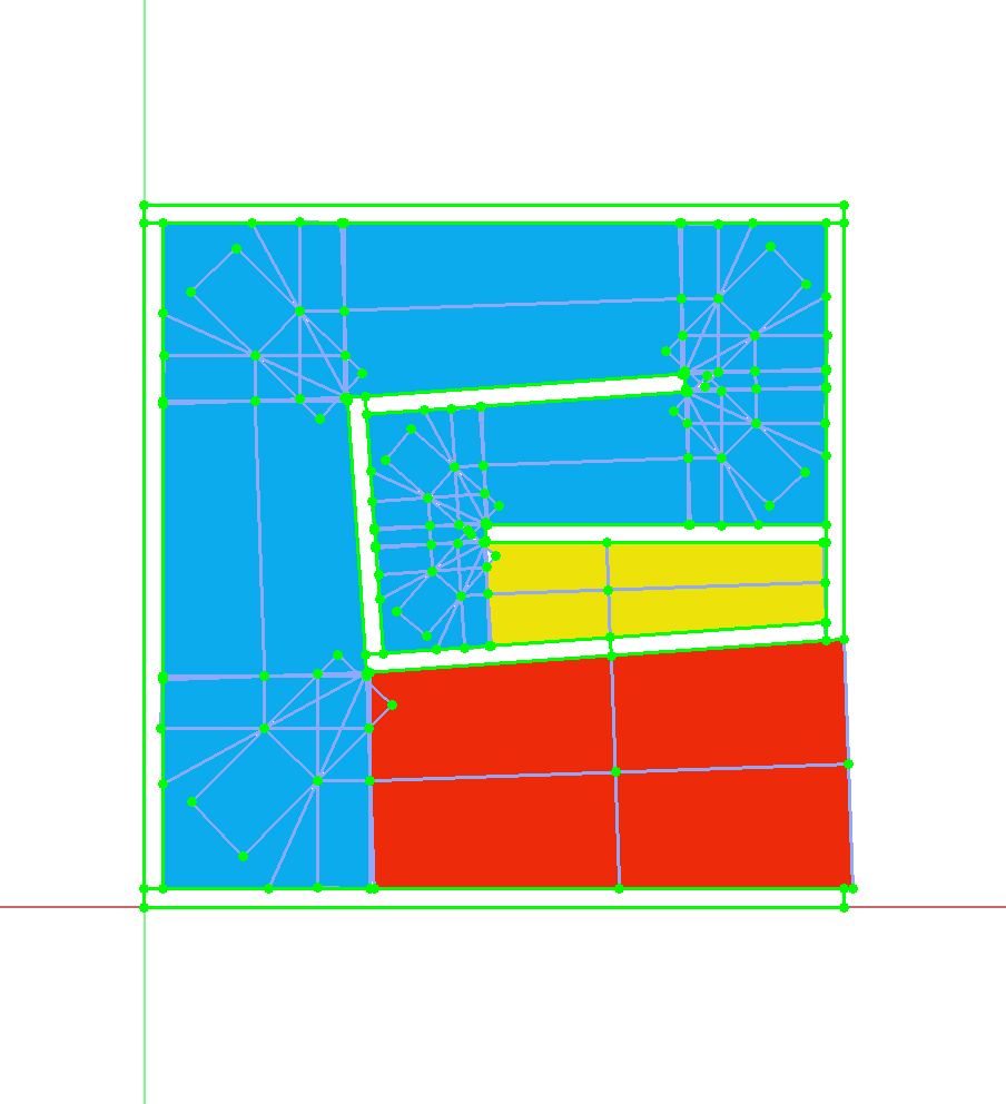

TH, BP6S, and ODTL are the SAME!
Brian Steele is right, ODTL is the way to go when it comes to speaker mounting and modeling.
I think the TH and BP6S will sound better since the speaker is hidden in the enclosure.
TH and BP6S have better speaker protection.
Its like saying: all squares are rectangles but not all rectangles are square. Square is a special case of rectangle when all sides are equal.
So TH looks like a special case of BP6S, when you basically the front chamber and the front port has the same cross section area and the second chamber has no port or you can say the port also has the same cross section area of the chamber but the length is 0.

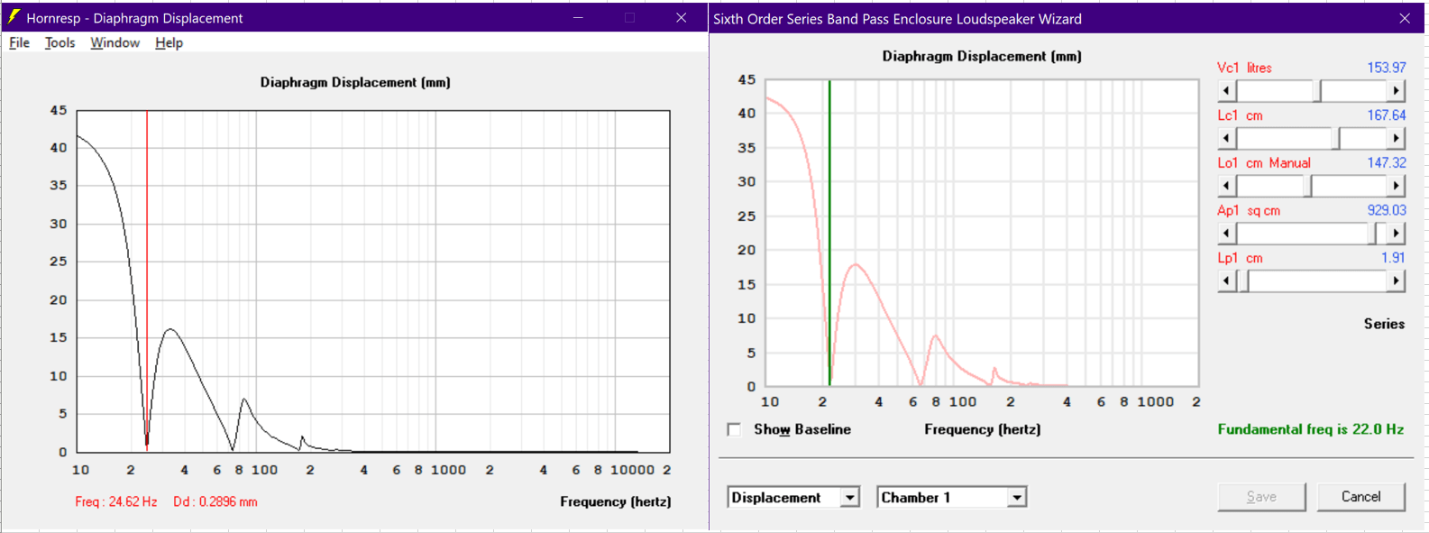

You can play around with model but the result will be same.
See attached illustration.
The front chamber (yellow) is serial connected to the port (blue) witch is serial connected to the rear chamber (red) witch has no port.
front and rear chamber share the same driver. So TH and BP6S are equivalent in this case.
They can be flared or not, it doesn't matter.

Ok let me rephrase , what is the design that squeeze up to the last drop of SPL. For any given driver.
Assuming TS parameters that dont ‘suck’ , then A 3:1 folded parallel qw pipe with exactly the 3:1 resonators length ratio to the same exit. Not much else to be done with closed end pipes (1/4,3/4,5/4 resonances) and ‘SPL’ Unless you want a one or two note(spike at resonance with nasty ‘Q’ ) blunder (poorly sized results in a whistle or ringing or 1,3,5…..x the Fb spikes ?)
unless you screw it up with random folding and resonator length that don’t arrive together ) at an exit that sits on the odd harmonic interval (3:1) , it’s potent and clean. It seems to be the ‘loudest’ and widest’ BW of them all for a reason
