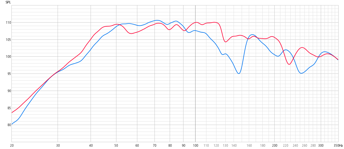

As I expected, the ODTL alignment is much better for mid-bass transition than a TH, as there are no wild phase and output variations to deal with in the 100 Hz ~ 200 Hz region. See image below for example (POC3 TH and POC7 ODTL driven with 200Hz 6dB LP filter and main speakers driven full range, i.e. a cheap 2.1 system). Look what's happening in the 100 Hz - 200 Hz mid-bass transition region. The ODTL (red curve) stomps all over the TH (blue curve). Note that this wasn't an accurate FR measurement - just one to show the difference in performance between the two setups. The TH does produce a bit more bass at lower frequencies, but it's a larger box and the 100 Hz - 200 Hz region is a bit of a mess. Yes, you can reduce the mess by using sharper cutoff slopes on the TH and the tops, but sharper filters can introduce issues of their own.

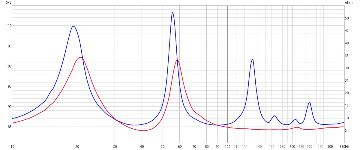

The image below shows how the impedance curve of an ODTL varies compared to a TH. Note that there are no variations in the 100 Hz to 200 Hz region in the ODTL's curve (red). Another sign that there aren't going to be any phase issues in this crossover region to deal with.

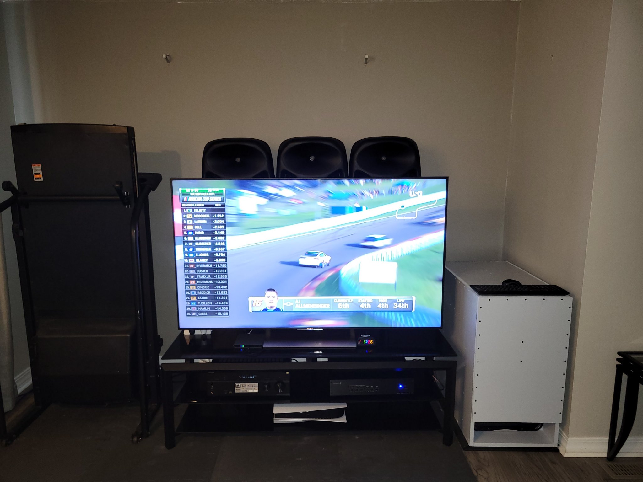

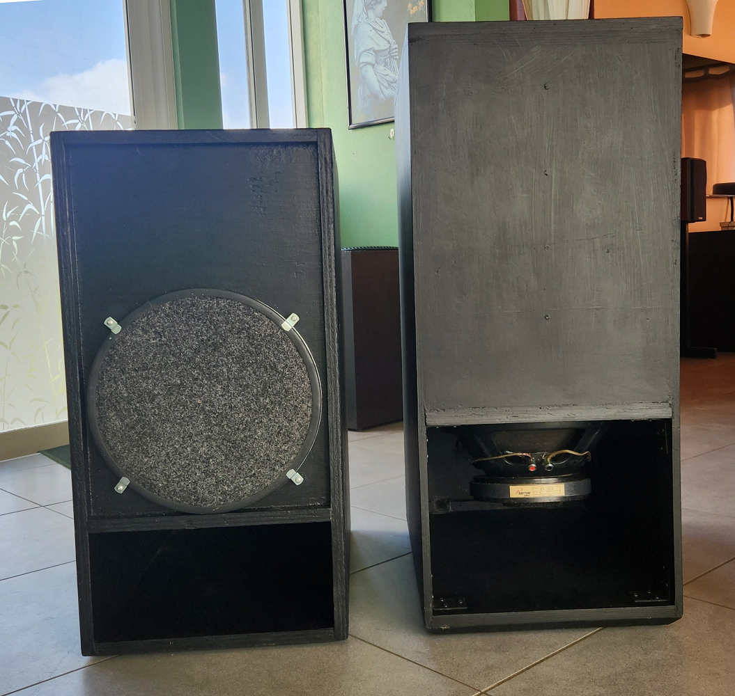

Here's a picture of POC7 next to POC3. POC7 is slightly deeper, by about 1/2" or so. But it's noticeably shorter. The width of both speakers is about the same. I've added an old speaker grille from a car audio build that I did years ago to protect the driver's cone, until I come up with something more elegant. Note to self - I need to make the rebate around the driver baffle a bit deeper because the combination of the driver mounting flange and the grille is definitely more than 0.75". And yes, the carpet-covered grill does affect the output a little, but not by much.

...and here's what the carpet-covered grille does to the output...
Some background history - years ago (1996), before I had access to any real measuring equipment, I did a car audio build where the subwoofer was a fiberglass enclosure in the spare tire well that hosted two JBL 1200GTs that was vented to 35 Hz (as per JBL's specifications). The floor of the car's trunk was raised about three or four inches to accommodate the enclosure and the amplifiers that were mounted on the sides, below dress panels to make the whole install very stealth. However, the cones of the two 12" drivers were distinctly visible and unprotected, so my "hack" to address this was to cover some metal grilles with matching carpet and use those to protect the drivers. I figured that if bass could make it all the way through the rear seat in my sedan, a layer of carpet on the grille certainly wasn't going to stop it. And the result sounded pretty good.
Well, I found one of those old grilles when I was looking around in storage for a way to protect the driver in POC7, so I mounted it up and then took some measurements with DATS and REW. The measurements show a drop in the impedance peaks (likely due to lowered Qms), a minor drop in driver response above Fb and a slightly increased drop in driver output below Fb. That it damps driver motion below Fb might actually be an advantage 🙂.

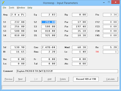

POC#3 Hornresp data:
POC3 is 22" x 33.5" x 14.5" (I added 0.75" ply to the top and bottom of the TH to give it a bit more strength and reduce panel flex). The maximum size I can work with is 22" x 38" x 14.5", which basically limits me to 12" drivers.
