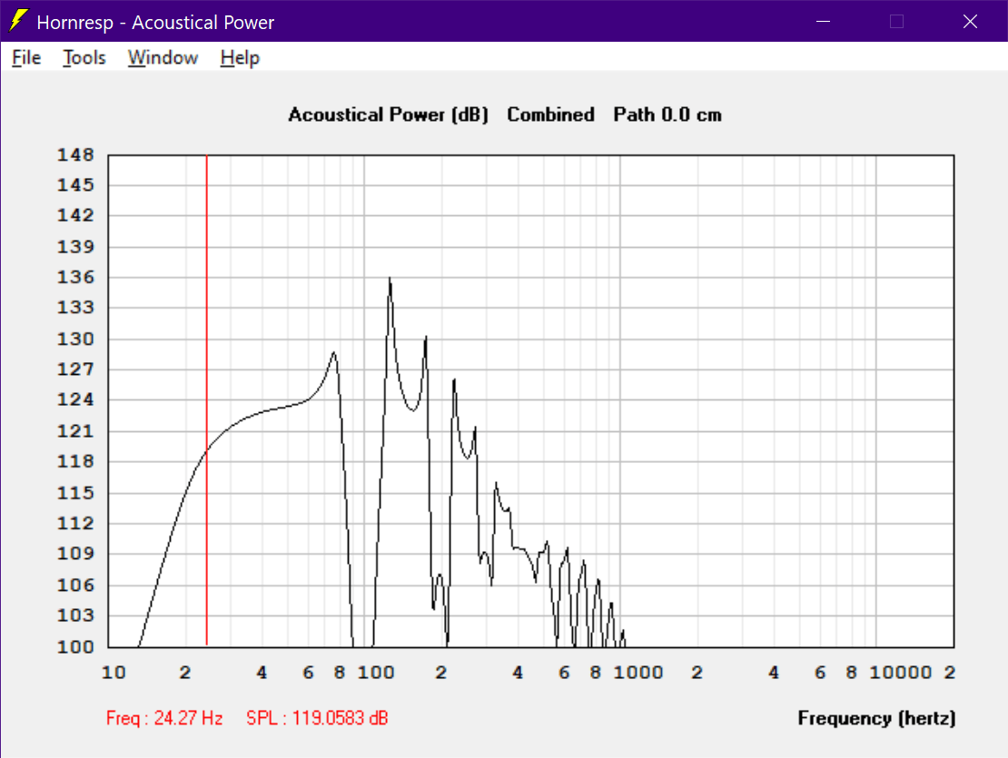

That alignment actually looks a bit undersized. Increase the CSA of the TL and that should increase the gain around Fb, flattening the response down to Fb.
This is something I probably wouldn't build though because of that massive cancellation @100 Hz, but if you're looking for pure SPL (i.e. a "bass whistle"), this would be the way to go... 🙂

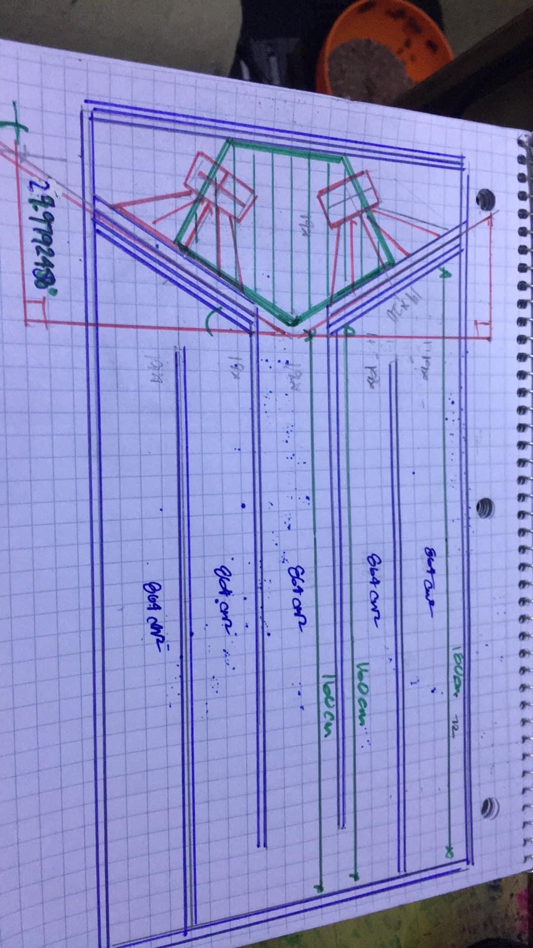

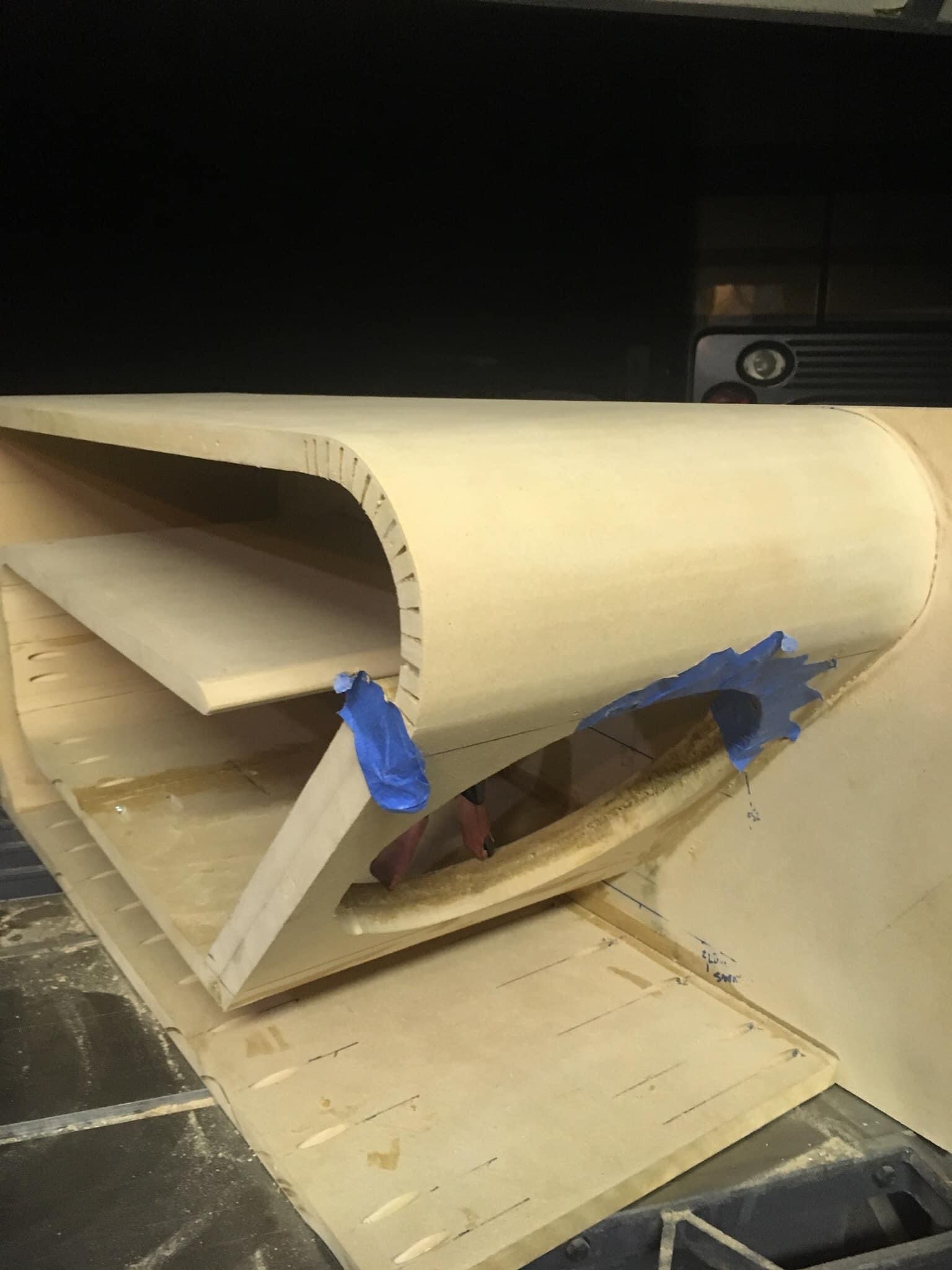

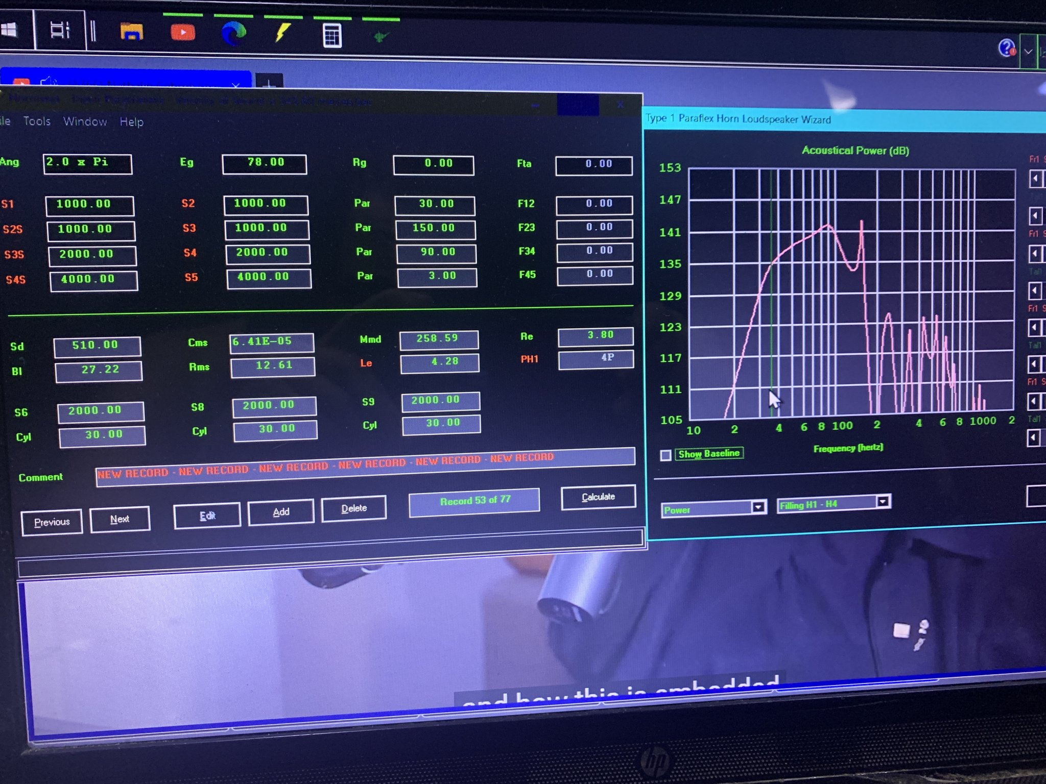

Your 4 skar ddx box (aligned) free of the phase discontinuity issue in paraflex models’ .
This is loud and wide by any measure. (I just used 15mm excursion to limit this for example) . it’s ~36” long and ~16” tall…. and wide …
so split into two boxes or Whatever ‘portable’ needs to be. But there’s ‘better’ drivers than that skar? It’s only $145 shipped in USA so it’s hard to argue for making ‘spl‘ noise 😀

Some questions , I read somewhere that the sensitivity don't matter much for some designs (can't remember ) so the skar ddx12 is rated at 88db sensitivity , it's ok?
What you mean by aligned? To tweak the driver position or change dimensions ?

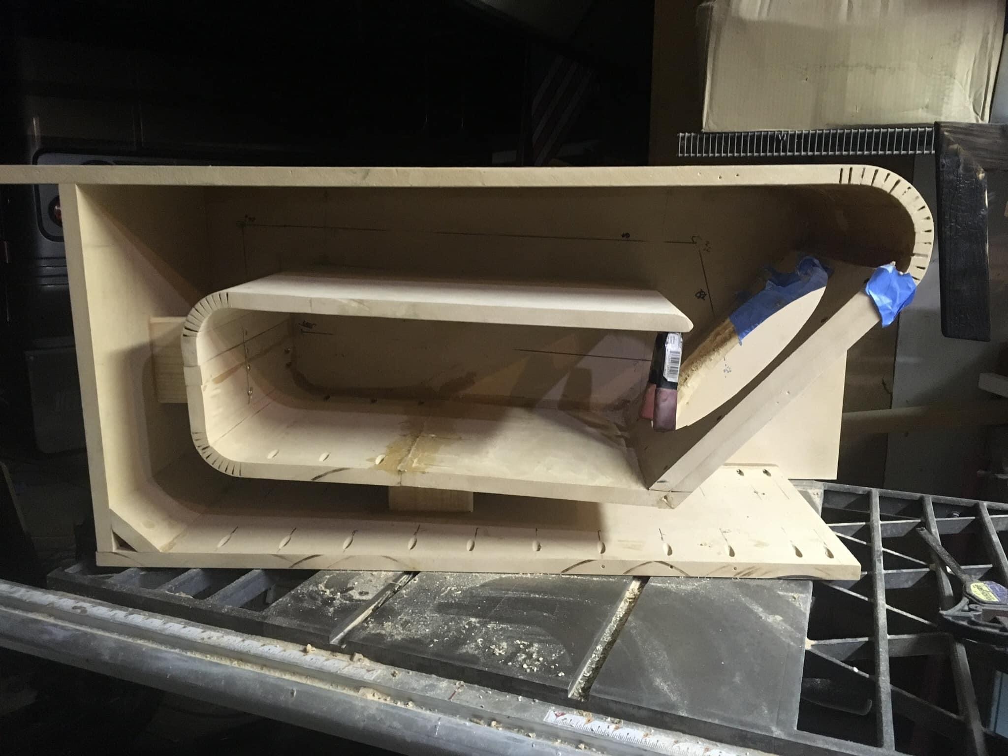

For the best compromise, I think the best type for PA use is probably the tapped-horn (TH). Size is larger than sealed or vented, but "portability" is more about just size - form factor is also important, and a TH can be designed to be a rectangular box that you can tip and wheel around, making it easier to move.
THs also have another advantage - the driver is not fully enclosed in the cabinet (but enclosed enough to reduce physical damage from an errant hand or foot), and it's located in the mouth, which likely improves heat dissipation at high volume levels (e.g. at Fb, when coil movement is at a minimum and the coil is dissipating the most heat, air movement in the mouth is at a maximum). The mouth of the TH is also large enough to significantly reduce compression effects at high power levels. Disadvantage? Usually bandwidth-limited to below 100 Hz, integration with tops might be a bit of a challenge if you don't have decent DSP, and best used with drivers that don't suffer from motor noise.

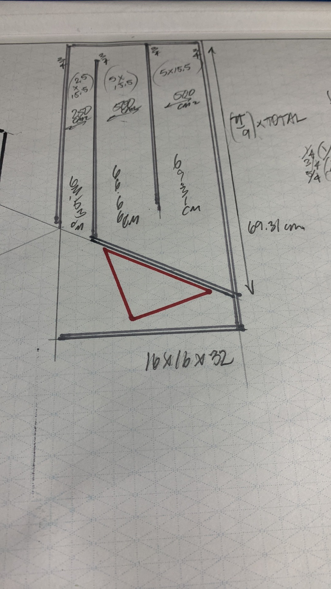

It be careful of the port sizing….as mentioned

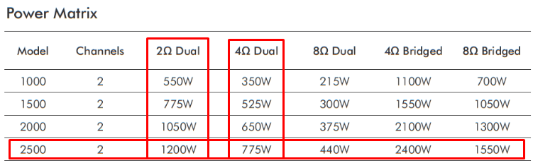

1200W @2ohms per channel (2 channels)
Class D
So in my case 3 units of 3015LF per channel or just 2 per channel
That meana 3 cabinets per amp channel or 2
Per channel depending to what voltage I will limit the 3015LF
So I need to get the most SPL of that modest power source.

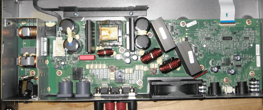

Curious also since I'm a long time fan/early adopter of dbx electronics, though Rick McInnis chose to use whatever brand DSL uses for their speaker systems for his DIY MEH system.
BSS are hell expensive , there is another brand i don't recall now that have FIR processing but almost all pro brands (nexo,Meyer,RCF,Adamson,HK audio,dB technologies,DSL ) to name a few have their own branded processors.
There is guys that swear by the Ashley protea processors.
Thing is that according to some lab tests the more expensive units have superior AD/DA chipsets with oversampling and a lot of mumbo jumbo digital tech plus discreet analog stages with premium caps and resistors (audiophile grade) plus the FIR processing and related high end filtering.
And again if I got the money to get that...why bother to make my own if I can get 8 touring racks loaded with state of the art FIR and lab gruppen latest digital amps with 40 linear cabinets per side and 30 subs per side. From MEYER

First, you need to choose the box design, learn how to model in hornresp, check your amplifier max voltage output for each impedance, in general the max voltage reduces if you lower the impedance because the current will increase, if it don't indicate the max voltage, you can estimate it based on your max power output for as specific impedance. So you will use two voltages in the simulation with hornresp:
Pay attention regarding the standard the OEM used to specify the power, in general Class D indicate max peak power per channel, while Class AB indicates Max power output for senoidal signal (3dB crest Factor) so peak max output needs to be multiplied for 2.
2,83V for 8ohm driver and the second value according to your amplifier max output voltage for 8ohm impedance. You should compare driver+box options under those two conditions for a practical purpose.

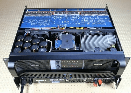

below is the manufacturer published specs for the amp, but i do not trust it 100 as the internals are kind of scarce compared to the powersoft or labgrupen look alikes.
VS
the look alikes

This is not simple as you think mainly because of Burst signal, the the amount of time a peak power is sustained is very short. While class AB is simple to measure it using a multimeter/voltmeter, Class D is a bit more complicate.
It's safer to trust in the datasheet indication with some margin at lower impedance, but 8ohn is OK.
