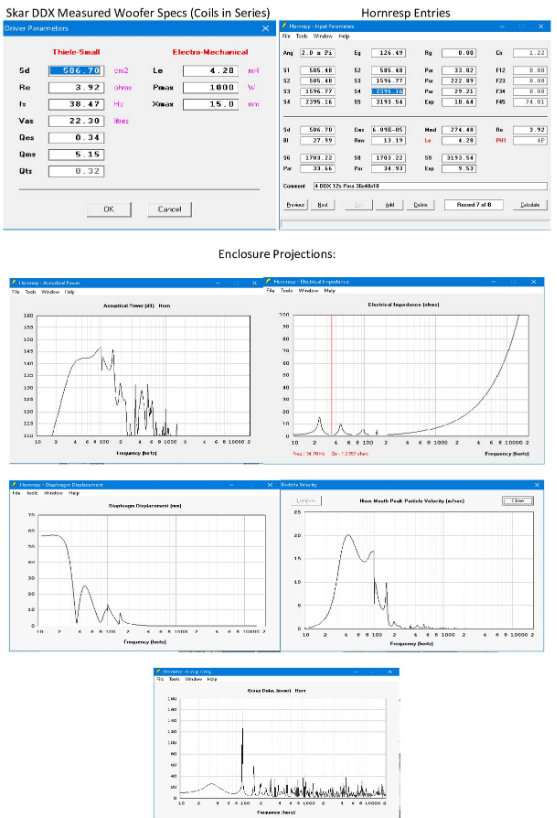

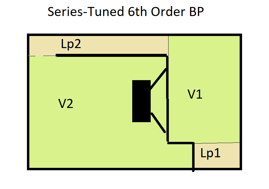

This is what is distracting me at the moment - a possible 6th order series-tuned bandpass alignment for the same driver. I figured out a way to lay out one that comes fairly close to a corresponding Hornresp sim. I haven't "tested" how well the Hornresp bandpass sims match corresponding builds, which is the main reason this is tempting me.So your last calculation is the one you will build?
Hello Brian,
I think it simulates the same way as the BPS1 below
https://freeloudspeakerplan.rf.gd/pages/bp6s1.htm
It's a serial connection anyway, and driver placement regarding the ducts are similar so the offset to position the driver doesn't look a problem.

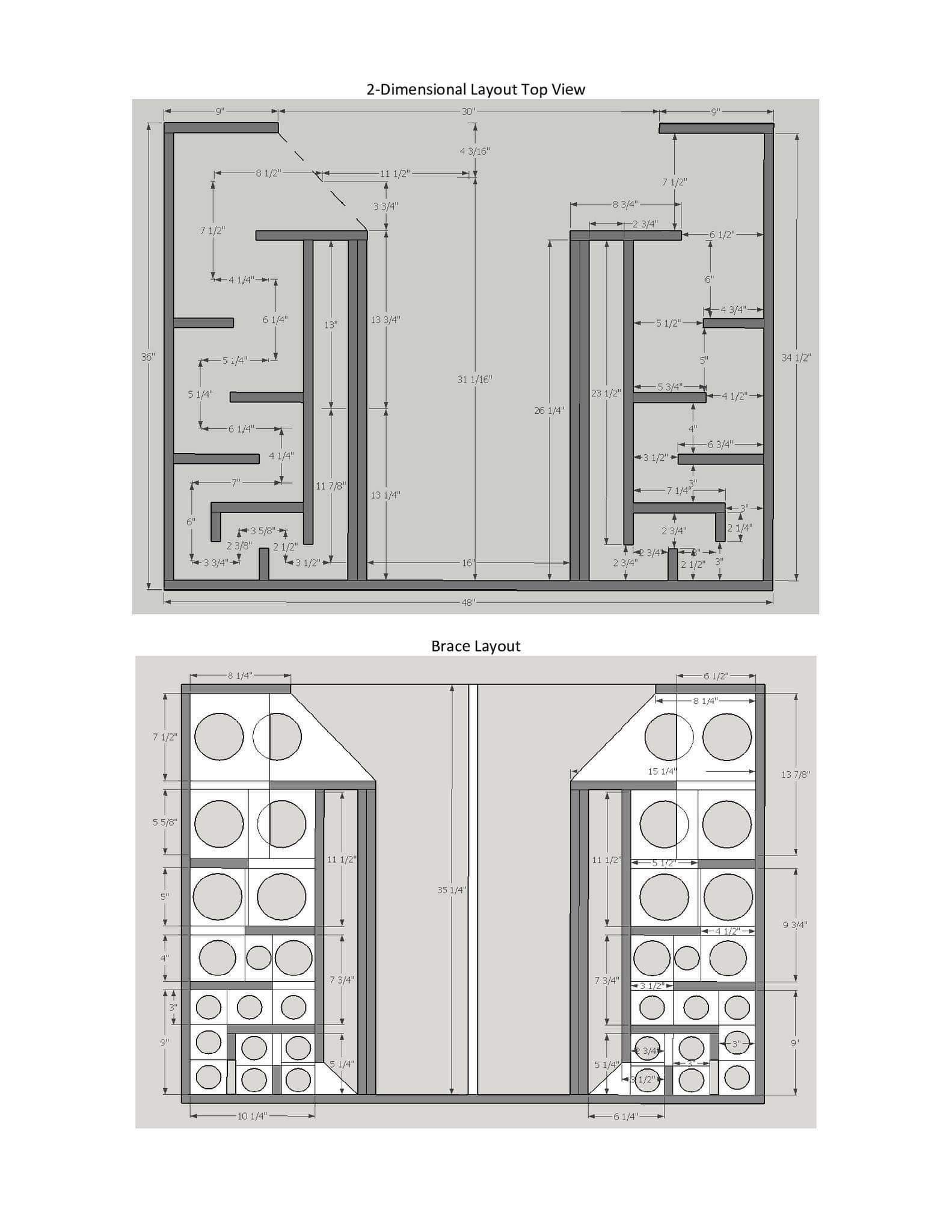

If I’m not spot on with this little formula, I use to create the parallel qw versions(3:1 plus identical offsets ) , It immediately shows me a red flag of a phase discontinuity In the simulation tools(HR)
This is confusing me ? How’s it even possible to get those two acoustical lengths to line up to an odd harmonic(3Fb) … so its not terrible and without a smooth uninterrupted band with that doesn’t have a huge hiccup in it In the pressure phase discontinuity and cone flip flop? Some of the cancellation is left over some of the spike is that over excited and 1 million different things happen this area that are really bizarre if you listen to it.
an awkward, expanding path and a very large rear chamber. That’s far too short and really wide, and will have an akward ‘Q’ in the area bandwith that’s already gonna be weird as well.?
im stumped?
im stumped?

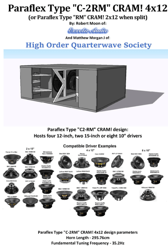

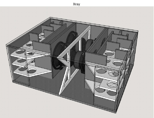

In the center opposed to each other (4 of them) . this is a ‘paraflex design, not mine

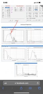

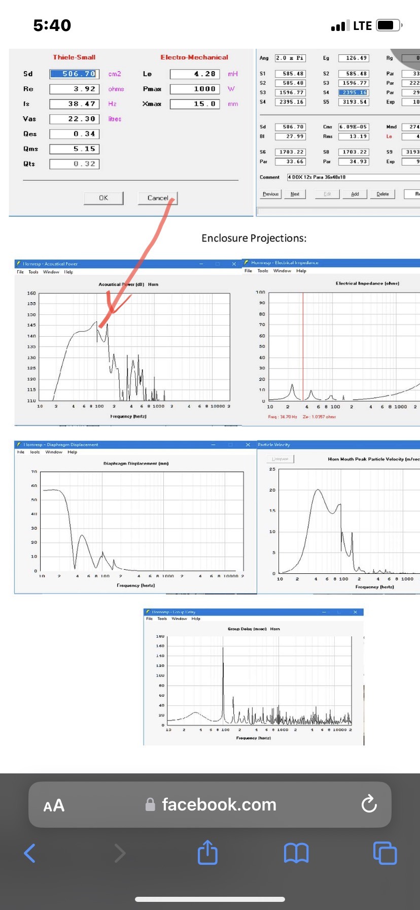

Wtf? So it's not the published graph? The one they show don't have that disturbance in the force 🤣
ok it was this one
and yes the graph looks strange but i think is what it is with that driver
thing is that maybe that strange look on the graph will be not noticeable
