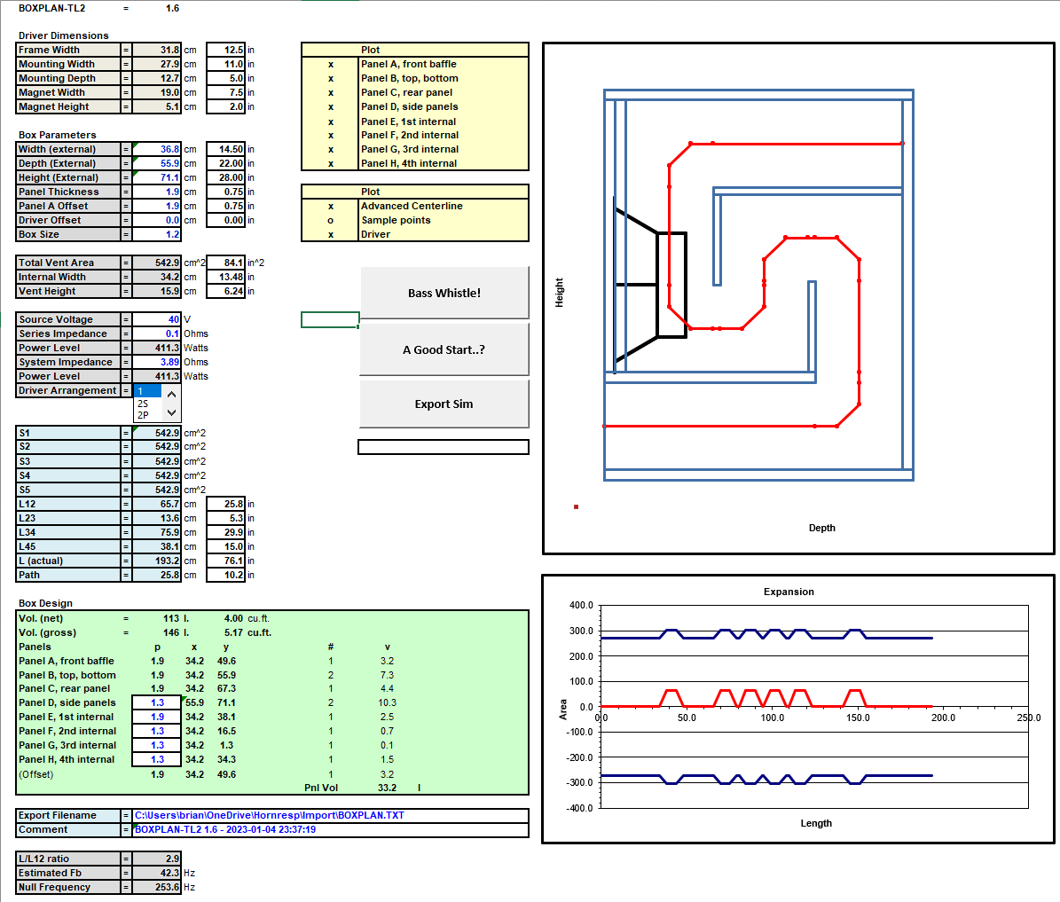

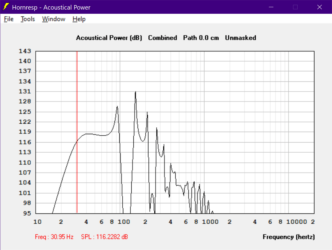

Another minor update - I noticed a minor calculation error in the workbook that was causing it to incorrectly calculate the CSA in one section of the horn. I've addressed that in v1.6 of the workbook. I've included an expansion profile graph in the workbook so such errors can be more quickly identified in the future.

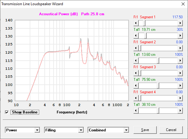

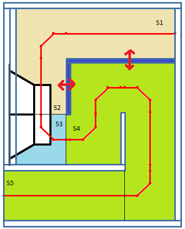

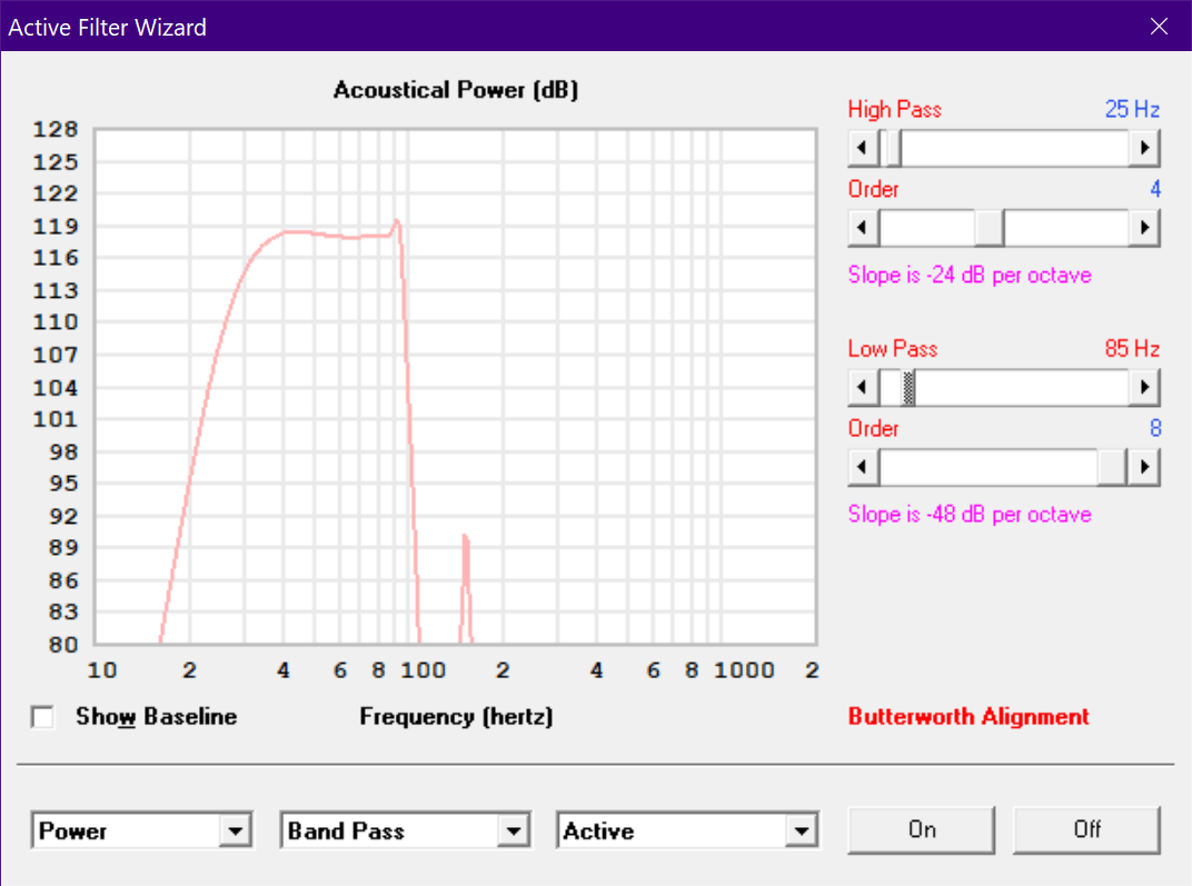

Putting the driver right at the bottom of the front panel does not completely eliminate the "blip" around 120 Hz, as can be seen in the Hornresp sim. The driver needs to be located further down the path to completely null out the 3rd harmonic and thereby flatten the response around 120 Hz. And I have an idea of how I might be able to accomplish that - by changing the design from a straight TL to a segmented one with slightly different CSAs for S1-S2 and S4-S5. I think this can be accomplished by shifting the panels highlighted below. I'm going to modify the workbook accordingly in the next day or two to see if that actually works. Yes, the picture shows S2 and S3 right on top of each other because of the location of the driver in this particular layout. S2 goes through the center of the driver and S3 is located at the bottom of indicated panel.
Yes, yes, I know it's a bit of lily-guiding, but if it can be done, why not do it? 🙂

I don't mind the blip as I HP at 100

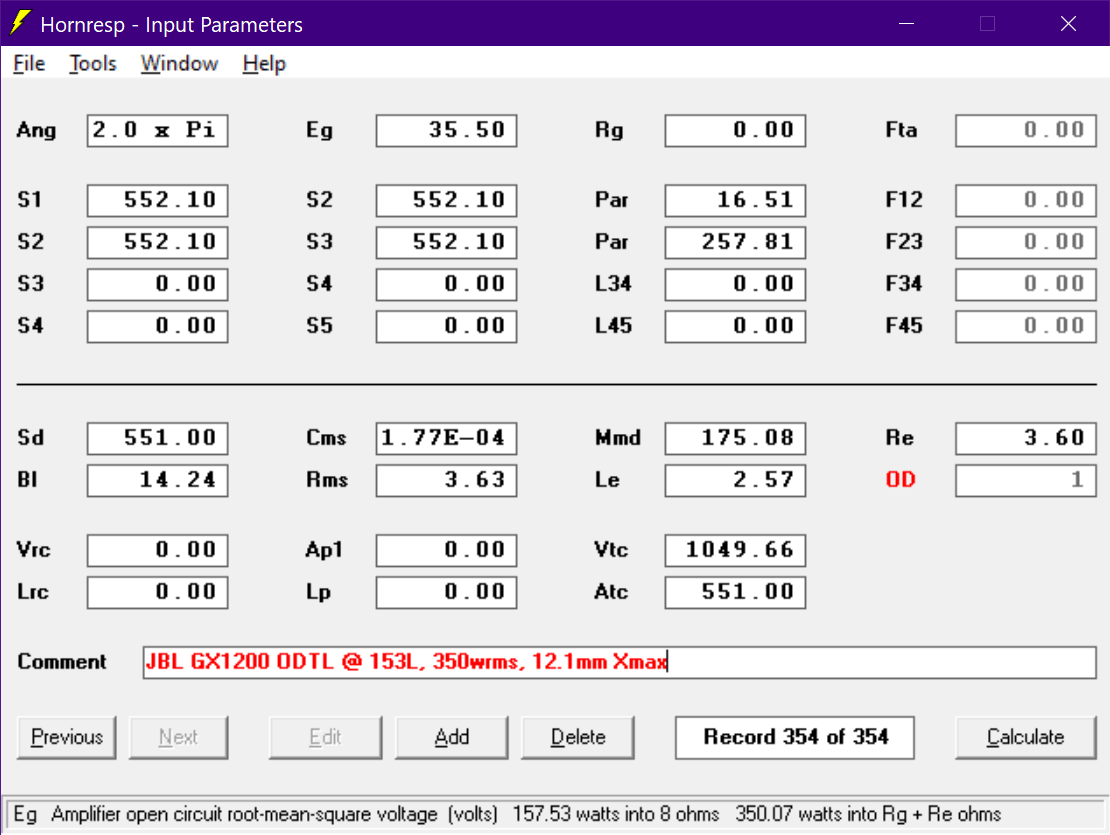

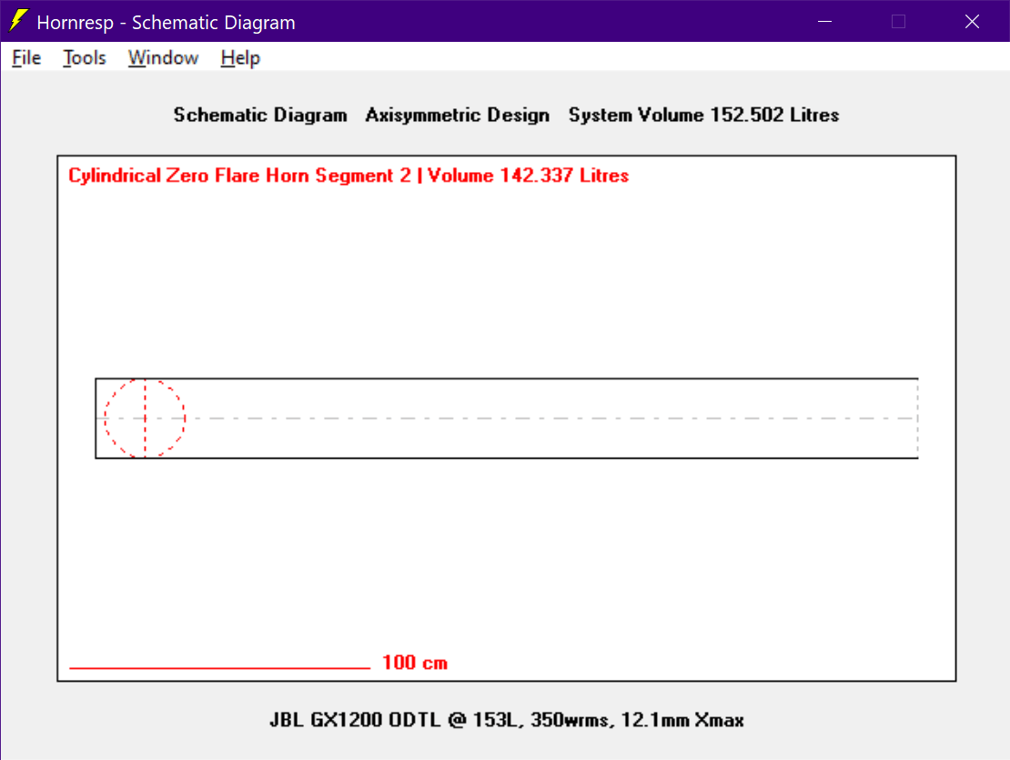

I tried the 201.1cm length with the JBL GX1200 and there is too big of a hump in the response. Here's a 9 footer.
