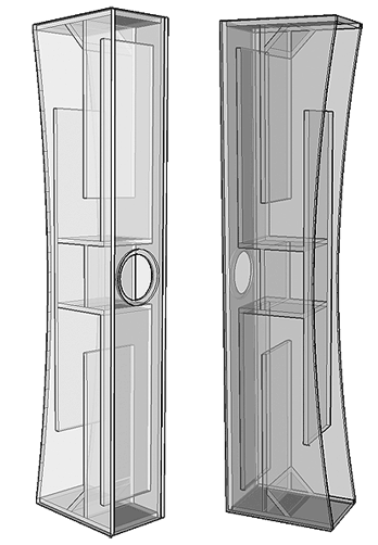

Lol,yeah I saw more than 2 dozen designs/drawings over thereTry Brian’s design sized for the ddx12. I think you might enjoy the sound more than the high order approach’s akward , further misaligned resonators (?) nobody(Robert Moon) seems to wanna build things to hear this and compare or hear the issues in a boundary condition. They just wanna sim And draw pics all day and confuse us all😝
that paraflex box isnt aligned to an odd harmoinc and has a far greater discontinuity/pressure phase quirk then the OD MLTL Brian presented has in 3 simple folds (or the corkscrew mayve) it seems. Sim this to observe the discontinuity potential . it is quite simple

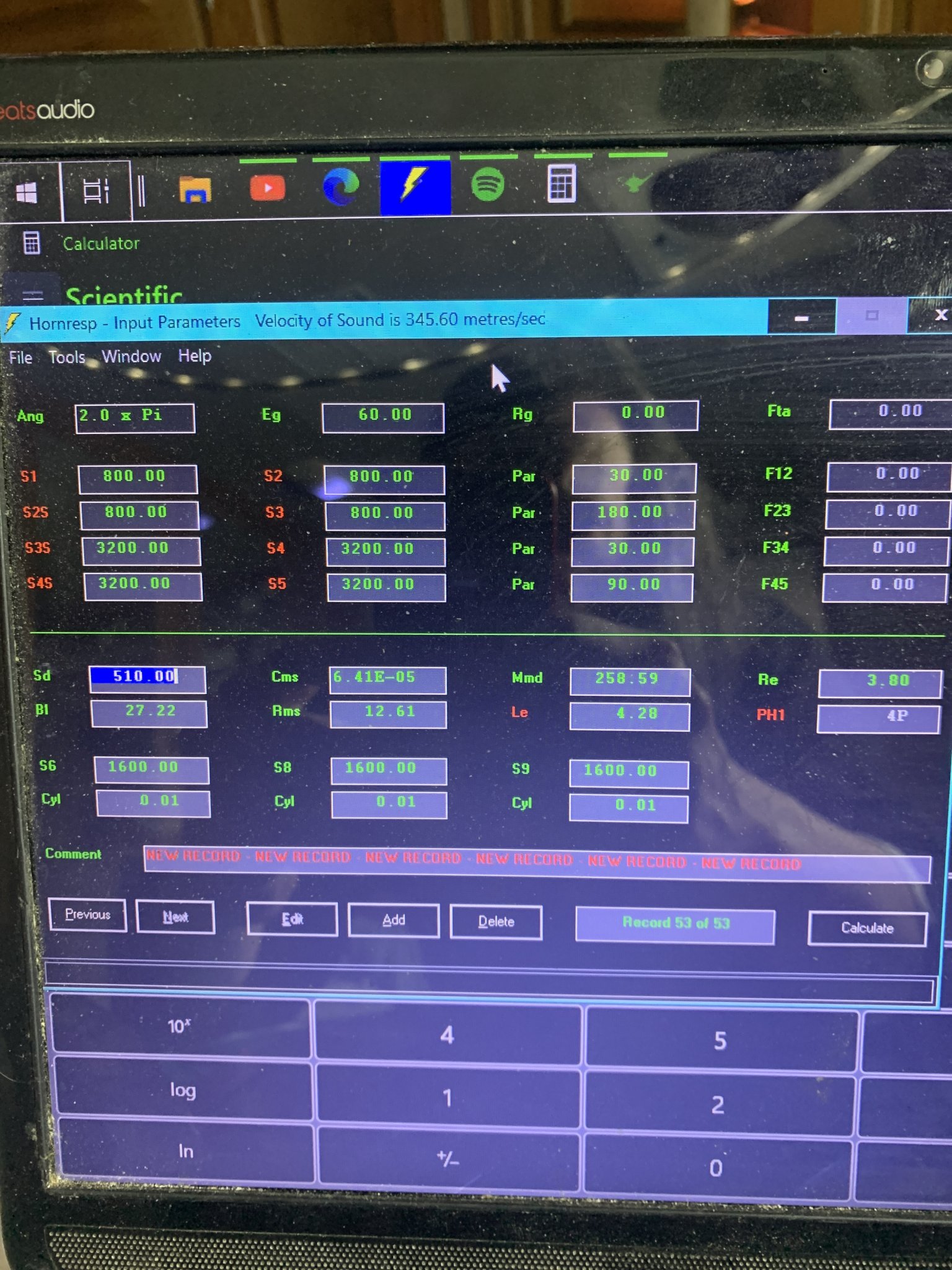

I don't have the skillz to modify Brian eminence driver box to stick the skar ddx12 inside, I already tried with the current dimensions and the sim sux for the skar, so I will use the eminence driver Brian designed the box for.

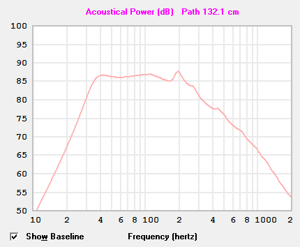

Eh! a bit more stuffing and setting path length difference, looks OK to me.ok so now that the SKAR DDX12 D2....

Let me finish the holidays I will UL the txt file, I just typed in the skar parameters in to Brian design.Eh! a bit more stuffing and setting path length difference, looks OK to me.

I just learned how to try different drivers in to an existing setup .
No need, I copied it, tweaked it a bit and uploaded the file for ya'll to import/view/mod/whatever, so use the File/Import option to put in the Import Folder and then open it and it will pop up as a new file.
Attached response plot, biggest problem is it only can handle 40 W down low.

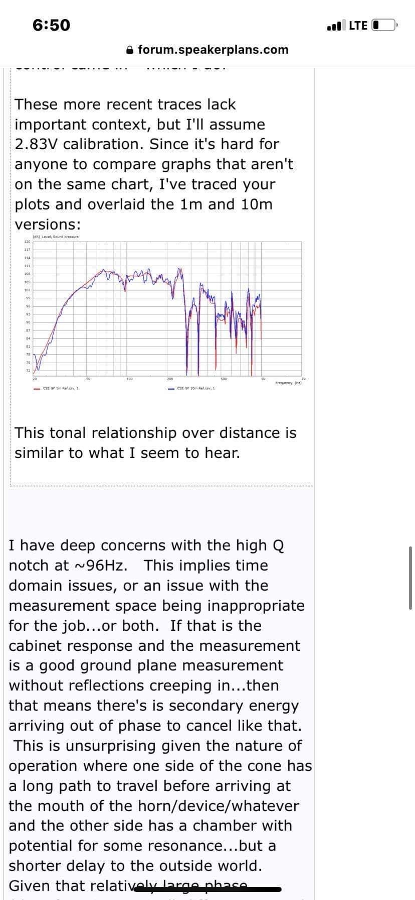

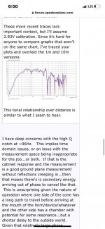

Just look at the discontinuity and the details about freqs in that area shown by horn response in a variety of screens and look at a variety of ways in which you could sim that and describe it otherwise(long path vs exit vs short path, that will show more of the same and you will quickly conclude. There are absolutely positively things to be concerned with that they like to dismiss and it is not fun to be spending that much time and energy and building a cabinet only to have someone tell you that weird things you’re hearing do /don’t exist.Lol,yeah I saw more than 2 dozen designs/drawings over there

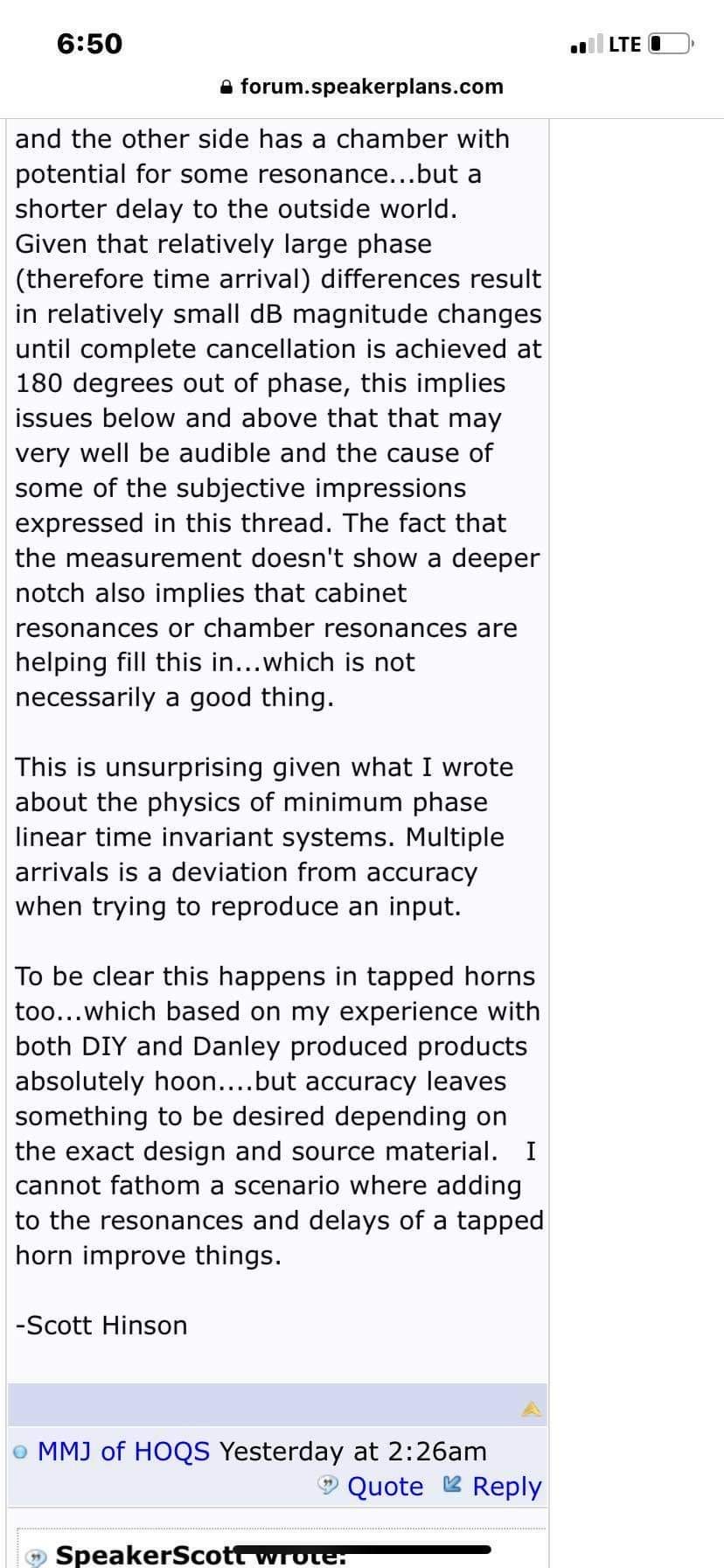

Scott Hinson can much better describe what they refuse to explore or entertain if constructively critiqued by (us) people who build them and are left tweaking things to fix that intersting area that can be remedied or resolved by a better (simpler) design That’s actually 3:1 it seems (???) I do t understand and gave up on paraflex and the group of confused parrots🥲
Look at your TS parameter vs mine(I have 6 of the ddx12 and kind of averaged the measurements with JR van sickles and jose Ramos‘ as well.. and use the one in my HR sim for a ‘roar’Let me finish the holidays I will UL the txt file, I just typed in the skar parameters in to Brian design.

With the Skar? Not a chance, it only handles 40 W down low, so historically prosound was tuned 1.56x Fs = ~52 Hz, so shorten it and now it can handle 100 W, but this only gets you 110 Hz/40 Hz/2pi, so need (8) in series/parallel for 130 dB/40 Hz/2pi.With 4 of those you think I can hit close to 140db? Or at least 136

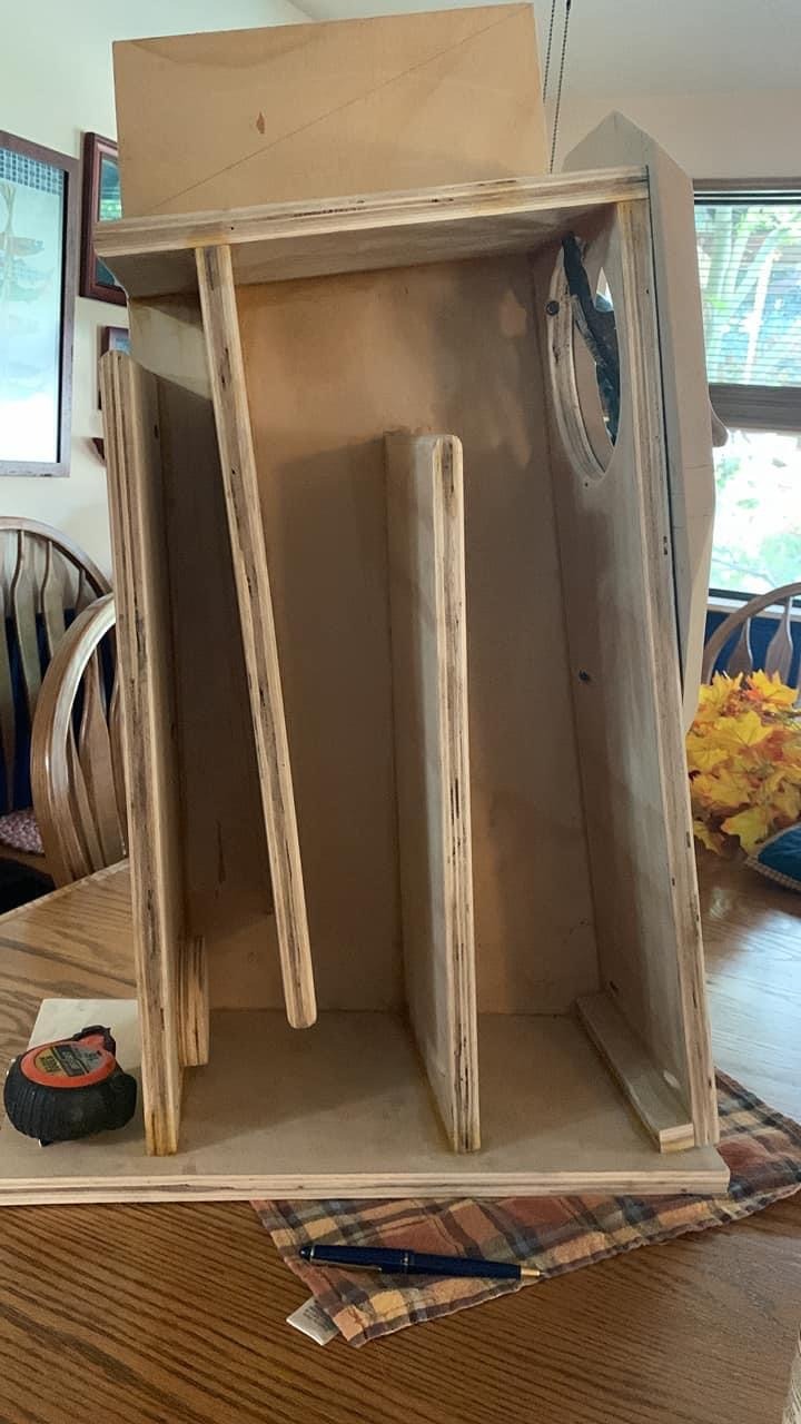

Ok so I guess the cut sheet comes next
Hope I can start the prototype before January 2023 ends.
