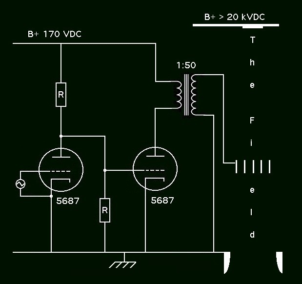

Here is my second take on transformer coupling.
When there is no audio program one could have say a 'new agey' and
otherwise low/silent/attenuated 7.83 Hz wave playing so the transducer
grid is kept at a high voltage compared to the cathode – to keep the transducer
from pumping DC, at full power.

bigwill said:
The problem with this design is that it doesn't provide very good regulation, and the voltage will probably change a lot, but it should be good enough to generate ions at a resonably steady rate..
Try to implement the negative section / cathode to get a more directed ion jet. The lifters use
sections of aluminum foil for this.
While enameled magnet wire is used at the emitter / anode.
About using needles for the grid, tip pointed at the anode, and using a bunch of them would
possibly be rather excellent, very aerodynamic 😀

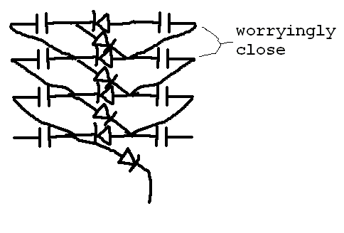

I underestimated how long it would take to solder this thing, so I think I need about one more soldering session. My caps are layed out like in the attached image. Some parts of the circuit are worryingly close together and I hope I don't get any flashover! 🙁
Actually that looks OK to me 🙂 My design was folded and the voltages between the two
rows were much higher than what it is between each cell.
It should be possible to make this more stable by adding a fat? reservoir capacitor and
a lot of high voltage zener diodes connected in series between B+ and the air/ground.
Then again, this is somewhere into the future I suppose.
