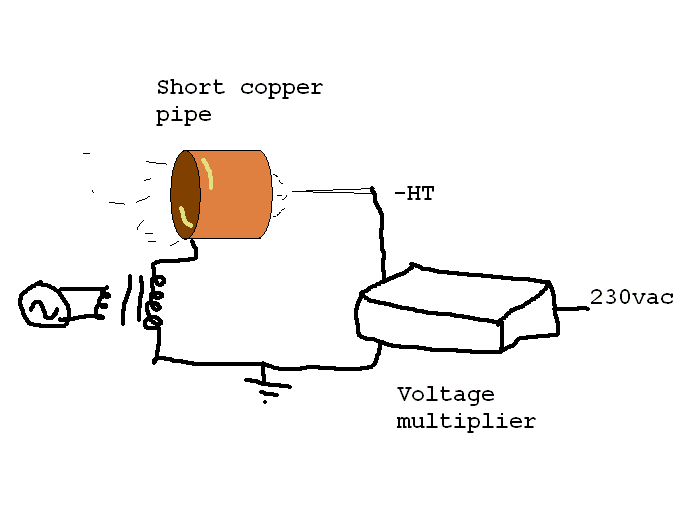

Hm, I have a difficulty getting the picture here, a drawing would be nice d:
One good way to test if you have enough voltage would be to use the same electrode
materials as the lifters do; magnet wire with the enamel intact for the anode and
aluminum foil sheet for the cathode.
If the ions can pass or float above the enamel, then you have something >20.

Here is another suggestion for a transformer coupled grid.
(The grid looks like it is compressing air – the intention is
to show the need for a larger surface, so to ground the air)

The way your transformer/grid is coupled, fed a positive audio signal is going to give attenuation – an amplitude inverter is here needed. If the anode (+) was modulated instead, then the positive signal would add to the overall voltage field, giving amplification.
It is a little strange if such a module doesn't exist somewhere within the 'modular synthesizer world' ... my old Roland guitarsynth actually had an inverted amplitude envelope function. Maybe some of the software synthesizers has this.
By the way, why is there a minus sign at the positive terminal? d:

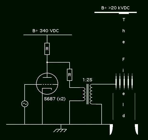

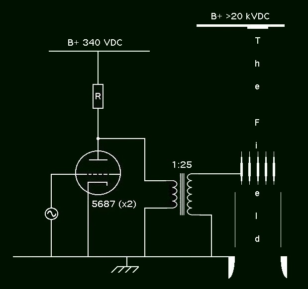

Inverter–driver, improved design
Here is a somewhat better version of the inverter–driver section.
The 5687 is a twin triode, the (x2) means 'connected in parallel'.
The value of R should be calculated to give half of
the plate current – for peace of mind 🙂
If the plate current is 12.5 mA, then 340 Volts / .0125 = 27k.
When connected in parallel this value can be used. And the
plate resistor should then be rated 10 Watts. For peace of mind again.
