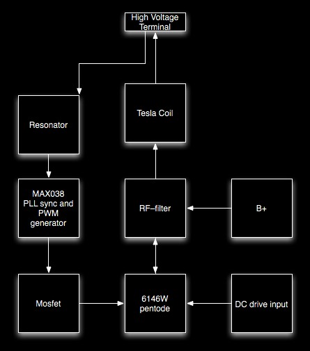

Max038
The MAX038 has a phase–lock function, with a variable duty cycle square wave output (=PWM).
Adding this wave shaping feature to the TC resonator could improve efficiency.
Adding phase control could be another nice feature.
Only how to make this right 🙄

Re: Max038
Indalhc said:
With two "M399 ESL step-up transformer 125:1 turns ratio each $125.00" a 80 Volts peak input would give 20 kV. Not precisely cheap, and the low frequency response is not given (most people add dynamic subs to their ESLs...).
Hmm, I may have to use the tesla coil method instead, transformers are expensive😀
I still want to test with a cheapo transformer though... I think my father probably has some old P-P output transformers somewhere...
Good luck 🙂 I hope it works!
The early prototypes 😀
Thanks man :emoticon:
Phase control on the resonator could by the way be like playing tennis, knowing exactly when to hit the ball (Not that I know very much about the sport).
Good luck to you also with those transformers! I expect to be getting there one day myself eventually (for the modulated grid version).
