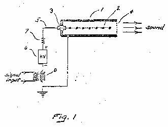

I tried to build the thing described in the attatched image, but it didn't work 🙁. It might've been because I applied the signal to the outer casing instead of to the needle like in the image, or more likely due to the fact that it was a hudge bodge and my transformer wasn't suitable 😀
I might order some super cheap 100v line transformers to mess with.

That looks more like a 'plasma'/high voltage field microphone to me d:
Transformers have some difficulty reaching 20 kV, one good reason to modulate via a valve at the anode (in a tesla coil) or using a lower voltage modulated grid at the cathode.
bigwill said:I tried to build the thing described in the attatched image, but it didn't work 🙁. It might've been because I applied the signal to the outer casing instead of to the needle like in the image, or more likely due to the fact that it was a hudge bodge and my transformer wasn't suitable 😀
