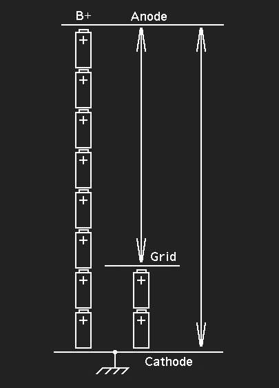

The need for amplitude inversion.
Amplification means more volts between the anode and the grid/cathode, however when
loading the grid, which can be seen as the ground point of the main power supply (B+)
with a positive charge the overall voltage is then decreased, resulting in attenuation.
I said "direct-driven valves", surely this should be 'direct-driving' instead. And an amplitude
inverter will have to be used in such a setup.
With a single-ended PWM drive of the grid, the effect is that every time the FET gets a pulse
it then grounds the grid to the cathode, this is the same as narrowing the cathode/ground
towards the anode, with a strengthening of the overall field as a result. This without
any amplitude inversion. So the 'inverted amplification plasma transducer' can be said to operate
natively with single-ended PWM audio signals.

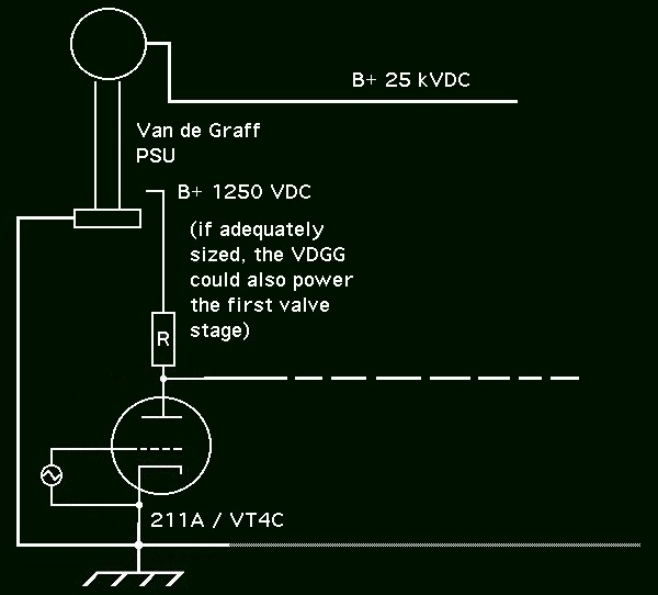

Talking about the Van De Graff Generator, such a unit could well be made stabilized (eg by
many zener diodes in series) and work as the main power supply.
I'll take it a little easy forwards with the amplitude inverter, filed for now as 'work in progress' 🙂
One more thing, the reason a transformer coupling of the grid can't work is that this gives a fixed
zero point, while a floating zero point is required instead.

I made an other drawing of the anode - grid - cathode voltages, as they would
appear if the grid was driven directly by valve, any amplitude = attenuation,
unless the plate of the valve was coupled to the air-ground instead of to the grid,
but then that would be problematic of many reasons, safety for one.

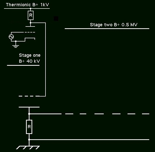

Here is 'The Id' with a thermionic 'preamp' stage.
It would reproduce audio - without the/any amplitude
inverter.
The B+ voltages could be set at different levels,
for example 1kV, 20 kV and 20 kV.

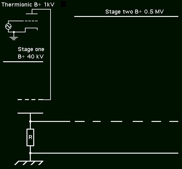

Anyhow, here follows a thermionic valve coupled atmospheric plasma
transducer, again 🙂

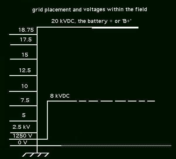

Grid placement
Here is drawing describing voltages within the field.
The grid is placed at about 8 kV, and driven at 1250 Volts so
there are a certain danger for overloads.
In a high current field, a thermionic valve could maybe stand
double its rating safely, perhaps even more.
So with a low current field it could be interesting to start
experimenting with 'low voltage' tubes, for example the 5687.
