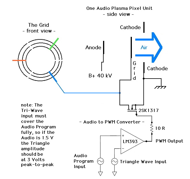

Here is an other design with a rudimentary incorporated Audio to PWM
converter - If someone have a better design they want to share, then by all
means share it d:
The triangle-wave should be somewhere around 40 kHz and very clean.
For lazy and otherwise convenient people, one may hit two flies in one
go by making a lower 20 kHz triangle wave in an audio editor, and then
put that on one side of a stereo audio track and put the audio program
on the next. Then download this to an iPod Shuffle and you have a fully
floating playback unit. The high frequencies will be a little lacking, other
than this, it should be good for testing the rest of the audio spectrum.
The Shuffle above instead of making an optical audio link. The optical link
could be useful for isolating everything from the Plasma Unit: If the high
voltage mosfet breaks down one may under certain circumstances have
a high voltage flash into the low voltage region, the audio modulator etc.

I mentioned earlier something about the grid voltage - I probably meant
to say as follows:
Operating the high voltage field at 40 kV with a light overall drive,
we could have good audio coming from a +500 V (airborne/virtual) grid control
voltage.
If the field was driven higher, the grid 'load' or 'drive' voltage would also have
to be set higher to maintain the same dynamics. So a light drive could be what
we're aiming for here.
The 2SK1317 MOSFET is rated 1500 Volts and 100 Watts, that again gives an
estimated aera of 2.5 square feet, at this stage for parallel/monophonic testing.

Having another look on your design.
The -40 kV should be positive instead.
The audio signal to the transformer coupled grid would actually
need to be amplitude inverted (not the same as phase inversion!)
first, since the grid has the function of an inverse amplifier when
fed normal/positive signals.
One alternative here could be to modulate the anode voltage,
but then you would not have the grid control...
Lastly, the outermost +10 kV should rather be the air-ground at about
(-) zero Volt (do not touch this point unless is completely grounded to
everything else touchable).
Keep it up though d:

... sometimes I happen to read a datasheet as a certain being is
said to read the bible.... The 2SK1317 is actually rated 10.5 kW.
On touching the Cathode, I encourage people to try this if
it is within a very tiny scaled model (nano Amperes). On a kW scale,
this could also be safe if you actually were standing on the cathode
or grid itself in the first place, even the anode. As long as you were
not trying to reach anywhere outside of that 'potential' / location.
To safely get to and from these electric potentials, a maneuverable Lifter
should be convenient d:

PS. About the Shuffle programming, the audio could be at .75 Volt
while the triangle wave at 1.5 Volts, further tweaking would be possible if
it had a balance control (has it?). The contact pins should be gold plated.
Blah, blah
... and there should in the most recent schematic be installed a ferite core
between the 393 and the 2SK1317 to avoid self-oscillations. I really hope
someone here eventually comes up with a better design 🙂

I mentioned that the triangle wave feed to the PWM modulator
should fully cover the audio. This is so, however it certainly does
not have to be double the amplitude. This should only be seen
as a measure to be completely certain that the audio never is
converted into DC by overload.
About the Amplitude Inverter. I tried to make one, but for now it
only seems to convert everything into square waves. It shouldn't
be all that difficult though: Invert the wave, then bias it so that it
is grounded at zero Volt and that the amplitude then again moves
further downwards the negative region from there. One op-amp
should suffice, only how to do this right...

Amplitude Inverter
If the audio program has an amplitude of 2 Volts peak to peak then
the wave zero crossing point from the Amplitude Inverter should be
at - 1 V presicely.
The amplitude inverter is not needed if the grid is fed a PWM output,
however this device could for sure also be interesting to work with.
at - 1 V presicely.
