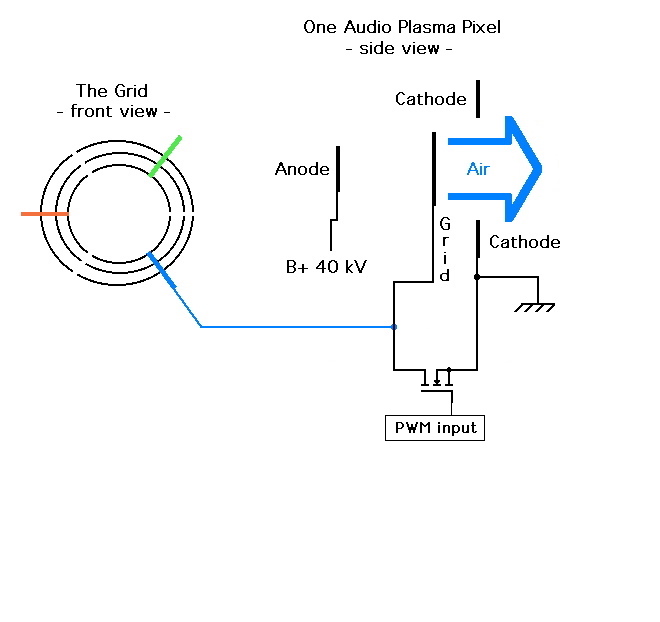

42bit 96kfps Holographic Sound Project, 'The Works'
.... many, at large d:
Here is a suggested design for the grid coupling/audio
modulation of one audio plasma pixel module, using
two bridge coupled Apex PA89 high voltage op-amps.
They give 180 W, so more than enough power for the
prototype 🙂
The lower part of this schematic is from the PA89 data sheet.
Further comments and suggestions are welcome.

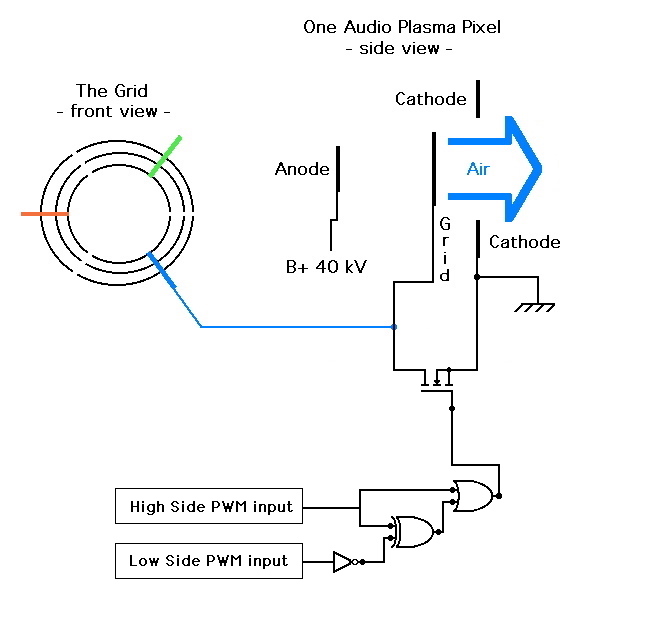

Here is a PWM input-ready version of the audio plasma
pixel unit.
Its cathode is again more ´safe to the touch´.
(The previous version would seem to require an amplitude
inverter module added to the input - I hope none here got
travel sick d:
pixel unit.
travel sick d:
... only the lower side part of PWM input in the most recent posted schematic works
as it should... I'll have to get back to this later

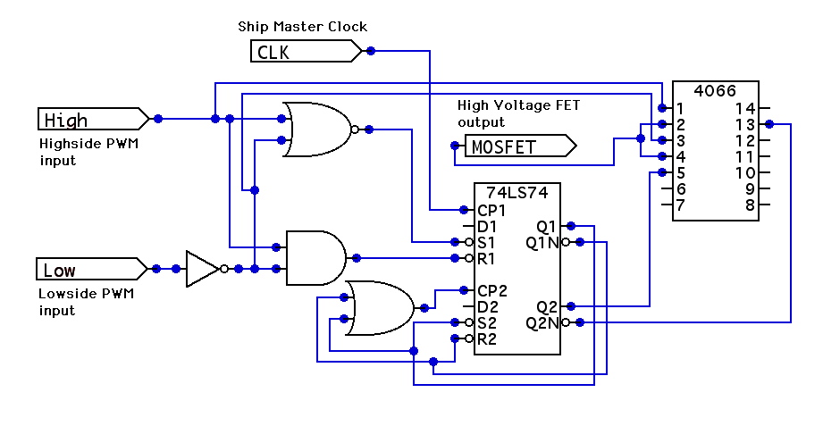

Sorry about that earlier mess!
And maybe also the following new attempt on making
a differential to single ended PWM signal converter
- digital logic isn't really my field...
I am certain there are better ways doing this - it can
be a little tricky to get everything right around the zero
crossing area, to avoid losing parts of the wave.

More about the PWM modulation, I think I'll rather try to do this
from scratch, it seems to be equally simple and the result compared
to building a 'rough' converter would most probably sound much better.
Audio to PWM as follows. Run audio in parallel with a 40 kHz triangle-wave
through a comparator and voila, we now have a useful PWM output
to feed the plasma grid FET.
