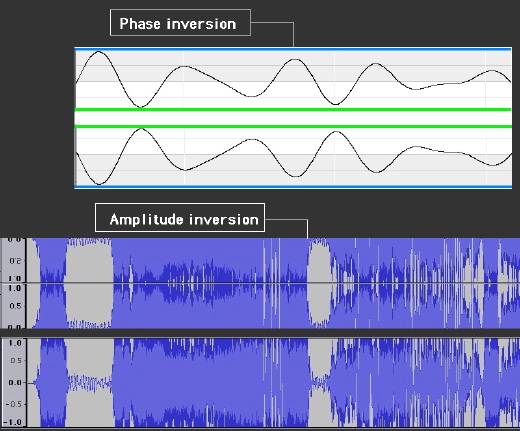

Software amplitude inversion
The amplitude inversion could also with ease be done all in software, with the
following result / description of an amplitude inverter's function: Loud parts are
attenuated, silent parts are amplified.

bigwill said:What's an amplitude inverter?![]()
With analogy to photography, it makes an exact negative image / print of the waveform.

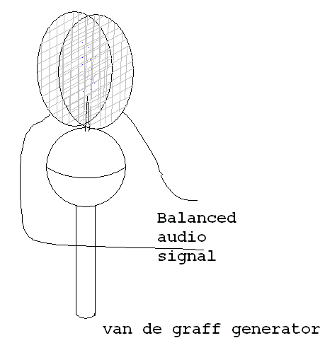

I see. I've had some more ideas of my own for a no-moving parts speaker, although mine is on a bigger scale, not lots of little ones, two big ones for stereo:
This is basically an ESL but the "diaphragm" is made from air ions instead. It would be interesting to see if this would work, maybe one day I could try it... I have a feeling these panels might have a good bass response too, since say for example you drove one stator positive and the other negative, you would (I think) get a constant air flow like a fan in one direction, much like a fan subwoofer (unless the accelerated ions lose all their speed when they hit the stators and discharge, would this happen?). A displacement limited diaphragm would not be able to move so much air.

On a second thought - a push-pull operating plasma transducer could be interesting.
And dark pictures are more mild to the eyes, I must incorporate this
That design you quoted looks pretty much the same thing as what Pass did:
http://www.diyaudio.com/forums/attachment.php?s=&postid=23708&stamp=1017889664
As for the previous diagram: why use transformer coupling? This is a perfect example of where direct drive by tubes is what's called for.

I prefer things to be 'symmetrical', I'm funny like that 🙂 (Apart from where it matters, I prefer the class-A concept amplifiers for example)
That's roughly what I was going to do before I changed my design to push-pull 🙂
I inverted the colours in MS-Paint because after drawing it was hard on the eyes hehe
That looks very interesting, I guess the idea works then. Do you have any more information on these speakers?
Well, either way will work 🙂 I'm not deadly against using transformer coupling as I don't have any valve amps, but If I was to build an amp for speakers like these I would definetely use direct coupling from a valve, providing I could get a big enough voltage swing.

I want to set up the experiment described in the attached pic. Ions from a van de graff generator are moved by an electric field modulated by an audio signal. Will this actually produce much sound? I really want to try it.
Also, another thing, do ion streams like this from a van de graff generator actually generate much ozone?

Phase vs amplitude inversion
Here is a picture describing the difference between the two.
In phase inversion the whole wave is mirrored against itself.
In amplitude inversion the wave is first split in two halves
then they are mirrored separately against themselves, and
then put back together again.
It should now perhaps be easier to see what an amplitude
inverter should look like. For one, the phase splitting could be
done with a transformer (and by all means, an op-amp could
do this fine also.
do this fine also.
