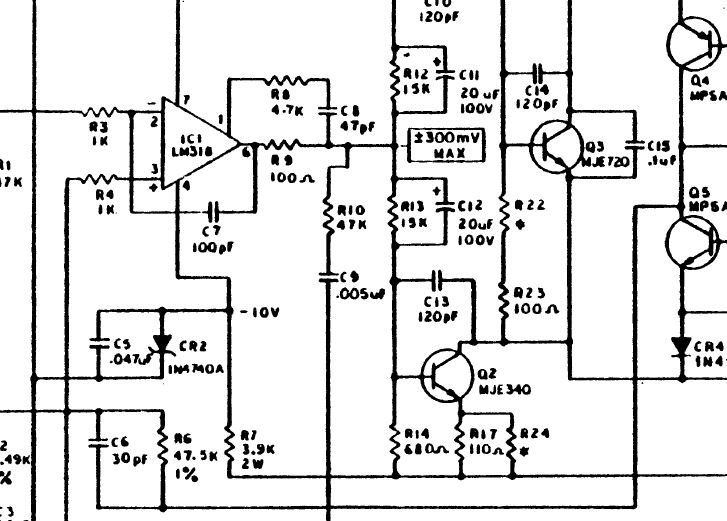

I check a few voltages in different places to verify that everything is correct but I realize that at the output of the LM 318 I have on the Right channel which is still operational and of -240mv origin.
except on the Left channel which has just been repaired I have + 450mv. I have a doubt about the LM318 which is broken, however when I put an audio source I have the sound coming out of the two channels at the same power without distortion
on the BGW diagram it is written +/- 300mv.
there I do not really understand if we must be in the positive or in the negative because +/- does not really mean the good sense of the current.

I replaced 2 condos and my output voltage returned to 0.250v instead of 22v,this voltage difference comes I think from the defective LM318
C1 10uf 25 polarized. and C7 100pf MICA
remains the LM318 which is broken and I am waiting for the part this week because I get output on pin 6 +580 mv off on the other channel I am at -230mv I will have to check the R22 which has already been replaced if I compare it to the other channel which has never had anything replaced
If C11 or C12 are leaky it can move the voltage at the output node of the 318 out of a range where it even can be corrected by the feedback. And the currents can damage the op amp if it’s bad enough. Millivolts (or even a couple of volts) is not fatal, but indicates impending problems and will have awful turn on/off thumps. Latch-up may even be possible giving you DC to the speaker. That usually doesn’t happen, and the usual failure mode for drying out caps causing them to go high impedance. But it’s possible. What you REALLY want are film caps, but you’ll have a hell of a time fitting them. Barring that use the best quality electro’s you can find, and keep an eye on them when doing routine maintenance (like cleaning out dust).
Hello,
I have already tried replacing the C11 and C12 with 22uf / 350v that I had in stock, but no change.
when I isolate the output of pin 6 of LM318, I get + 5.06V, off on the other channel I am at 240mv so there is a problem on the LM318.
for the 20uf / 150 they are in order with RScomponents but blocked for the moment with the BREXIT, arrival expected this January 25 normally

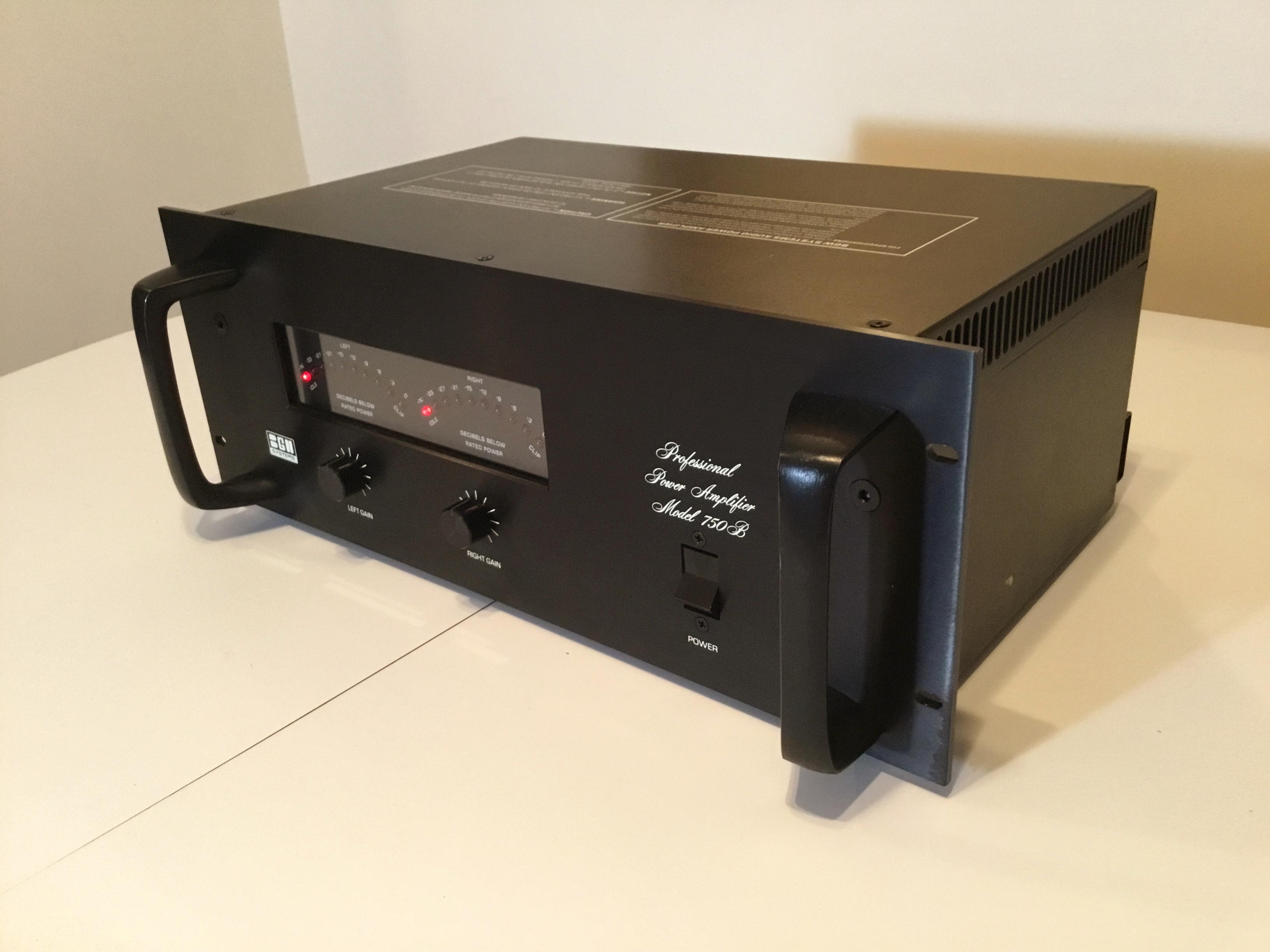

That looks like an interesting project titoon.
On a side note, once you have all the issues fixed, you will notice that when you bench test the amplifier, the "clip" LEDs will illuminate quite prematurely on either an 8 or 4 ohm load.
I noticed that when working on my new (literally) 750B myself. It is possible to get around that with a small modification to the LED board itself. The clip LED needs to be isolated from the rest of the display first of all. You will notice that there are two small unused 2 conductor connectors lying just below the potentiometers.
Those are part of the standard chassis wiring harness and made to light the clip lights on the model 750C. Those are the true clip indicators that illuminate at actual clipping.
You have a first generation 750B. Subsequent multicolor LED models made use of those clip indicators. The entire LED drive circuit was also revised to an IC driven display.

yes I had seen these 2 connectors lying at the bottom of the chassis and I wondered what they could be used for, you just gave me the answer. this is a first version.

Your 750B looks like new, where you get this amp, new old stock ?

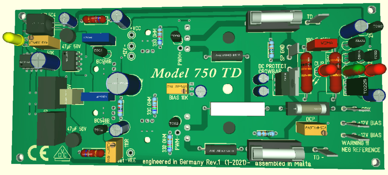

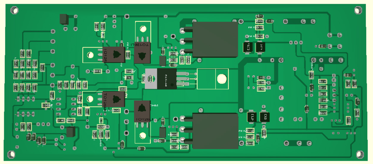

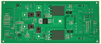

Preview BGW 750 B/C REBORN 2021
have nothings to do whole day due goverment Covid-19 lockdown + work ban
habe revised BGW 750 B/C
- Add: Balanced Input with Clip Limiter
- Original 750 B/C LM318 Input stage circuit
- Add: second stage cascoded, MJE 340/350
replaced with 2SC3503 / 2SA1381
- ADD: VBE replaced with IRF510
- ADD: BJT output Stage replaced with HEXFET / UNIFET
N-Channel Power Mosfets
- ADD: Triac Crowbar DC Protection
- ADD: Short Circuit and Overload Protection
- ADD: Turn On Delay / Off / Mute without relay
Extension: Class TD with additional driver board
without working Clas AB

N-channel mosfets aren’t necessarily any better for SOA than MJ15024’s. Especially new types. If you’re going to do this, use an older type which has been around since the dawn of time, and *isnt* optimized for low Qg and fast switching. The older types actually had decent DC SOA.
