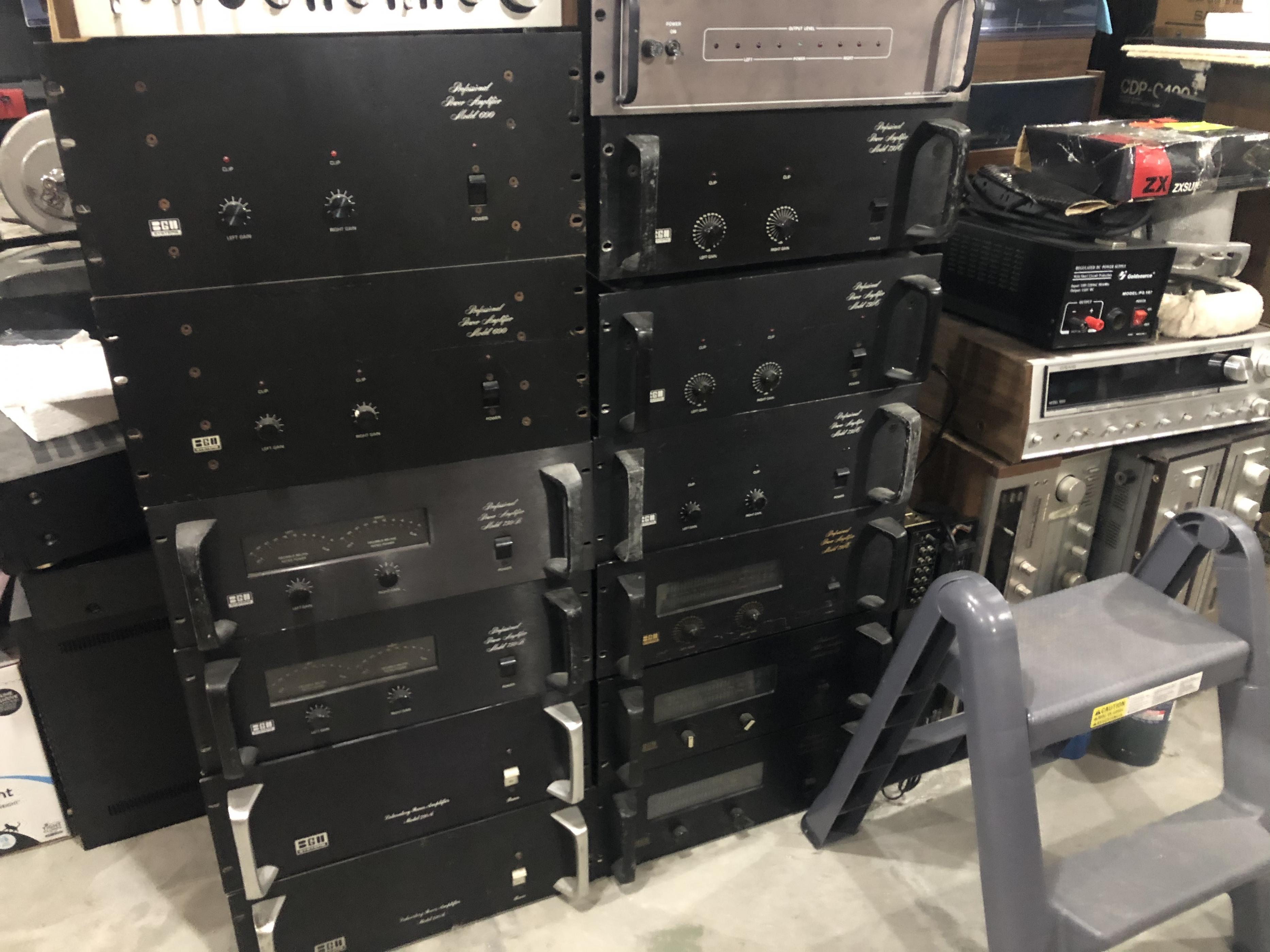

Hi Guys,
I think this might be my first post here. I have been active on AK for years. Last fall I acquired a bunch of BGW amps from an estate sale. I have been in the process of testing these starting with the B and C versions one of which did not pass the dim bulb test. I have done some reading on these and decided to get into this one. Both modules do not pass dim bulb test and will trip the breaker. One module I desoldered the outputs (A few were bad) and tested some of the other transistors which were fine. With the outputs out and the one module plugged in it does not trip the breaker. A few questions and please be patient as I am not real familiar with amplifiers and how they work.
With the output transistors removed I am getting between 60 and 80V at almost all the transistors on the board. I am trying to make sure I don’t cook more transistors. Am I going about this correctly?
What should I be replacing the outputs with? The standard OnSemi MJ15024/25 recommendation does not seem to be available or maybe it has been replaced with the same number ending in G?

Does anyone have a source for an AC fan that would be quiet? 2 of the 750 I am working on have noisey fans. One of them is very quiet. Seems like with the right fan the 2 speed fan set up is the right thing. I know some people are installing DC computer fans with a walwart for a power supply.
I’ve found that the best solution for fans in general is 24 volt DC fans, switching them down to 12 volts for lower speed. 24v fans seem to be beefier with better bearings than 12v “computer” fans which are designed to last a couple years and either quit or get noisy.
As far as what outputs to use? 15024/5. The G version is the same. More rugged than the 2119x in this particular application. Get the entire amplifier working without outputs (at all), driving a 100 ohm load correctly, then install the output banks.
So, I think you are saying with outputs removed I should not be seeing the high voltage all over the place. I guess I will pull some more transistors and test them.
Funny just today I went through that whole stack in the photo and tested them all. Most have fan problems and need power cords but they all work!
You will see high voltages - at the rails. With no output transistors you should see no DC at the output. That’s the first indicator you should look for. These amps will operate normally into a high impedance load directly off the drivers. If some sort of fault occurs in that state the damage will be minimal and can’t take a set of outputs with it. The worst that could happen is a shorted driver transistor, which will smoke the base-emitter resistors for the output bank but will not take out the other driver, if it’s good. The resulting fault current can’t get high enough to do anything worse than smoke a cheap resistor or two. You should still use a dim bulb limiter anyway - and if you run output-less the idle current will always be low enough to let the rails come up to near normal operation even if the bias pot is turned all the way up. You can also verify that before the outputs are even installed and make sure it starts turned *down* all the way when they are installed.
If the amps were all working, there is no real need to go through this exercise. It is what you do if it’s never been turned on and you just don’t know, or if you’re still tracking down faults and not sure if they are all cleared before putting in new outputs. The only thing really wrong with these designs is that shorted predriver stages or an open bias stack can blow entire output banks. These types of faults must be cleared first.
