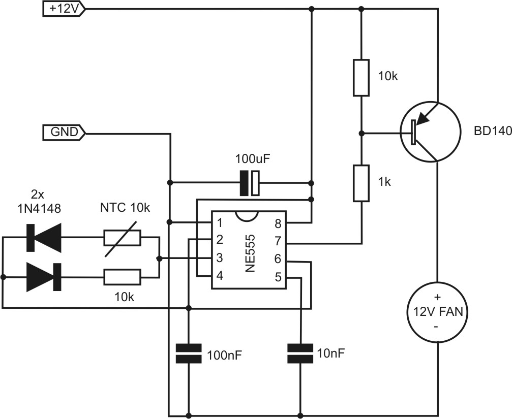

very easy and cheap
you can replace old BGW FAN circuit
with 12V FAN PWM temperature control
and 750B is not noisy anymore

Nmos - thanks for the handy suggestion but I am afraid my level of skill is only at the replace like for like status at the moment!

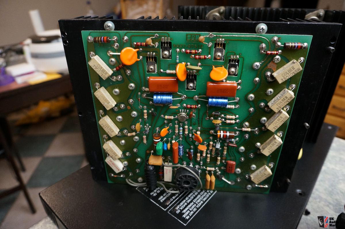

I could acquire three BGW750 with Serial Numbers 80A0292, 80C0416, 80D0770.
5 out of 6 Amp Modules are labeled 9007-0751D and one 9007-0751C. See pictures here: Modules - Google Drive
I've recapped the modules as described earlier in this thread.
What I've noticed is that the 9007-0751C is different to the 9007-0751D, it seems to missing some modifications.
Does anyone know what these modifications are and if they are recommended?

I find other modification have big
NON Polar Capacitor parallel with Elektrolyt Condensator after 100 OHM resistor from Op AMP Pin 6 output
Any Idea whats the benefit to add parallel NoN Polar ..look picture?

3 Capacitor and 1 resistor is missing in D revision
please check schematic which parts missing und give feedback.
Did you have difference sound in Fullrange between D and C Revision ?
