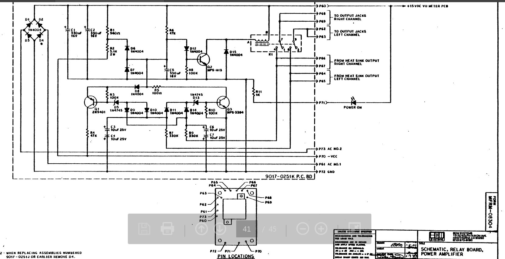

However when switching off, is the relay supposed to cut sound to the speakers?
I get wizzing and hissing after powering off just for a short while.

Hi Deaf Cat,
Yes, the relay should drop out quickly. It also sounds like it doesn't have a delay coming on. Compare the capacitor sizes with the schematic, increasing the size could cause silly problems. I haven't got time to review the schematic right now, but maybe later if you are still having trouble.

Hey, thanks for the tip, do you mean the caps on the relay board? or, having added the 47uF across the main caps?
The first thing I did in an attempt to get the amp working through both channels was to change the plug in relay (could not get exactly the same, but thought it was close enough) straight after swapping the relay, I noticed the R2D2 sounds once powered off...so that irregularity was going on before the 47's were added, and before I disassembled the chassis wiring...
Looks like there a good number of caps on the relay board...
OK I am perplexed, just switched on and had both channels for around 45 seconds and the right channel dropped out!
Switched the 750 off and on again and the right channel is back again...
Looking at the relay, either two channels are on or off, and they are not switched individually.

Hi Deaf Cat,
A mono - stereo switch can certainly cause one of the channels to cut out. Try moving the switch slowly with a low constant tone playing. You want very little noise and a clean break as the switch moves to the other side.
As for the speaker relay. Was the replacement brand new? The test, you should be using a low level tone for this also. Apply the tone with the amp off. Turn the amp on, you shouldn't hear anything for approx 5 seconds, then you should hear the relay click in. Turn the amp off. The sound should stop almost instantly as you hear the speaker relay drop out.
-Chris

Evening,
Ahh I have not dared try the mono/stereo switch eeek just in case there is a lot of static crackle etc I may brave it when I have cheaper speakers attached ;-)
Ar yes I have tried the low level signal at turn on and switch off, it plays for around 15/20 sec. (I think) after switched off, with the odd crackle and pop while getting quieter and quieter. Yes the relay was brand new! Hmm will have to check pin outs! Unless its welded its self together for some reason...??

Hi Deaf Cat,
New or not, it sounds like the relay is stuck in the on position all the time. New doesn't always mean good.

Or the protection circuit was bypassed altogether at some point.
Thanks for the thought, yes lets hope it is just stuck...and can be, free moving, with little effort....

protection bypassed - the old relay worked correctly, on/off clicks, not that i tested it with sound.. its just that I cleaned the contacts with v fine sand paper (now learnt not good!) to try and get the right channel working. New relay obviously has different ideas as to how it should act! I hear no clicks at power up or power down.
