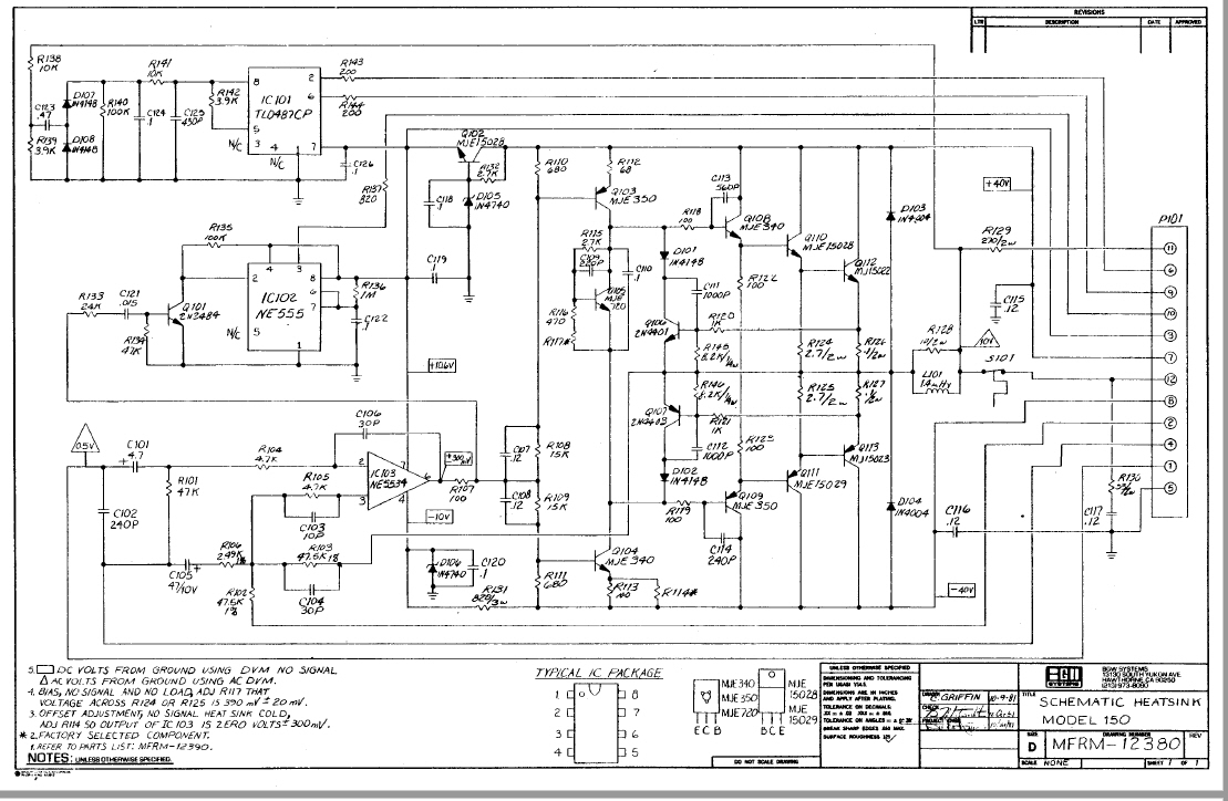

Hello Duke
BGW no have comp for NE5534 in Model 150 from 1981
Front End circuit is same, like Model 100 /250 C/D/E / 750 A/B/C
but BGW replace LM318H with NE5534 without comp at PIN 5 and 8
what do you think about value for comp NE5534 at PIN 5 and 8
if replace LM318H with NE5534a in Model 750 B/C
8k2 and 27pf in series same like in PIC for BGW 750 B/C ?

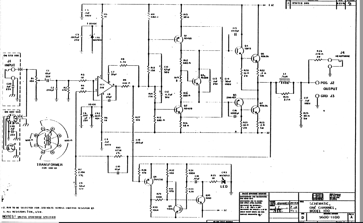

1. Schematic from 1976
BGW Model 100 with LM 318 have comp fot stability
2. 1. Schematic from 1981
BGW Model 150, NE534 no have comp for stability
.....BGW have replace LM 318 with NE5534

The NE5534 does not need any comp if the gain is >3x (The bandwidth is much lower). The LM318 has 15Mhz bandwidth and it needs comp for stability.
I removed the LM318/NE5534 from the front end and used discreet semi in many models as the turn ON and OFF thumps are well controlled vs OPAMPS.
They also had no output relays so the QUIET MUTE was needed.

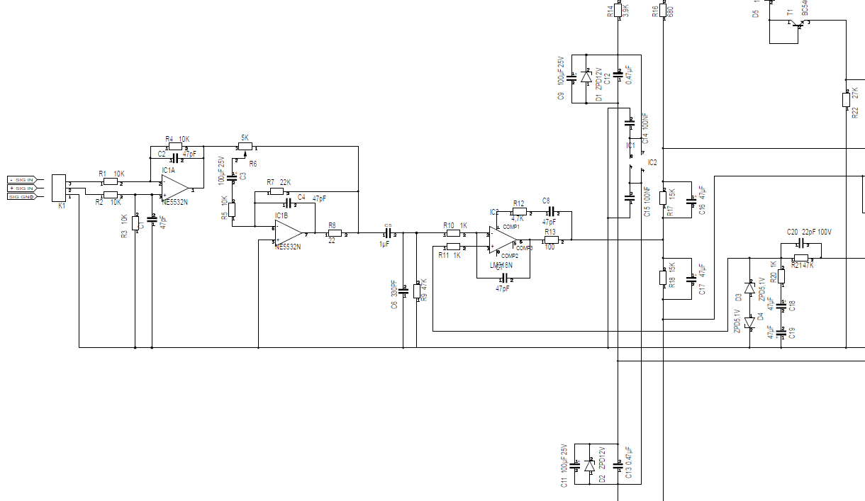

XLR PREAMP for 750B front end
Hi Duke
please have a look at the 750B Fromt end circuit
have add XLR preamp with volume control
Can I remove LM318 from front end and drive from NE5532 output
or its not good idea to change something in the circuit ?
Can you remember what was the reason to change in Model 150 to NE5534 compare to previous Model 100 with LM318
is 5534 improvement in Sound compare to LM318 ?
From datasheet LM 318 have much better performance....

The 553x are lower noise op amps. The reason the 318 is “faster” is because it is decompensated. When compensated for unity gain there is no advantage. The 5532 is plenty fast enough in the application. The 318 was a huge improvement over the 301 and 307, but technology has moved on (back in the 80’s even). You could experiment with modern op amps for even more improvement, but be careful of fragile input stages. In this type of amplifier it is imperative to use a diode protected input stage or the op amp will die from just one turn-on transient.

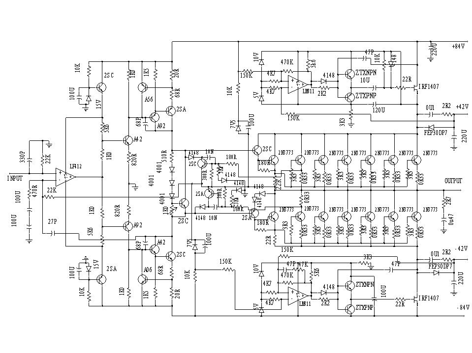

Please look schematic PA Class H Bipolar N channel output stage 2n3773
I find schematic about 10 years in this forum
Front End similar like BGW750 A/B/C
Do you think 2n773 in this schematic will oscillates audibly every time the rail switches same your Earlier versions with the RCA 2N6259 outputs ?
No way Class H rail switches with quasi complmentary output stage ?
