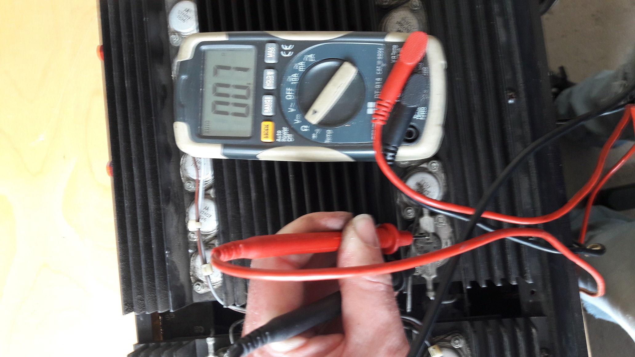

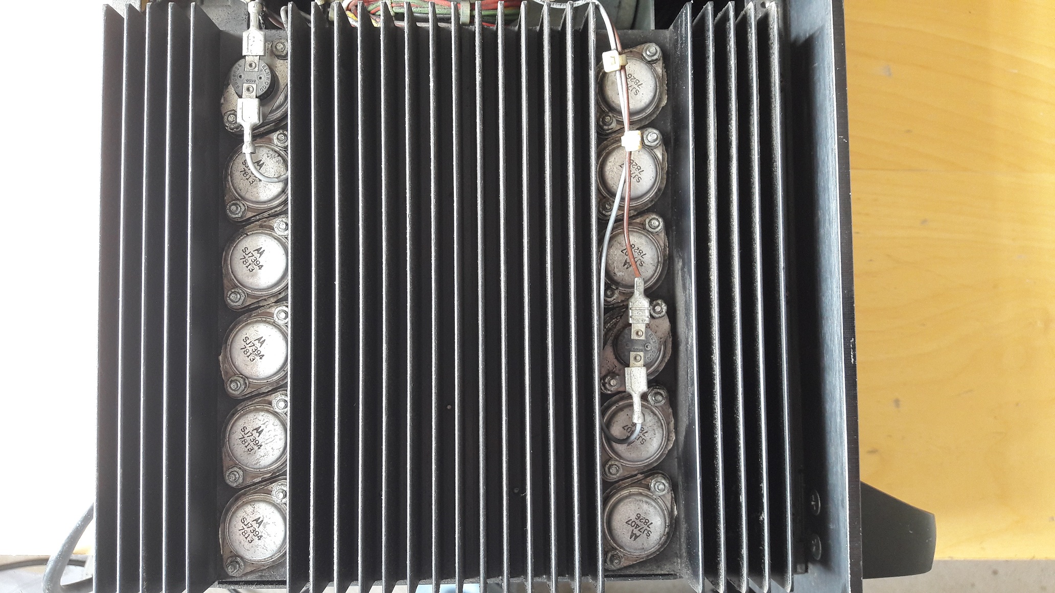

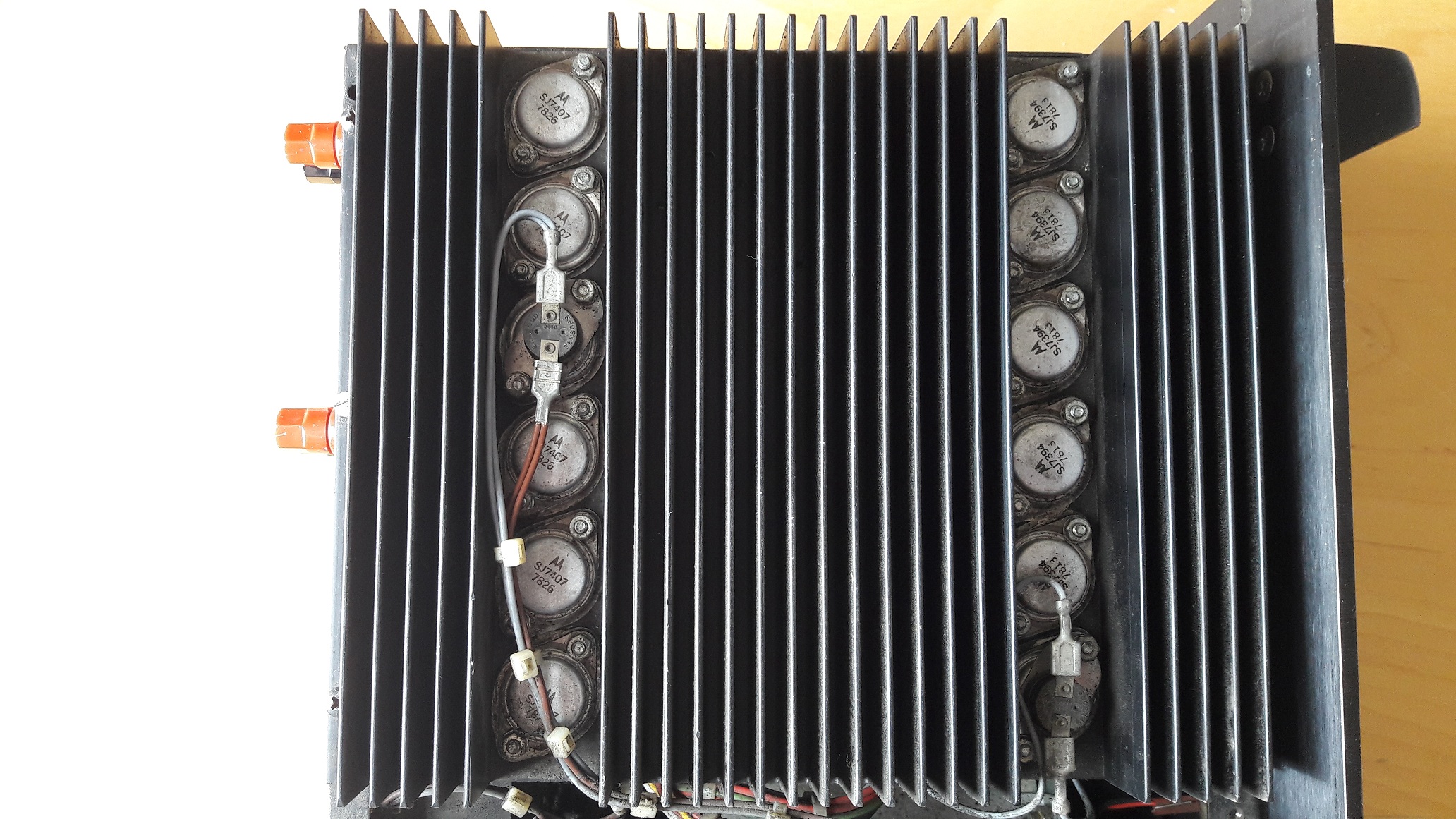

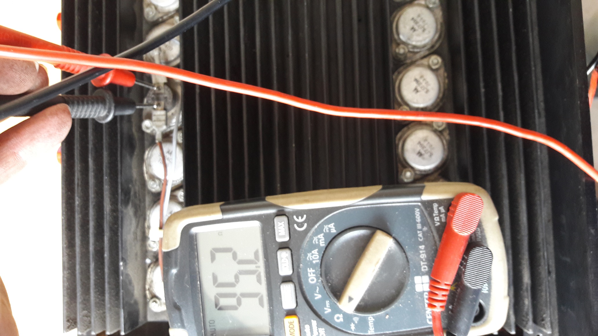

Thermostat resistance readings when cold and off.

There are two thermal switches per channel, one directly connected to the output of the amplifier, too much load and it goes open until cooled. The other is for the fan, too hot and the fan speed goes up. The load switches should have zero Ohms when cold and the fan switches should be open and should read 300 Ohms or so.

Okay, so the switches near to the edge of the heat sink on both modules is wired to the underside of the cct board on each individual module, might I guess these are the output connected ones, as they are closed/zero ohms?
The other two switches, more to the middle of the rows of transistors, have much longer wires and go into the loom somewhere, I might guess these are the fan ones and should be open but as they have some resistance the fan comes on pretty much straight after the amp is switched on...
Cheers for the info!
The fan normally runs at low speed thru the 300 Ohm resistors and that's what you're reading across the open switches. When one or both of the modules get too hot the switch(s) will close bypassing the 300 Ohm resistors and the fan will be on high speed until the module cools down.

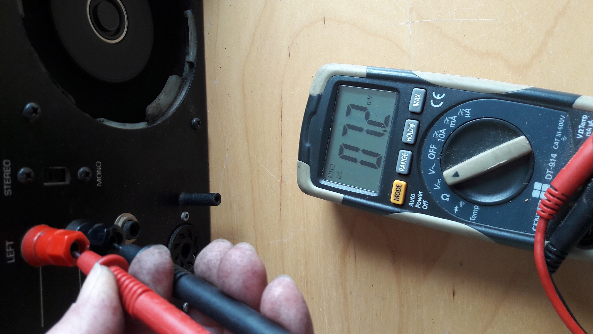

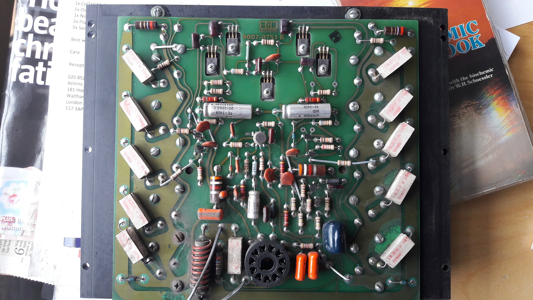

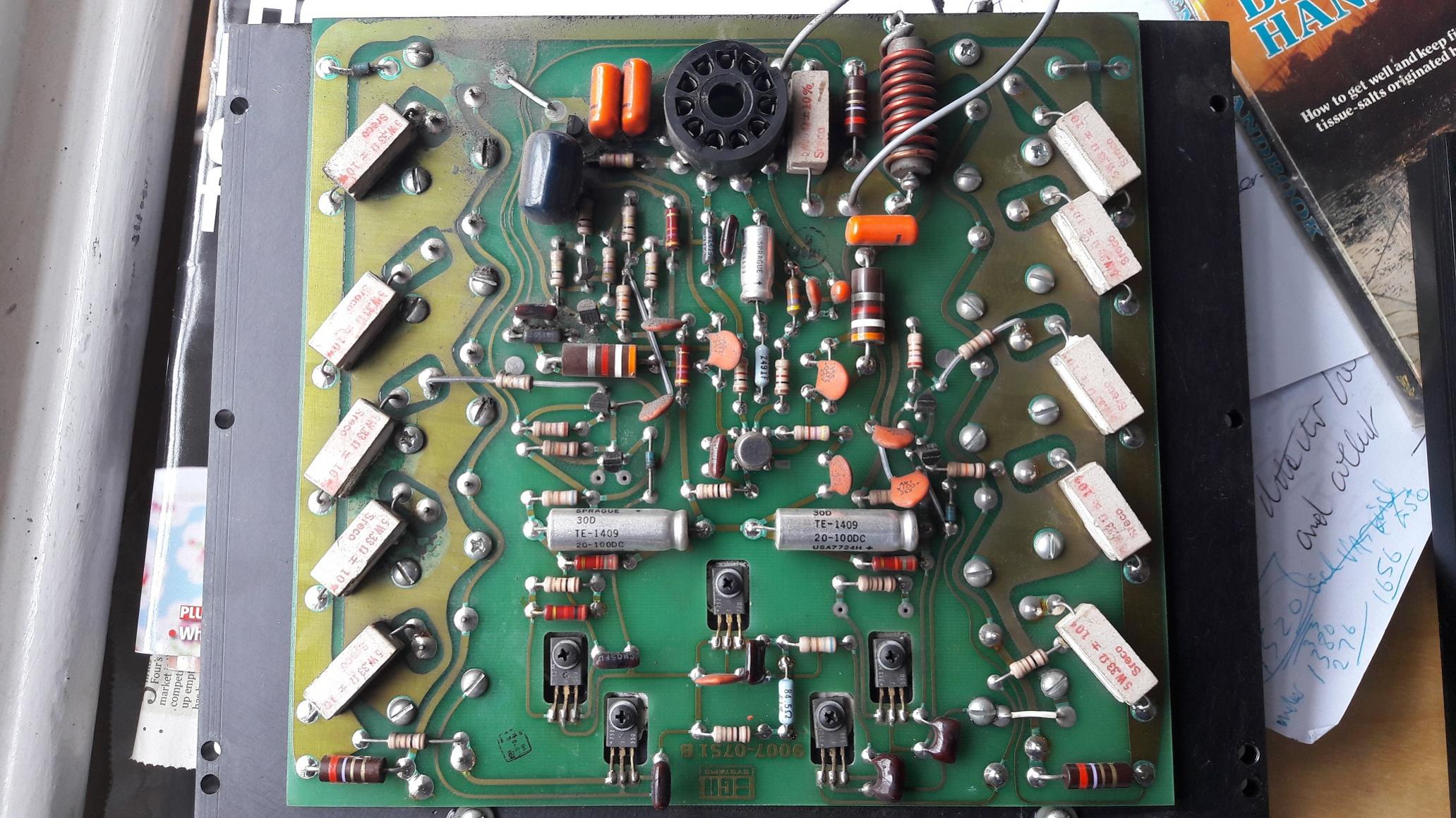

I would try and swap the module to see if the problem stays with the modules or stays with the chassis. If the FAN WIRING is to short remove and tape the wires for the test.
Duke
Just swapped the modules the dc offset of zero stayed on the right outputs and the left outputs are now 5.5 rather than the 7 (7 when the modules were in the original location) I guess hope 😀 these measurements are enough, to conclude both modules are Working 😀 ...Or should I plug the speakers in just to confirm...

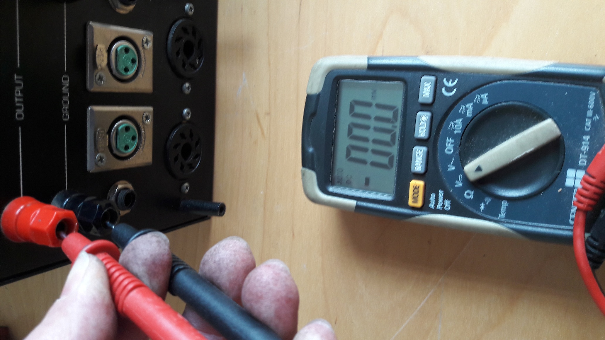

Hi Deaf Cat,
There is nothing active in the chassis that can affect the modules except a defective relay where the coil voltage could get put on a speaker output.
Have you confirmed that the supply voltages are the same but opposite polarities?
Given the age of the amplifier it could have weird problems in each channel, but I doubt it. You can run the amplifier with only one module installed. How about testing one, then sticking the other in the same place and trying it again? Also measure the unconnected speaker output to see if there is any voltage on it. There shouldn't be any at all.

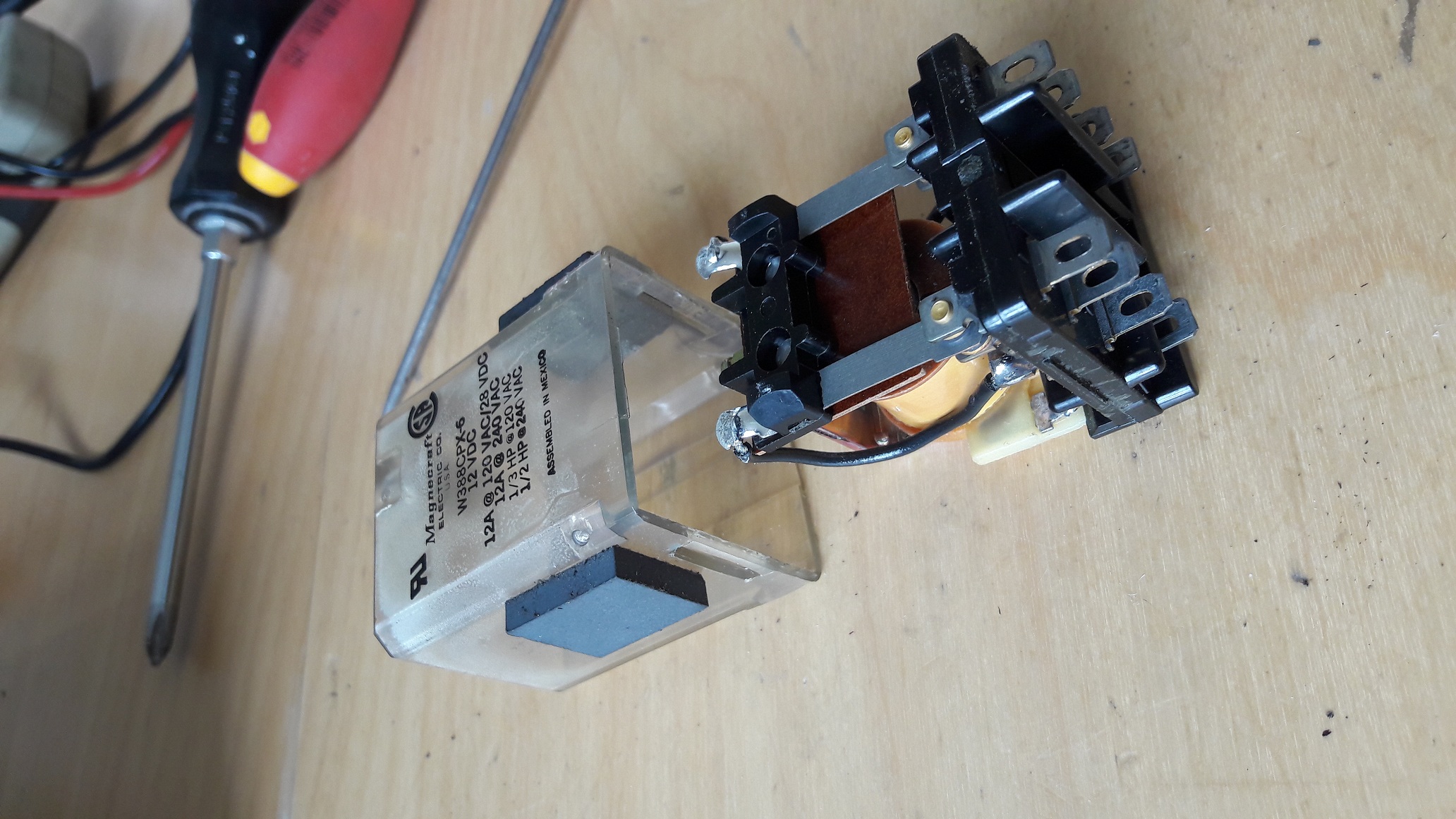

I Just pulled out the relay, and this time actually measured resistance, rather than just looking! gently pushing the actuator, the one actuator does two switches, one side switches on and off, ie. Open circuit and then closed, zero resistance. The other side just stays open circuit, even though it looks like it is closed, I used some very find wet and dry paper (dry) and gently cleaned the non conducting contacts. They now show open circuit when open and closed circuit (zero resistance) when closed.
Simple fix I thought!
Ahrrrr... this time when I powered up, the clip light for the RHS lit brightly, no music even playing yet! I then played a track, no sound from the right as normal, after a while the RHS clip light gently faded out, still no sound from the right hand speaker.
After a while I switched the 750 off and then on again, the clip light did not come on next time the 750 was switched on, still no sound on the right.
I guess the next step would be to see what has happened to the relay, if it still functions correctly after the bright clip light with nothing playing!?
And go from there?
Any comments / thoughts much appreciated 🙂

Hi Deaf Cat,
You destroyed the relay the second you sanded it. The contacts are just a coating flashed onto the base material. So, you need a new relay. After installing that, you can test it and see if you need to do any more trouble shooting.
-Chris
