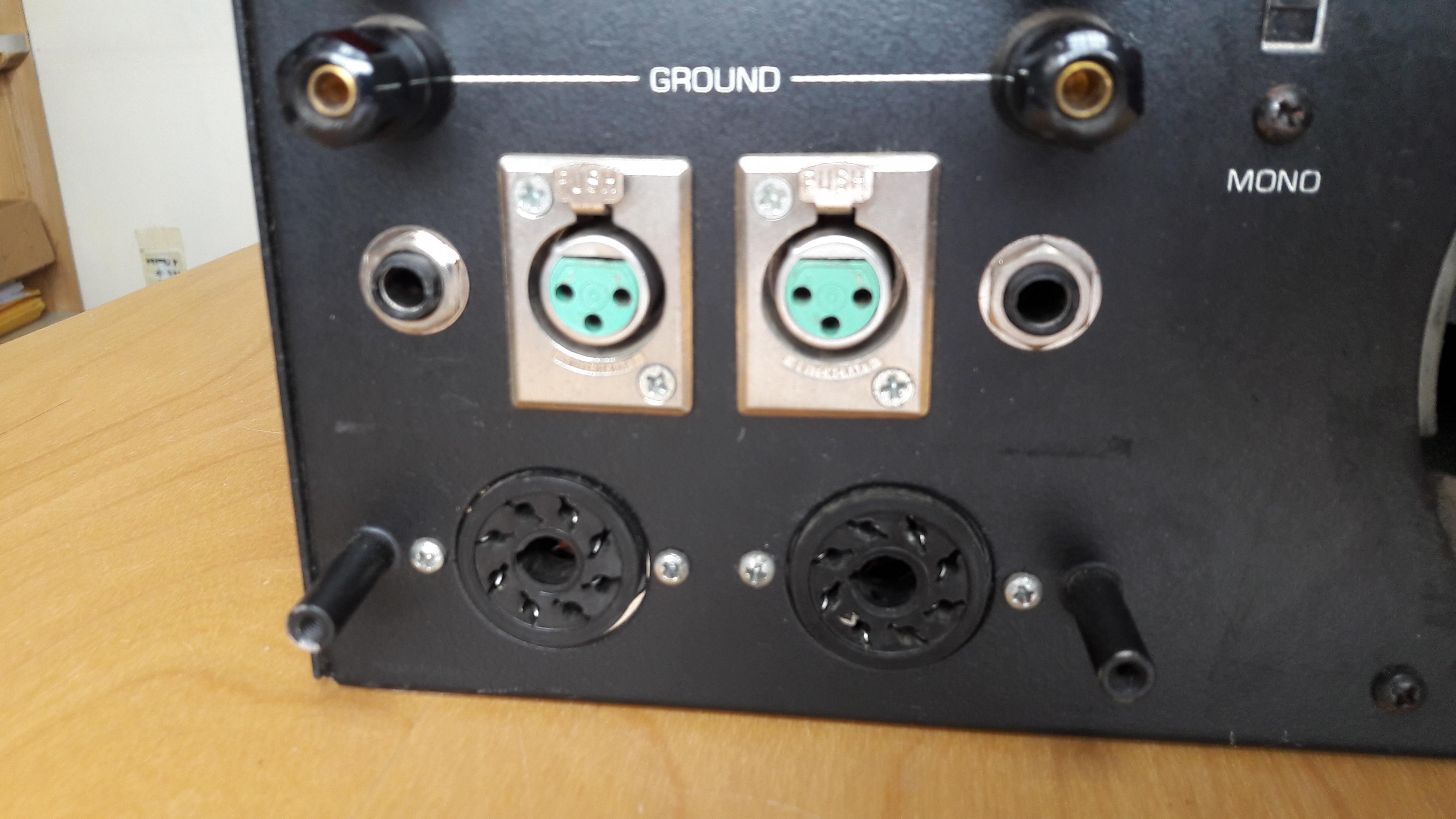

I don't quite get the transformer bit with the round shorting plugs, but guess getting the thing working will be the first step.
(No caps or plugs are present with this unit, I do have a XO that outputs balanced so at some point it would be interesting to try balanced, so long as I get it working!)

Leave the circular shorting plugs alone. They are perfectly normal. There are transformers that can plug in there as an option. You don't need them. Besides, they are PA quality, so you are further ahead the way you are. So much for balanced inputs.
All a balanced input and output are is adapters. Everything internally is single ended. So at best, a balanced signal can be just as good as the single ended if everything is perfect. There are times when you have to run a signal a long way. That is when you might use a balanced signal.

..and a pic of the balanced sockets on the back, so it is clear what is there, may be not to me but to those who know how they work.
Interesting to know that the balanced part stops as it goes in to the amp and the amp is single ended. Which I guess makes sense as it is the long cable runs that Pro set ups use the balancing for over the long distance cable runs, to keep the signal in check.

There don't seem to be any connector plugs in the rear, just 6 or 8 holes in two circles for something to plug into, still the phono in's don't relate to those silver capped plugs do they? (phono is what I shall use for the time being)

Hey Thanks for all the pointers, appreciated 🙂
The writing becomes clear once one ties it to the actual physical equipment.
Regarding the power transistors, they all look the same, well half of one type and half of another, I shall attach some pics shortly.
I found the relay, and had to undo the 4 retaining screws underneath its cct board to get the nuts off that hold the wire springy thing over the top of its' plastic case. I did try to be very careful in removing the plastic case (with the magnets glued on the side) - (I have now read up as to what they are for! Interesting!) But I did crack it slightly so I am pleased the wire over the top of the case is there to ensure it stays in place.
The relay seems to physically work fine when i squeeze the actuator, two little flaps with contactors on the end of them move between two front contacts and then two back contacts when moving the actuator. Nothing seems stuck, it actually looks reasonably clean and new compared to the rest of the stuff in the case. (Writing this, I am now thinking, I did not electrically test it! May be I should have done just to be sure!)
I assembled the amp and tested for DC offset. Left side registered around 7 (pic soon) and right started lower and very quickly diminished to Zero. I initially thought zero was good as we don't want dc, but after plugging in the speakers I am guessing that zero is not good, as there is no sound from the right, just like before.
So any suggestions or thoughts, with this update, please 🙂
