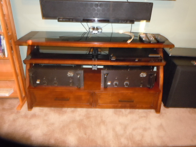

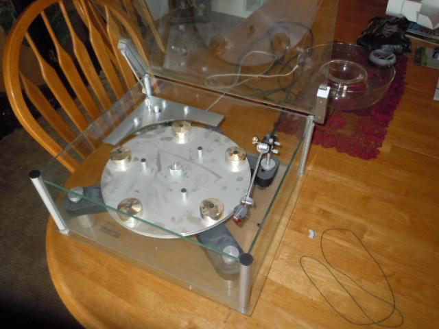

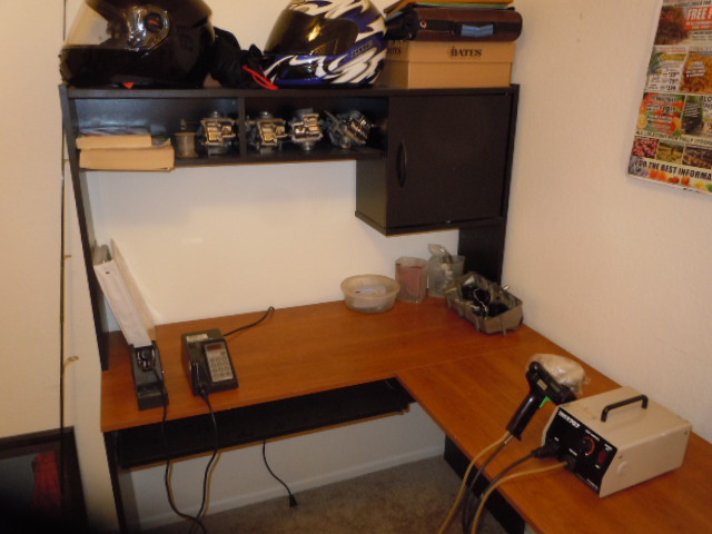

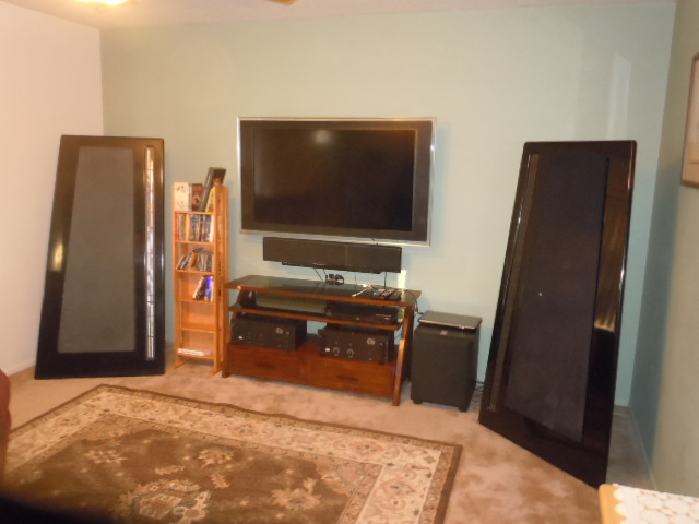

Well, here's an update. I now have two bgw 750C amps. Since I didn't have a desoldering station, I bought a hakko 707 desoldering unit. Well, I just can't use my generic $20 soldering gun so I also now have a Hakko 927 soldering station. I've been busy working on other projects and those are now done(well, one isn't totally done-but close enough). I've been looking at the different caps and can't make up my mind which ones to use(brands and quality). Maybe you can help me on this matter, and reading your post, you have(in selecting which caps to use) Also, I am switching out the LM318 opamp to a NE5534 opamp. I will be documenting the modifications in both photos and videos along with the final, completed project. I just acquired a Carver C1 preamp(for free) that I will be updating and upgrading also. As for the Carver ALS speakers(the reason I have the two BGW 750C amps), I am still looking for a replacement ribbon, to no avail. So I may have to try my hand at building a replacement ribbon. I think the speakers are going to be the biggest PITA. BTW- I also just picked up a Mitchell Skeleton turntable, all original, that I need to work on.
Here are some pictures of my recent "findings". I am hoping to have all done by the end of December.
Michael
